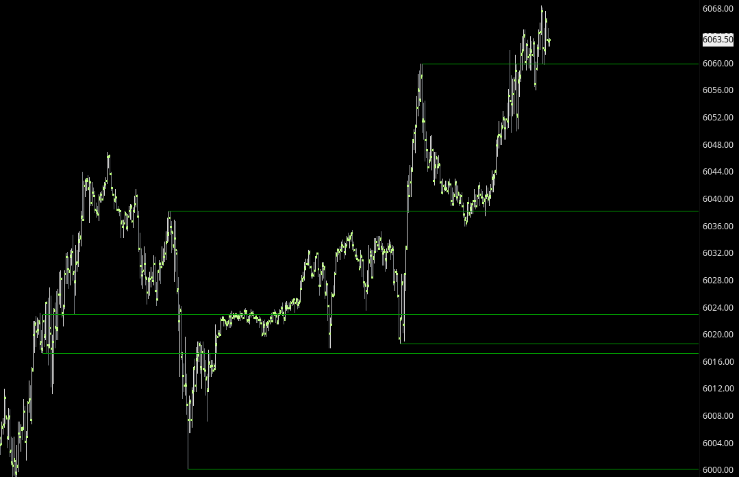

Hello Sierra,
Can you please advise which study supports drawing an isolated horizontal line (or ray) at a specific time that extends to the edge? Refer to the attached image for what I am trying to achieve. Note, the lines aren't joined or continuous and extend to the edge of the chart.
I have tested the following studies without luck:
- High/Low for Time Period
- High/Low for Time Period - Extended
- Horizontal Line at Time
Thank you
imagesierra-horizontal-line.png / V - Attached On 2024-12-02 21:52:32 UTC - Size: 25.32 KB - 207 views
[2024-12-03 15:33:10]
From your image, the lines are associated with a particular bar value. Therefore the "Horizontal Line at Time" should do what you want. What about it is not working as you want it to?
Also, using the Horizontal Ray drawing tool will give you what you want, unless there is some reason you want to use a study. Refer to the following:

I'd like to add a date variable so that the lines will be drawn at a specific time on a specific date, not just drawn from the same time every session. If this requires customizing an existing study, I'll look into this. If so, would the "Horizontal Line at Time" be the best study to customize?
And, the line drawn should be a Horizontal Ray drawn automatically by the study, not manually.
I see my original post didn't include the data variable. Sorry for this.
