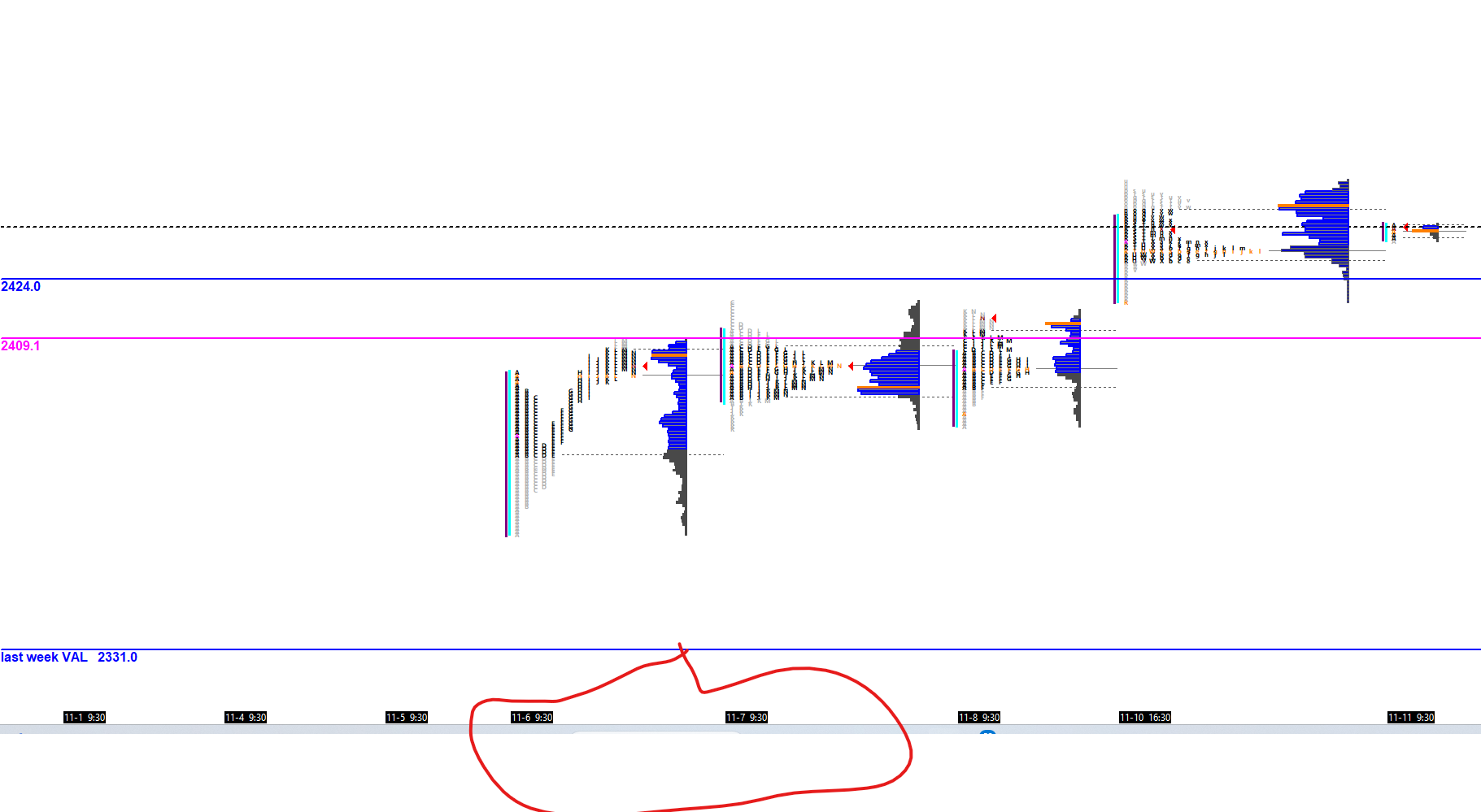

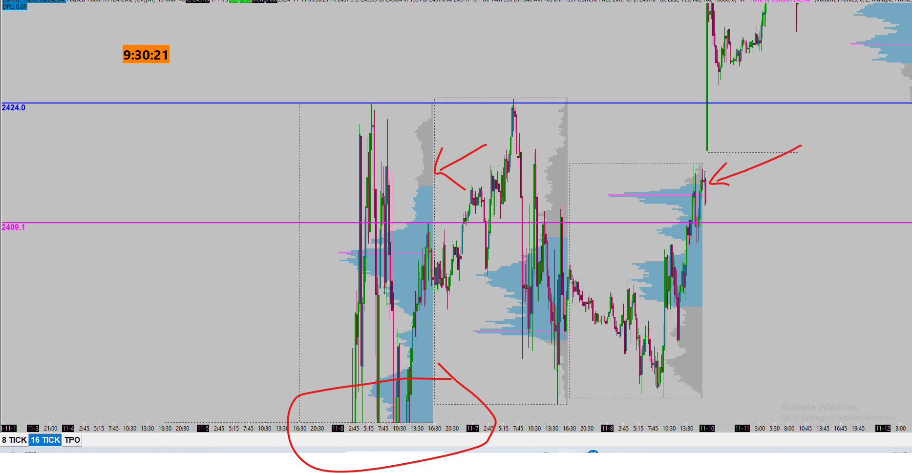

Hi Sierra,
There are several discrepancies between between my candle stick chart + daily volume profile vs my TPO chart. Firstly as you can see the blue shaded areas (70% of Volume) differs from my TPO - should they not be the same?
Not sure if this issue is caused by different session timing starts, but the prices for highs and lows do not even match up. As can be seen in the TPO chart vs the candle stick chart, on 6/11 and 7/11 price reached the 2424 level which I have drawn, but on the TPO chart it doesnt even reflect that price reached this level. Is this because price didnt spend a minimum of 30 minutes there?
Even so, there should still be volume reflected on the VP (right hand side) of the TPO chart - but it does not reflect this. Please clarify
imageCandlstick chart + Daily volume profile .png / V - Attached On 2024-11-25 14:39:02 UTC - Size: 81.93 KB - 190 views
imageTPO Chart .png / V - Attached On 2024-11-25 14:39:06 UTC - Size: 76.28 KB - 235 views

The blue shaded areas are the Value Areas on the Volume profile and on the TPO. One reason they would be different is that the Value Area is calculated differently (by default) between the TPO and the Volume Profile. Refer to the following:
Time Price Opportunity (TPO) Profile Charts: TPO Value Area
If you want the Value Area to be the same between the two, then you would need to set the TPO to use a Volume Value Area. Refer to the following:
Time Price Opportunity (TPO) Profile Charts: Value Area Highlight Based On Volume
With regards to the prices, the TPO and the Volume Profile are covering different time periods. Your Volume by Price goes from 16:30:00 to 16:29:59. We assume the TPO is not setup to display the Evening Session and this would be the reason for the difference. But regardless of the reason why, they are definitely covering different times, which will give you different values.

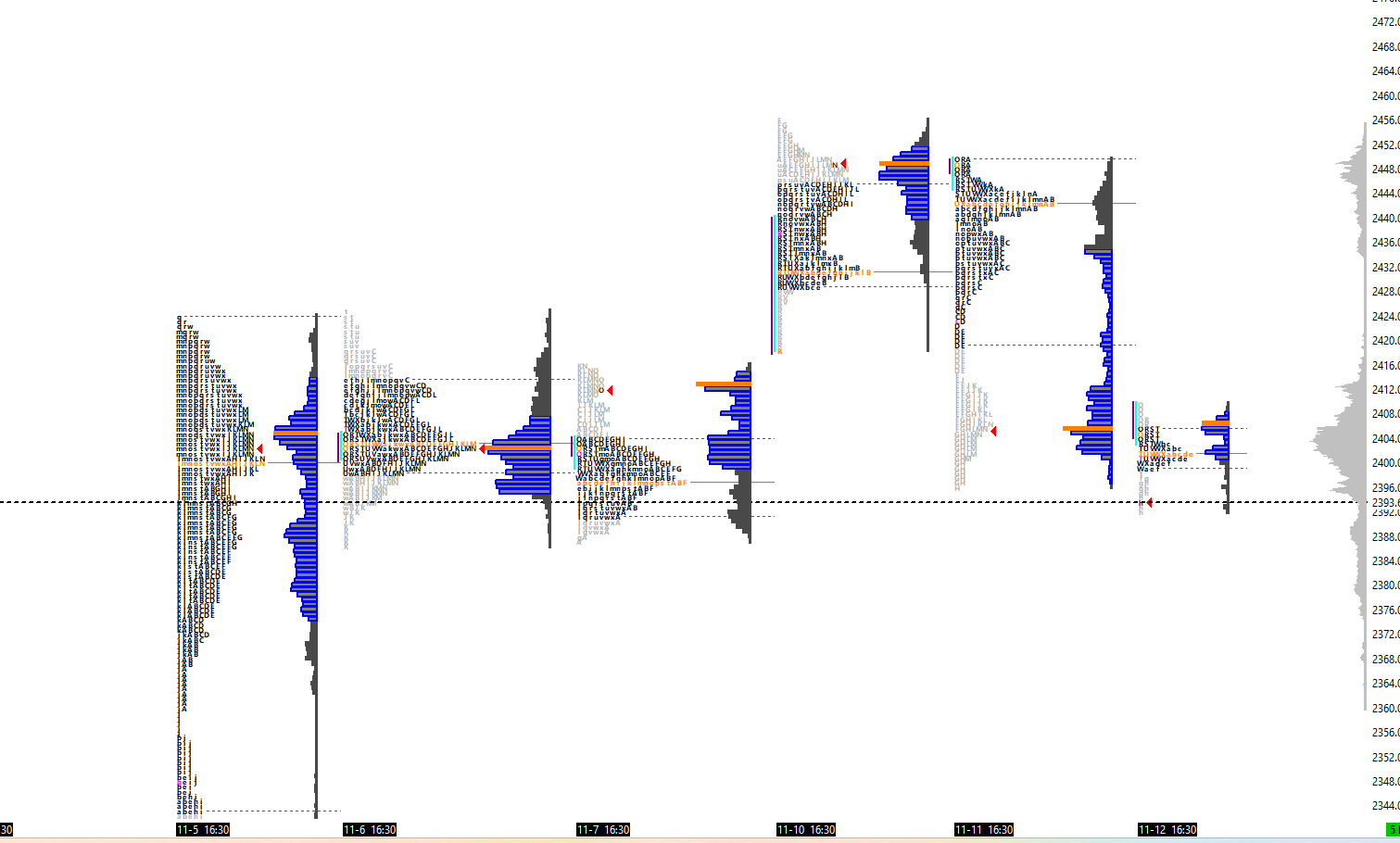

User495734 - Posts: 48
Thanks I've got that sorted and both are now aligned.
Wanted to check too though - for the TPO (on the left) and the volume value area (on the right), shouldn't the value levels and POC for both be lining up more? Is it a setting because I would have thought that both have a stronger correlation
imageScreenshot 2024-11-28 201225.png / V - Attached On 2024-11-28 12:12:37 UTC - Size: 116.64 KB - 260 views
[2024-11-29 05:20:17]
Sierra_Chart Engineering - Posts: 25440
Yes these differences are normal.
