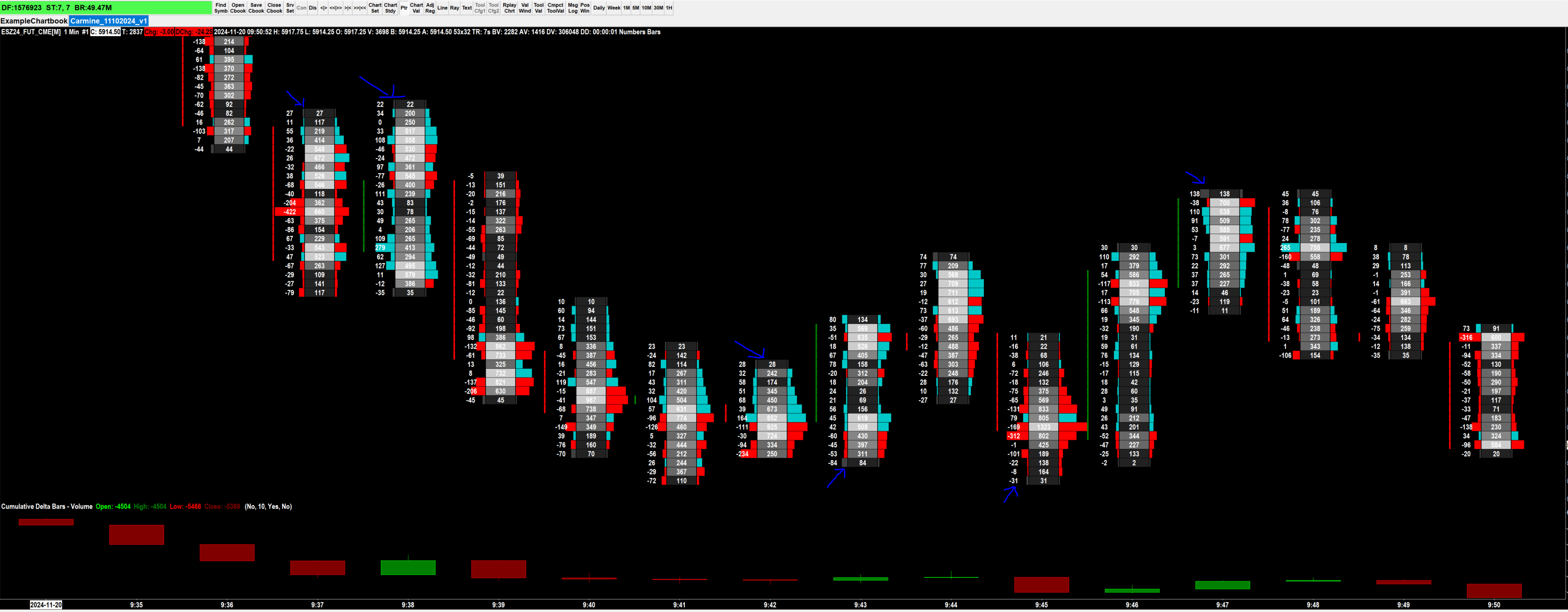

Hello, I am working to color my number bars column 1, which is coming from Delta, but in some cases it does not get colored. I am using 0.25, 0.5, 0.75 as percent color thresholds for Column 1.
I have attached screenshots for the problem. Please advise
imageColumn 1 Color Settings.PNG / V - Attached On 2024-11-19 22:53:32 UTC - Size: 102.46 KB - 193 views
imageNumber Bars.PNG / V - Attached On 2024-11-19 22:53:36 UTC - Size: 255.34 KB - 219 views
[2024-11-19 22:56:12]
You have your color for Column 1 set to be black, except for the Range 3 Up/Down colors. Therefore only those values that are greater than .75 of however you are coloring the background will get colored. We do not know what background coloring item you have chosen, so we can not give more specifics.

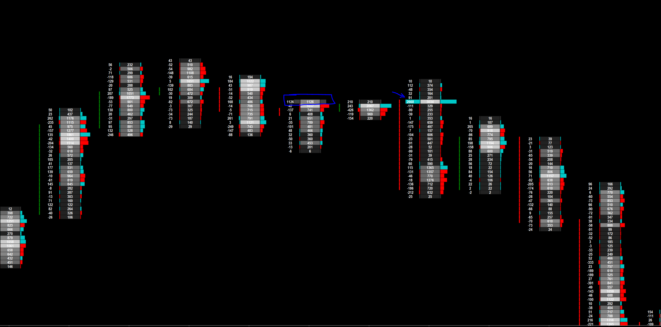

I notice that the color is gray if the delta is 100% of the volume traded. For example, if total 100 contracts were traded and all were on one side (either buy or sell), the coloring does not work. It works for all other cases. My background coloring system is based on dominant side AskVolBidVol percentage.
See attached screenshot.
imageNumber Bars_1120.PNG / V - Attached On 2024-11-20 14:53:54 UTC - Size: 502.22 KB - 205 views
[2024-11-20 17:08:08]
That is because the ratio would be comparing to a zero value, meaning there would be a zero in the denominator. Refer to the following Input for how to work around this:
Numbers Bars: Enable Bid/Ask Ratios with Zeros as Ones
Also be aware of the Input just above it if you are doing Diagonal ratios.
[2024-11-20 18:18:51]
User549180 - Posts: 3
This worked. Thank You
