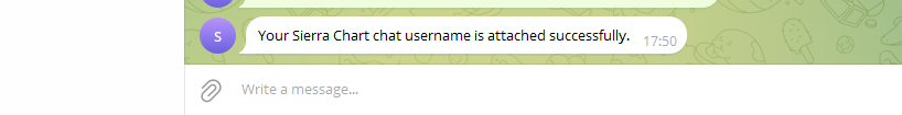

[2024-11-20 17:29:11]
User361939 - Posts: 170
I got alert on sierrachart chat, but i didn't get it to TELEGRAM. I think i set it corectly, screens at the attachment:
I attached my sierra username to chtbot.
Date Time Of Last Edit: 2024-11-20 17:35:31
imagetelegramissue.png / V - Attached On 2024-11-20 17:28:37 UTC - Size: 11.04 KB - 188 views
imagetelegramissue2.png / V - Attached On 2024-11-20 17:28:41 UTC - Size: 22.92 KB - 242 views
[2024-11-20 17:44:51]
The only thing we can recommend is to redo the connectivity to Telegram and see if that resolves it. Refer to the following:
Chat and Communications Platform: Telegram Integration
Another option is to use our web-enabled chat instead of Telegram. Refer to the following:
Chat and Communications Platform: Web-Based/Mobile Chat Application
