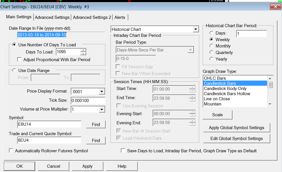

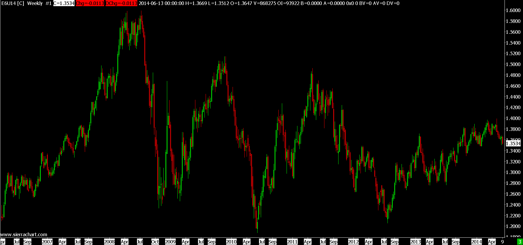

I'm trading the 6E future contract. On this contract i'm able to get history data until 16.9.2013 (see picture attached).
I would like to get historical data from 2012 how can i do it?
I wasn't able to change the date on the chart setting (see picture attached)
image2014-09-10_6e_weekly.png / V - Attached On 2014-09-10 06:25:14 UTC - Size: 44.4 KB - 490 views
image2014-09-10_chart_setting.png / V - Attached On 2014-09-10 06:25:19 UTC - Size: 79.66 KB - 504 views

Based upon what we see, re-download the data following these instructions:
https://www.sierrachart.com/index.php?page=doc/doc_ContinuousFuturesContractCharts.html#ReDownloading
The settings are correct. We do not see any problems with those.

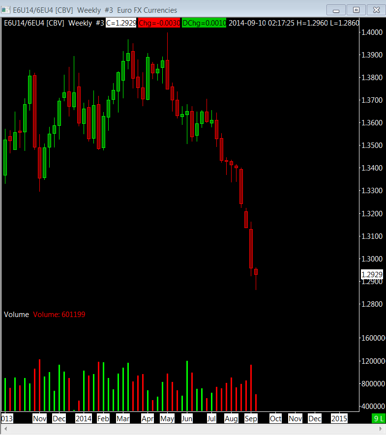

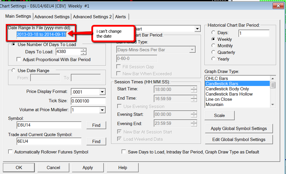

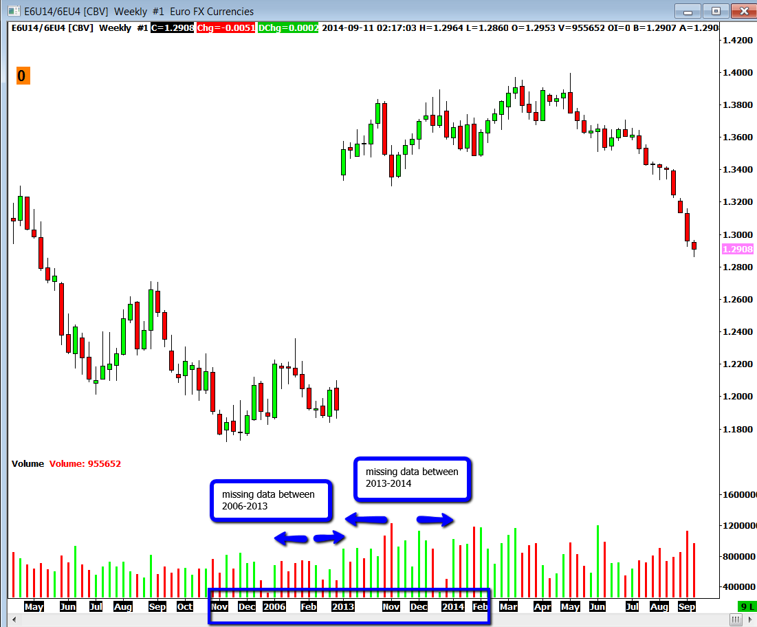

Thank you. I re-download the data following the instructions and i still have problem with the data.
The history data is until 16.9.2013 (see new picture attached). There is a gap between 16.9.2013 untill 2006!! and i can't see this data.
Once again I wasn't able to change the date on the chart setting (see new picture attached)
image2014-09-11_6e_weekly.png / V - Attached On 2014-09-11 06:24:22 UTC - Size: 70.05 KB - 530 views
image2014-09-11_chart_settings_6e.png / V - Attached On 2014-09-11 06:24:27 UTC - Size: 86.19 KB - 501 views
[2014-09-11 06:33:39]
We need to test this.
Do not worry about the Date Range, that only applies to the current contract. Not the historical contracts loaded in the chart.
[2014-09-11 18:48:05]
We think that you did not follow through the procedure to re-download the data for all of the futures contract symbols in the chart.
The chart looks proper for us:
http://www.sierrachart.com/image.php?l=141046121448.png
The easiest thing to do is to select File >> Open Historical Chart. Delete all of the E6*.dly files.
Press Cancel.
Go to the chart and select Chart >> Reload and Recalculate.
