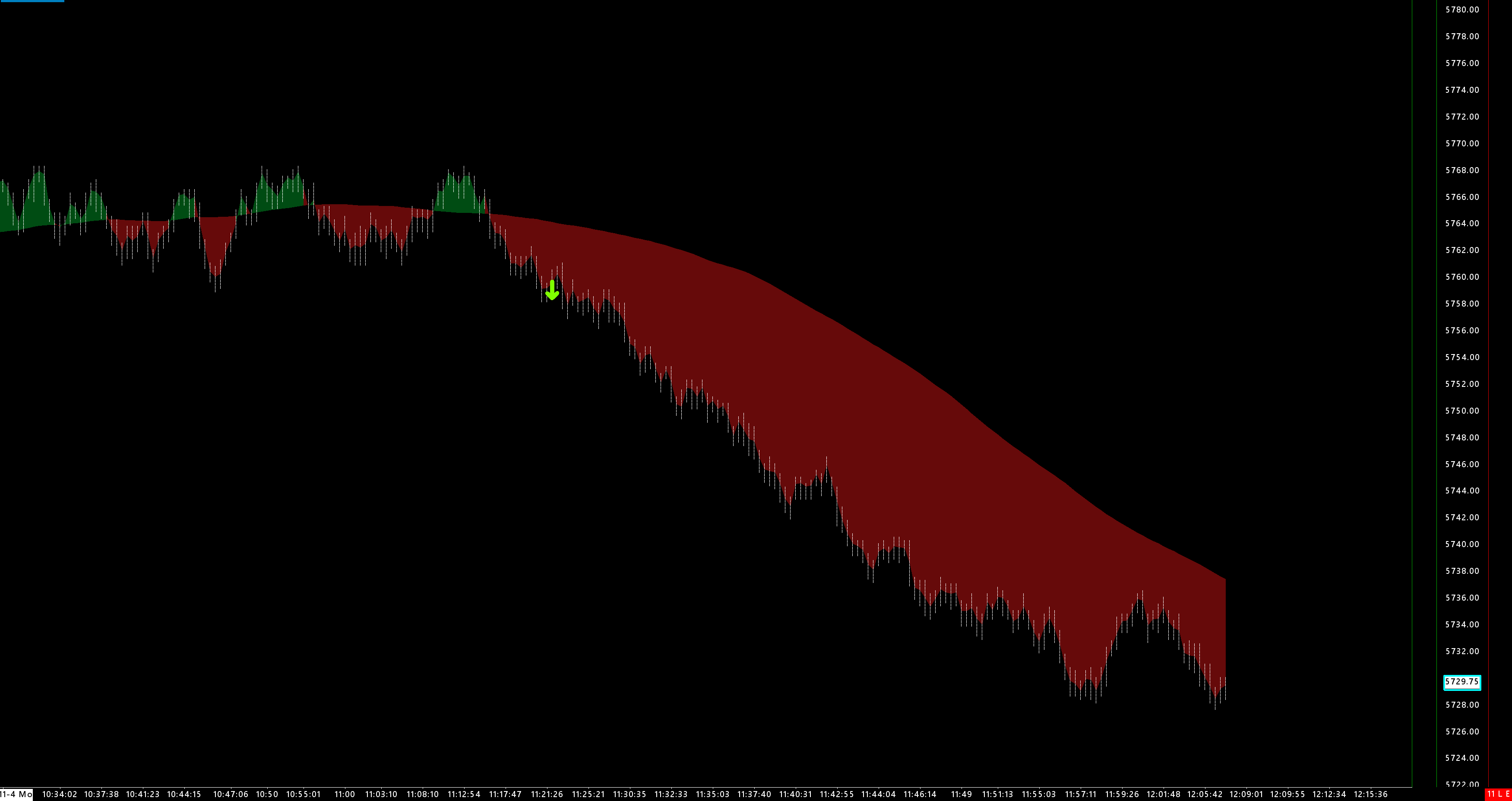

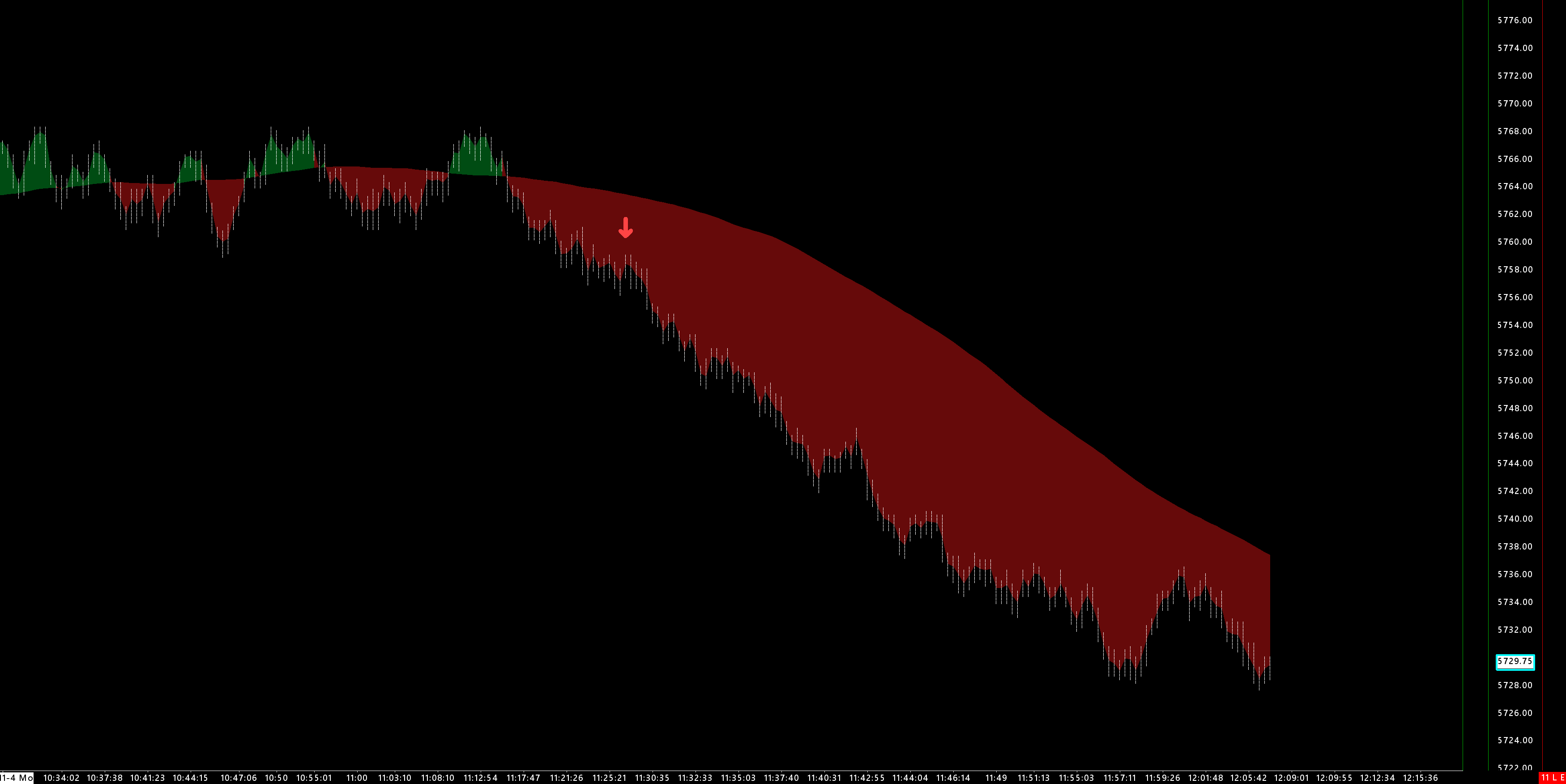

When I'm using the spreadsheet system for trading and I enter one formula in the Buy Entry it signals it properly via the arrow (even backstest wise via sim trading) but when I enter the same formula in the sell entry it always signals it anywhere from 30s to 4m later for some reason. I'm not sure what is causing this. I can provide further info/images if required.

I had the Buy Entry cleared out, and uploaded screenshots to support the visual differences (which repeat in back testing with accurate method as well). I also uploaded an image with the same formula in both the Buy and Sell entry and there are differences. Note, I am using Number Bars as my main chart at 1000 trades. I don't have any study price overlay or subgraph references studies. Its quite lean.

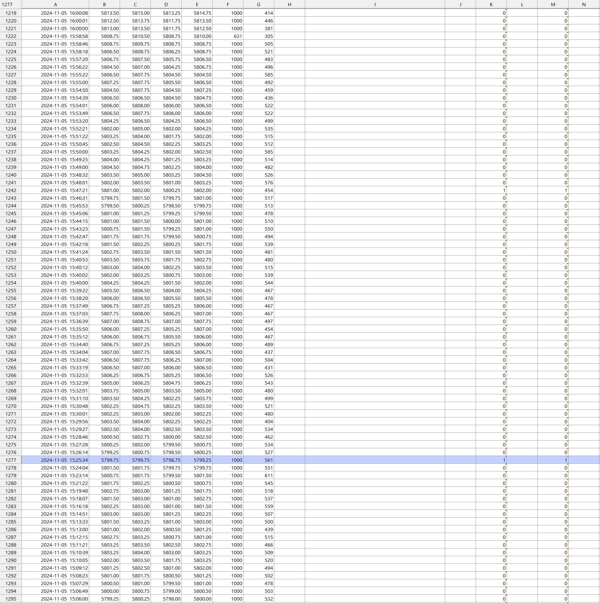

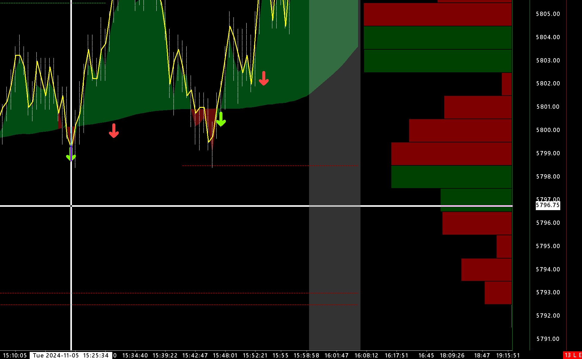

[2024-11-07 01:52:29]
arkevo - Posts: 32
Of course, please see the images attached.
11-05 at 15:25:34 the Buy Entry is correct as per the spreadsheet but the sell entry signal is drawn a few minutes later (which is what I meant by the sell entry signal drawn later.

[2024-11-07 15:22:11]
When the value in the cell is 1, then at the time of that bar (as defined in Column A) the arrow should be drawn. There is only one reason why this would not be the case and that is if you have a non-zero "Displacement" set for that subgraph in the Settings for the study. Check the displacement and set it to zero if it is not already. Refer to the following:
Chart Studies: Subgraphs Tab >> Displacement
[2024-11-07 17:11:56]
arkevo - Posts: 32
That fixed it! I'm not sure how there was a 10 in the displacement instead of 0. I must have done it and forgot. Thanks for the help, you can close this ticket now.
