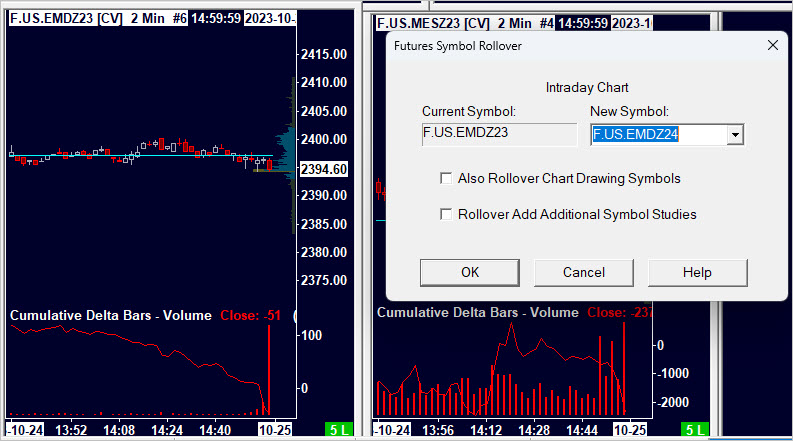

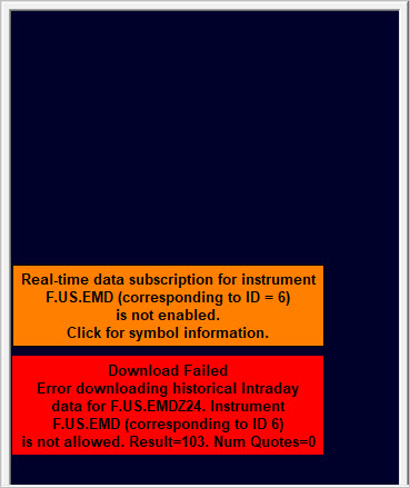

I just activated feed, and when I performed roll over, this msg showed up. 2 pictures attached.
Would you please help to troubleshoot?

I changed service to SC Data - ALL services and data started to download now.

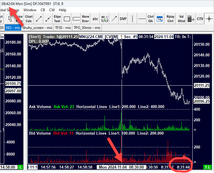

User144295 - Posts: 76
It looks like I have delayed data?
I noticed time left up is 8.41 but in chart it shows 8.31
Screen attached.
I have changed this to NO to stop 10 min delay data and switch to real time, but it did not help.
I am not sure why would I use delay data by default if I purchased real time data.
Maybe you can help me to understand. Thank you
OK I reviewed past msgs and I think I understand now.
I need to pay and activate CME exchange fee 12.5 then switch my services back to cqg webapi and it should work as real time.

Yes. You need to set Sierra Chart to use CQG:
CQG Trading Platform Service: Setup Instructions
And then you need to activate the exchange or exchanges you need here:
[2024-11-04 22:40:56]
