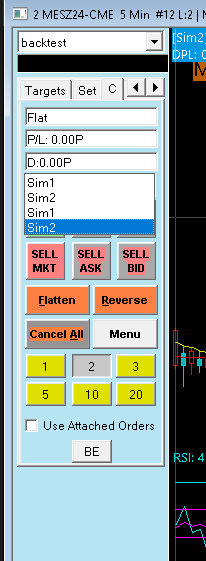

I have a 2nd instance. On this instance my SIM accounts are shown twice in the trade window.

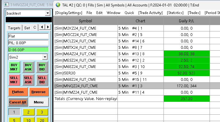

In addition to this all these positions in the trade window are shown doubled in the activity log.
So the SIM account is reckoned twice. e.g. I traded 86 points in the trade window with 1 contract and in the marked line of the Activity log it shows 172 points (doubled). Please see my attached files.

Not sure why the accounts are listed twice but that in and of itself definitely does not cause any issue.
Regarding Trade Statistics for Charts tab, the gray highlighted line is referring to the Daily Profit/Loss for chart #1. Therefore, refer to:
Help With Daily Profit/Loss Value
