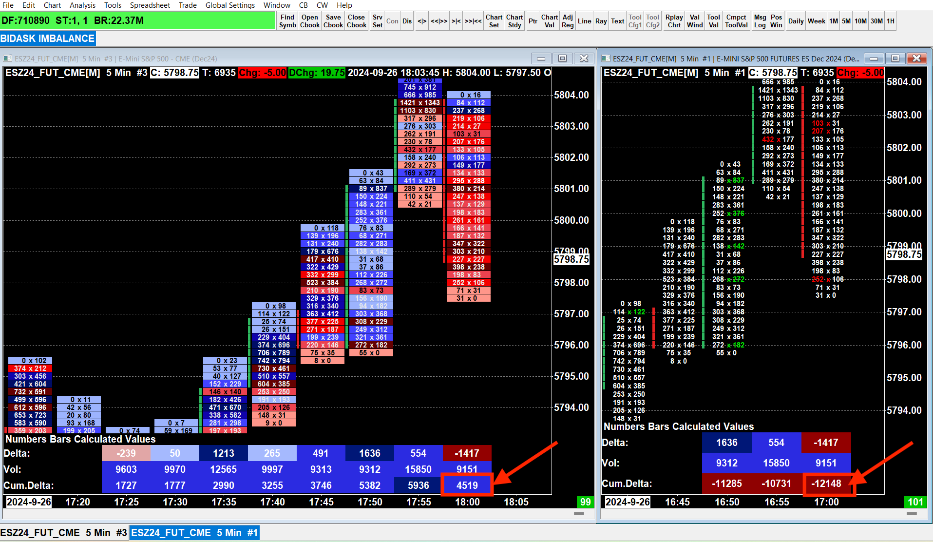

Hi there,
I have set up two different charts for the S&P500 e-mini, one being the bid x ask/delta numbers bars and the other is an imbalanc/bid x ask. I have the calculated numbers bars below to show the volume, delta, and cumulative delta on both of the charts and the cumulative delta tends to show two different values on both of the charts. I have attached an image below demonstrating this issue. Any help to solve this issue is highly appreciated.
Many thanks,
B
imageScreenshot 2024-09-26 170452.png / V - Attached On 2024-11-01 14:47:07 UTC - Size: 351.63 KB - 256 views
[2024-11-01 21:06:48]
User731023 - Posts: 167
I'm sure you have your reasons to have the charts with different times. (One hour apart)
I would also guess you may have the one chart start at 8:30 and the other at 9:30. Evening sessions are also one hour apart. (US times)
If that is the case and you do, I would make sure the "Reset Day Calculations At Both Session Start Times." are the same. (Yes or no)
PS I came back and edited this after thinking about it for a second. You can't have 2 different times come out the same
far as cumulative.

[2024-11-01 23:55:15]
Make sure the Chart Settings are the same for those two charts:
Working With Charts: Resolving Differences of Chart Bars Between Charts
