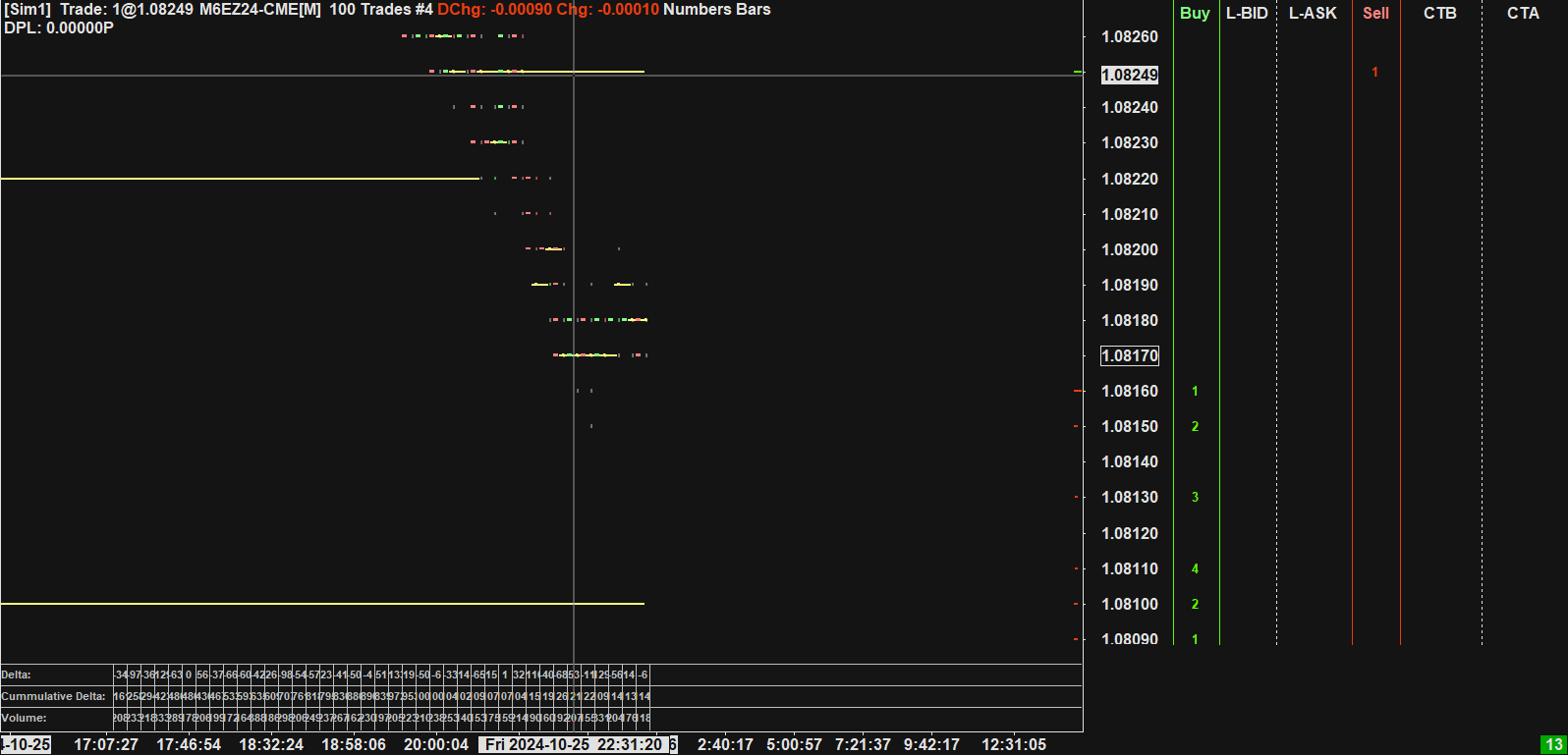

The number bars values are rightly displayed on every chart but futures charts. When i try to add the study to a futures chart the values are not visible on lower tick sizes. What can I do to fix this?

The first thing is that your chart is still too compact, you need to increase the bar spacing in order to be able to view the numbers properly. Refer to the following:
Numbers Bars: Scaling a Numbers Bars Chart
The other thing we notice is that your "Price Display Format" is set to one additional decimal place than the standard - i.e. you are showing a total of 5 decimal places, but the tick size for this instrument is .0001, therefore you only need 4 decimal places displayed. This makes us wonder if you have changed the tick size. The thing you have to keep in mind if you did is that the Numbers Bars data is still only going to show at the price levels that were actually traded.
