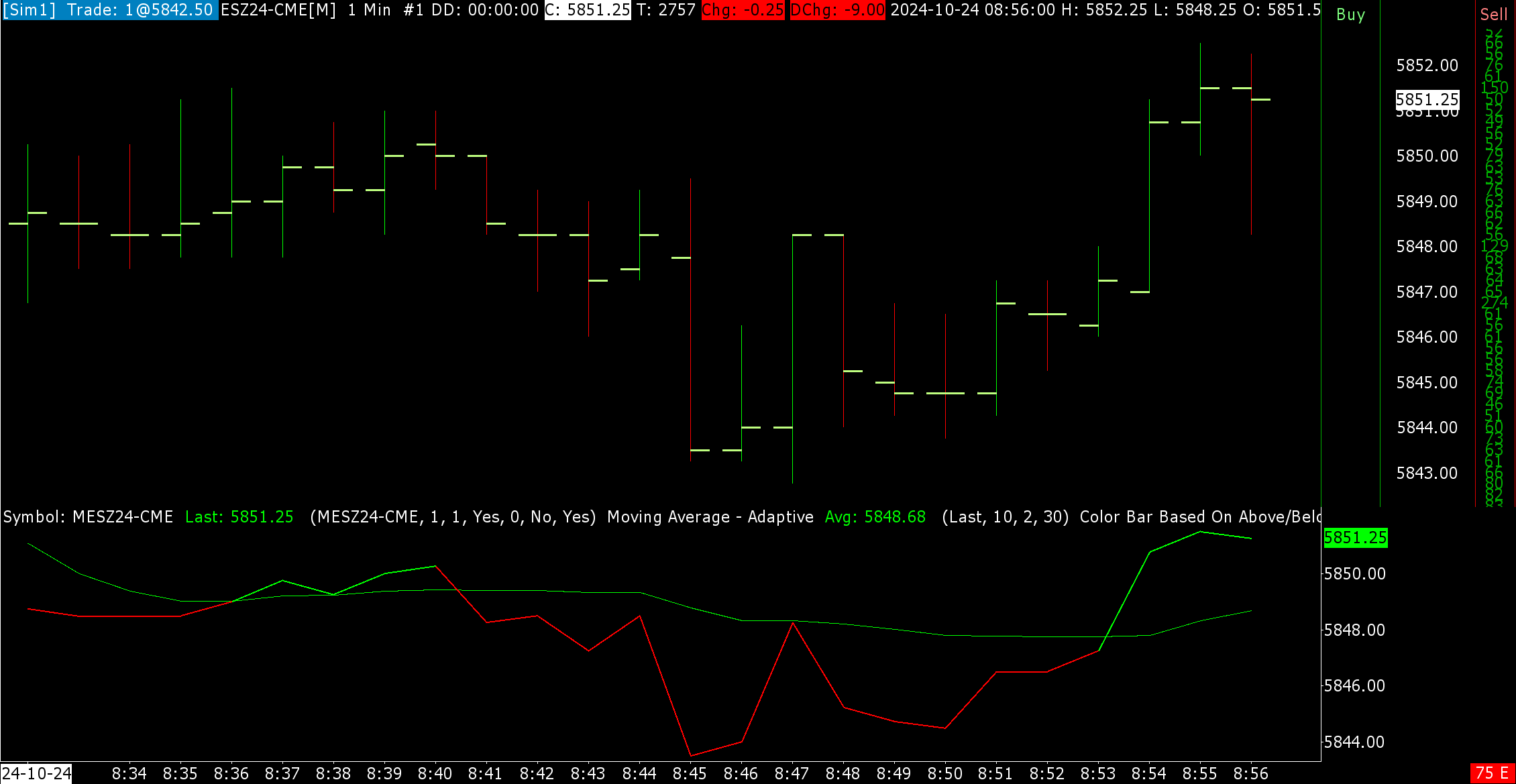

[2024-10-24 16:08:35]
We are not able to reproduce this. The attached image is what we see for the situation you describe (the yellow line is the Moving Average study that is used to determine the Above/Below.
Please get us an image of what you are seeing by following these instructions:
imageESZ24-CME[M] 1 Min #1 2024-10-24 11_06_35.333.png / V - Attached On 2024-10-24 16:08:30 UTC - Size: 84.94 KB - 368 views
