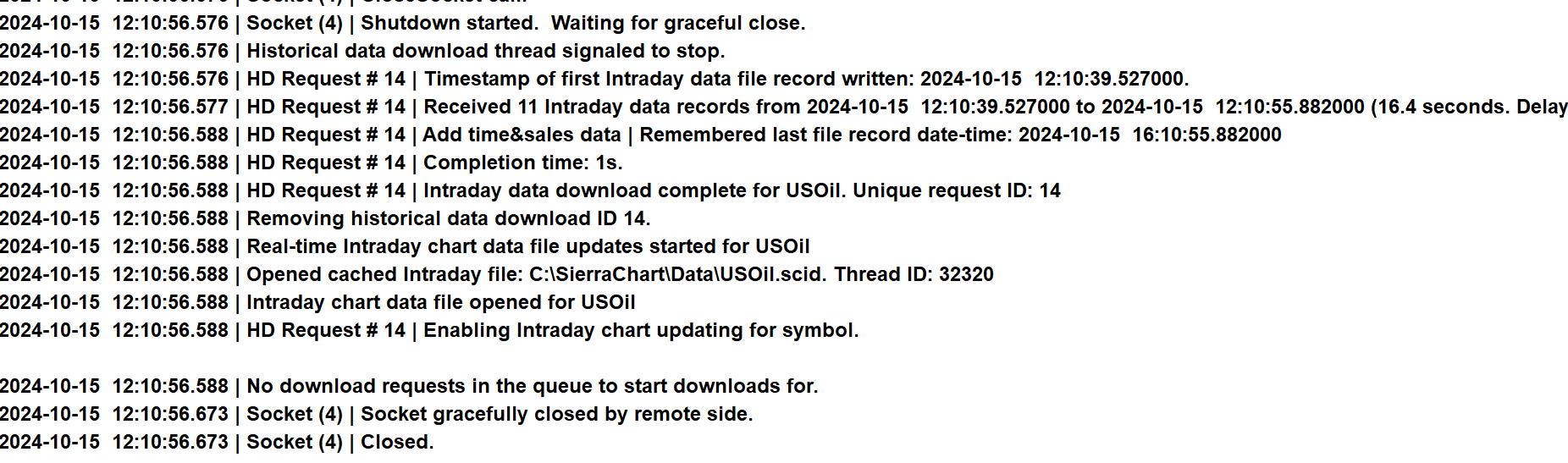

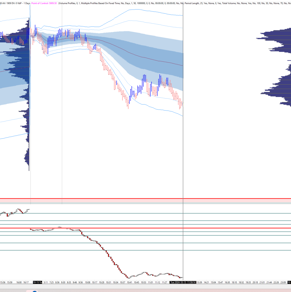

When I open the chart, it updates only to the delayed time. And then it stops updating. Opened chart at 12.10 NY time and it stays updated till 11.59 NY time. Uploaded files in attachment
imageScreenshot 2024-10-15 171332.png / V - Attached On 2024-10-15 16:14:37 UTC - Size: 93.32 KB - 176 views
imageLog.png / V - Attached On 2024-10-15 16:14:41 UTC - Size: 84.9 KB - 201 views
[2024-10-15 16:36:58]
John - SC Support - Posts: 48555
Refer to the following:
The message "Socket gracefully closed by remote side" is a normal message and does not mean anything is wrong. There is nothing in the snippet of the log that shows any particular problem.
[2024-10-15 17:53:07]
hs_07 - Posts: 15
Hi John, it is not just the intraday chart, i also have higher time frame charts. None of them are updating. Went through the list you shared and everything seems to be in order. Any chance to remote login and check the issue?

2024-10-15 14:26:21.302 | Added historical Intraday data request for AAPL-NQTV to the queue.
2024-10-15 14:26:21.302 | Intraday data recording state for symbol AAPL-NQTV is set to download 'Pending'.
2024-10-15 14:26:21.302 | Triggering next historical data download in queue.
2024-10-15 14:26:21.320 | Mapping SPY to SPY. Service code: us_equities_utp_cta_exchange.data
2024-10-15 14:26:21.320 | Delayed Data Feed | Starting real-time market data updates for: SPY (SPY). ID: 8 Service code: us_equities_utp_cta_exchange.data
2024-10-15 14:26:21.333 | Delayed Data Feed | Connecting to the server ds31.sierracharts.com. Port 10043
2024-10-15 14:26:21.334 | DTC Client socket (3) | Creating socket.
2024-10-15 14:26:21.334 | DTC Client socket (3) | New receive buffer size: 0
2024-10-15 14:26:21.334 | DTC Client socket (3) | Connecting to IP: 69.39.70.247.
2024-10-15 14:26:21.348 | Delayed Data Feed | Requesting security definition data for: SPY (SPY). ID: 8
2024-10-15 14:26:21.348 | Added historical Intraday data request for SPY to the queue.
2024-10-15 14:26:21.348 | Intraday data recording state for symbol SPY is set to download 'Pending'.
2024-10-15 14:26:21.348 | Triggering next historical data download in queue.
2024-10-15 14:26:21.392 | Delayed Data Feed | Network connection to server complete.
2024-10-15 14:26:21.392 | Delayed Data Feed | Starting socket receive thread.
2024-10-15 14:26:21.392 | Delayed Data Feed | Sending encoding request to server: Binary VLS. Compression: standard
2024-10-15 14:26:21.451 | Delayed Data Feed | Network connection to server complete.
2024-10-15 14:26:21.451 | Delayed Data Feed | Starting socket receive thread.
2024-10-15 14:26:21.451 | Delayed Data Feed | Sending encoding request to server: Binary VLS. Compression: standard
2024-10-15 14:26:21.534 | Delayed Data Feed | Setting DTC encoding to Binary VLS
2024-10-15 14:26:21.534 | Delayed Data Feed | Sending logon request message.
2024-10-15 14:26:21.593 | Delayed Data Feed | Setting DTC encoding to Binary VLS
2024-10-15 14:26:21.593 | Delayed Data Feed | Sending logon request message.
2024-10-15 14:26:21.790 | SC Data with Depth | Received logon response.
2024-10-15 14:26:21.790 | SC Data with Depth | Server Name: SC Realtime Server.
2024-10-15 14:26:21.790 | SC Data with Depth | Server protocol version: 8. Client protocol version: 8
2024-10-15 14:26:21.790 | SC Data with Depth | Successfully connected.
2024-10-15 14:26:21.790 | SC Data with Depth | Trading is not supported.
2024-10-15 14:26:21.790 | SC Data with Depth | MarketDepthIsSupported: 1
2024-10-15 14:26:21.790 | SC Data with Depth | Restarting real-time data updates for symbol: EURUSD
2024-10-15 14:26:21.790 | SC Data with Depth | Restarting real-time data updates for symbol: SPX500
2024-10-15 14:26:21.790 | SC Data with Depth | Restarting real-time data updates for symbol: US30
2024-10-15 14:26:21.790 | SC Data with Depth | Restarting real-time data updates for symbol: USOil
2024-10-15 14:26:21.790 | SC Data with Depth | Restarting real-time data updates for symbol: XAUUSD
2024-10-15 14:26:21.978 | SC Data with Depth | Setting external service identifier for symbol EURUSD to 18
2024-10-15 14:26:21.978 | SC Data with Depth | Received security definition for symbol EURUSD
2024-10-15 14:26:21.978 | SC Data with Depth | Setting external service identifier for symbol SPX500 to 55
2024-10-15 14:26:21.978 | SC Data with Depth | Received security definition for symbol SPX500
2024-10-15 14:26:21.979 | SC Data with Depth | Setting external service identifier for symbol US30 to 58
2024-10-15 14:26:21.979 | SC Data with Depth | Received security definition for symbol US30
2024-10-15 14:26:21.979 | SC Data with Depth | Setting external service identifier for symbol USOil to 60
2024-10-15 14:26:21.979 | SC Data with Depth | Received security definition for symbol USOil
2024-10-15 14:26:21.979 | SC Data with Depth | Setting external service identifier for symbol XAUUSD to 62
2024-10-15 14:26:21.979 | SC Data with Depth | Received security definition for symbol XAUUSD
2024-10-15 14:26:22.181 | Delayed Data Feed | Received logon response.
2024-10-15 14:26:22.181 | Delayed Data Feed | Server Name: SC Realtime Server.
2024-10-15 14:26:22.181 | Delayed Data Feed | Server protocol version: 8. Client protocol version: 8
2024-10-15 14:26:22.181 | Delayed Data Feed | Successfully connected.
2024-10-15 14:26:22.181 | Delayed Data Feed | Trading is not supported.
2024-10-15 14:26:22.181 | Delayed Data Feed | MarketDepthIsSupported: 1
2024-10-15 14:26:22.181 | Delayed Data Feed | Restarting real-time data updates for symbol: AAPL-NQTV -> AAPL-NQTV
2024-10-15 14:26:22.245 | Delayed Data Feed | Received logon response.
2024-10-15 14:26:22.245 | Delayed Data Feed | Server Name: SC Realtime Server.
2024-10-15 14:26:22.245 | Delayed Data Feed | Server protocol version: 8. Client protocol version: 8
2024-10-15 14:26:22.245 | Delayed Data Feed | Successfully connected.
2024-10-15 14:26:22.245 | Delayed Data Feed | Trading is not supported.
2024-10-15 14:26:22.245 | Delayed Data Feed | MarketDepthIsSupported: 1
2024-10-15 14:26:22.245 | Delayed Data Feed | Restarting real-time data updates for symbol: SPY -> SPY
2024-10-15 14:26:22.372 | Delayed Data Feed | Setting external service identifier for symbol AAPL-NQTV to 21
2024-10-15 14:26:22.372 | Delayed Data Feed | Received security definition for symbol AAPL-NQTV
2024-10-15 14:26:22.429 | Delayed Data Feed | Setting external service identifier for symbol SPY to 130
2024-10-15 14:26:22.429 | Delayed Data Feed | Received security definition for symbol SPY
2024-10-15 14:26:26.766 | HD Request # 1 | Downloading Intraday chart data for EURUSD to the file EURUSD.scid. Service: fxcm
2024-10-15 14:26:26.767 | HD Request # 1 | Download start date-time: 2024-10-15 13:53:29.000000. File last date-time: 2024-10-15 13:53:29.000000
2024-10-15 14:26:26.767 | HD Request # 1 | Using server: ds12.sierracharts.com port 10150
2024-10-15 14:26:26.767 | Socket (4) | Creating socket.
2024-10-15 14:26:26.767 | Socket (4) | New receive buffer size: 0
2024-10-15 14:26:26.767 | Socket (4) | Connecting to IP: 69.39.70.241.
2024-10-15 14:26:26.967 | HD Request # 1 | Setting DTC encoding to Binary VLS
2024-10-15 14:26:26.967 | HD Request # 1 | Sending historical data logon request message.
2024-10-15 14:26:27.538 | HD Request # 1 | Requesting Intraday data. Start date-time: 2024-10-15 13:53:29. Record interval: 1. Symbol: EURUSD
2024-10-15 14:26:27.631 | HD Request # 1 | Decompressing data.
2024-10-15 14:26:27.826 | HD Request # 1 | Receiving Intraday data for EURUSD starting at 2024-10-15 13:53:29.220000
2024-10-15 14:26:27.828 | Socket (4) | CloseSocket call.
2024-10-15 14:26:27.829 | Socket (4) | Shutdown started. Waiting for graceful close.
2024-10-15 14:26:27.830 | Historical data download thread signaled to stop.
2024-10-15 14:26:27.830 | HD Request # 1 | Timestamp of first Intraday data file record written: 2024-10-15 13:53:29.220000.
2024-10-15 14:26:27.830 | HD Request # 1 | Received 1136 Intraday data records from 2024-10-15 13:53:29.220000 to 2024-10-15 14:26:25.153000 (32.9 minutes. Delay: 2.7 seconds) and wrote 1136 records for EURUSD
2024-10-15 14:26:27.839 | HD Request # 1 | Add time&sales data | Remembered last file record date-time: 2024-10-15 18:26:25.153000
2024-10-15 14:26:27.839 | HD Request # 1 | Completion time: 1s.
2024-10-15 14:26:27.839 | HD Request # 1 | Intraday data download complete for EURUSD. Unique request ID: 1
2024-10-15 14:26:27.839 | Removing historical data download ID 1.
2024-10-15 14:26:27.839 | Real-time Intraday chart data file updates started for EURUSD
2024-10-15 14:26:27.839 | Opened cached Intraday file: C:\SierraChart\Data\EURUSD.scid. Thread ID: 1692
2024-10-15 14:26:27.839 | Intraday chart data file opened for EURUSD
2024-10-15 14:26:27.839 | HD Request # 1 | Enabling Intraday chart updating for symbol.
2024-10-15 14:26:27.839 | Triggering next historical data download in queue.
2024-10-15 14:26:27.839 | HD Request # 2 | Downloading Intraday chart data for XAUUSD to the file XAUUSD.scid. Service: fxcm
2024-10-15 14:26:27.839 | HD Request # 2 | Download start date-time: 2024-10-15 13:53:29.000000. File last date-time: 2024-10-15 13:53:29.000000
2024-10-15 14:26:27.839 | HD Request # 2 | Using server: ds4.sierracharts.com port 10149
2024-10-15 14:26:27.848 | Socket (5) | Creating socket.
2024-10-15 14:26:27.848 | Socket (5) | New receive buffer size: 0
2024-10-15 14:26:27.848 | Socket (5) | Connecting to IP: 67.214.125.7.
2024-10-15 14:26:27.921 | Socket (4) | Socket gracefully closed by remote side.
2024-10-15 14:26:27.921 | Socket (4) | Closed.
2024-10-15 14:26:28.052 | HD Request # 2 | Setting DTC encoding to Binary VLS
2024-10-15 14:26:28.052 | HD Request # 2 | Sending historical data logon request message.
2024-10-15 14:26:28.625 | HD Request # 2 | Requesting Intraday data. Start date-time: 2024-10-15 13:53:29. Record interval: 1. Symbol: XAUUSD
2024-10-15 14:26:28.721 | HD Request # 2 | Decompressing data.
2024-10-15 14:26:29.029 | HD Request # 2 | Receiving Intraday data for XAUUSD starting at 2024-10-15 13:53:29.221000
2024-10-15 14:26:29.032 | Socket (5) | CloseSocket call.
2024-10-15 14:26:29.032 | Socket (5) | Shutdown started. Waiting for graceful close.
2024-10-15 14:26:29.033 | Historical data download thread signaled to stop.
2024-10-15 14:26:29.033 | HD Request # 2 | Timestamp of first Intraday data file record written: 2024-10-15 13:53:29.221000.
2024-10-15 14:26:29.033 | HD Request # 2 | Received 1304 Intraday data records from 2024-10-15 13:53:29.221000 to 2024-10-15 14:26:28.151000 (33.0 minutes. Delay: 0.9 seconds) and wrote 1304 records for XAUUSD
2024-10-15 14:26:29.042 | HD Request # 2 | Add time&sales data | Remembered last file record date-time: 2024-10-15 18:26:28.151000
2024-10-15 14:26:29.042 | HD Request # 2 | Completion time: 2s.
2024-10-15 14:26:29.042 | HD Request # 2 | Intraday data download complete for XAUUSD. Unique request ID: 2
2024-10-15 14:26:29.042 | Removing historical data download ID 2.
2024-10-15 14:26:29.042 | Real-time Intraday chart data file updates started for XAUUSD
2024-10-15 14:26:29.042 | Opened cached Intraday file: C:\SierraChart\Data\XAUUSD.scid. Thread ID: 1692
2024-10-15 14:26:29.042 | Intraday chart data file opened for XAUUSD
2024-10-15 14:26:29.042 | HD Request # 2 | Enabling Intraday chart updating for symbol.
2024-10-15 14:26:29.042 | Triggering next historical data download in queue.
2024-10-15 14:26:29.042 | HD Request # 3 | Downloading Intraday chart data for ESZ24-CME to the file ESZ24-CME.scid. Service: cme
2024-10-15 14:26:29.042 | HD Request # 3 | Download start date-time: 2024-10-15 13:34:34.000000. File last date-time: 2024-10-15 13:34:34.741000
2024-10-15 14:26:29.042 | HD Request # 3 | Using server: ds28.sierracharts.com port 10150
2024-10-15 14:26:29.049 | Socket (4) | Creating socket.
2024-10-15 14:26:29.049 | Socket (4) | New receive buffer size: 0
2024-10-15 14:26:29.049 | Socket (4) | Connecting to IP: 67.214.125.5.
2024-10-15 14:26:29.128 | Socket (5) | Socket gracefully closed by remote side.
2024-10-15 14:26:29.128 | Socket (5) | Closed.
2024-10-15 14:26:29.257 | HD Request # 3 | Setting DTC encoding to Binary VLS
2024-10-15 14:26:29.257 | HD Request # 3 | Sending historical data logon request message.
2024-10-15 14:26:29.834 | HD Request # 3 | Requesting Intraday data. Start date-time: 2024-10-15 13:34:34. Record interval: 1. Symbol: ESZ24
2024-10-15 14:26:29.932 | HD Request # 3 | Decompressing data.
2024-10-15 14:26:30.049 | HD Request # 3 | Receiving Intraday data for ESZ24-CME starting at 2024-10-15 13:34:34.741000
2024-10-15 14:26:30.199 | Socket (4) | CloseSocket call.
2024-10-15 14:26:30.199 | Socket (4) | Shutdown started. Waiting for graceful close.
2024-10-15 14:26:30.200 | Historical data download thread signaled to stop.
2024-10-15 14:26:30.200 | HD Request # 3 | Timestamp of first Intraday data file record written: 2024-10-15 13:34:34.741000.
2024-10-15 14:26:30.200 | HD Request # 3 | Received 2077 Intraday data records from 2024-10-15 13:34:34.741000 to 2024-10-15 14:16:28.409000 (41.9 minutes. Delay: 10.0 minutes) and wrote 2077 records for ESZ24-CME
2024-10-15 14:26:30.207 | HD Request # 3 | Add time&sales data | Remembered last file record date-time: 2024-10-15 18:16:28.409000
2024-10-15 14:26:30.207 | HD Request # 3 | Completion time: 1s.
2024-10-15 14:26:30.207 | HD Request # 3 | Intraday data download complete for ESZ24-CME. Unique request ID: 3
2024-10-15 14:26:30.207 | Removing historical data download ID 3.
2024-10-15 14:26:30.207 | Real-time Intraday chart data file updates started for ESZ24-CME
2024-10-15 14:26:30.207 | Opened cached Intraday file: C:\SierraChart\Data\ESZ24-CME.scid. Thread ID: 1692
2024-10-15 14:26:30.207 | Intraday chart data file opened for ESZ24-CME
2024-10-15 14:26:30.207 | HD Request # 3 | Enabling Intraday chart updating for symbol.
2024-10-15 14:26:30.207 | Triggering next historical data download in queue.
2024-10-15 14:26:30.207 | HD Request # 4 | Downloading Intraday chart data for US30 to the file US30.scid. Service: fxcm
2024-10-15 14:26:30.207 | HD Request # 4 | Download start date-time: 2024-10-15 13:53:29.000000. File last date-time: 2024-10-15 13:53:29.000000
2024-10-15 14:26:30.208 | HD Request # 4 | Using server: ds12.sierracharts.com port 10149
2024-10-15 14:26:30.208 | Socket (5) | Creating socket.
2024-10-15 14:26:30.208 | Socket (5) | New receive buffer size: 0
2024-10-15 14:26:30.208 | Socket (5) | Connecting to IP: 69.39.70.241.
2024-10-15 14:26:30.297 | Socket (4) | Socket gracefully closed by remote side.
2024-10-15 14:26:30.297 | Socket (4) | Closed.
2024-10-15 14:26:30.420 | HD Request # 4 | Setting DTC encoding to Binary VLS
2024-10-15 14:26:30.420 | HD Request # 4 | Sending historical data logon request message.
2024-10-15 14:26:30.997 | HD Request # 4 | Requesting Intraday data. Start date-time: 2024-10-15 13:53:29. Record interval: 1. Symbol: US30
2024-10-15 14:26:31.098 | HD Request # 4 | Decompressing data.
2024-10-15 14:26:31.407 | HD Request # 4 | Receiving Intraday data for US30 starting at 2024-10-15 13:53:29.287000
2024-10-15 14:26:31.408 | Socket (5) | CloseSocket call.
2024-10-15 14:26:31.408 | Socket (5) | Shutdown started. Waiting for graceful close.
2024-10-15 14:26:31.408 | Historical data download thread signaled to stop.
2024-10-15 14:26:31.408 | HD Request # 4 | Timestamp of first Intraday data file record written: 2024-10-15 13:53:29.287000.
2024-10-15 14:26:31.408 | HD Request # 4 | Received 1718 Intraday data records from 2024-10-15 13:53:29.287000 to 2024-10-15 14:26:27.662000 (33.0 minutes. Delay: 3.7 seconds) and wrote 1718 records for US30
2024-10-15 14:26:31.413 | HD Request # 4 | Add time&sales data | Remembered last file record date-time: 2024-10-15 18:26:27.662000
2024-10-15 14:26:31.413 | Added 2 Time and Sales records to Intraday data file for US30 after download.
2024-10-15 14:26:31.413 | HD Request # 4 | Completion time: 1s.
2024-10-15 14:26:31.413 | HD Request # 4 | Intraday data download complete for US30. Unique request ID: 4
2024-10-15 14:26:31.413 | Removing historical data download ID 4.
2024-10-15 14:26:31.413 | Real-time Intraday chart data file updates started for US30
2024-10-15 14:26:31.418 | Opened cached Intraday file: C:\SierraChart\Data\US30.scid. Thread ID: 1692
2024-10-15 14:26:31.418 | Intraday chart data file opened for US30
2024-10-15 14:26:31.418 | HD Request # 4 | Enabling Intraday chart updating for symbol.
2024-10-15 14:26:31.418 | Triggering next historical data download in queue.
2024-10-15 14:26:31.418 | HD Request # 5 | Downloading Intraday chart data for USOil to the file USOil.scid. Service: fxcm
2024-10-15 14:26:31.418 | HD Request # 5 | Download start date-time: 2024-10-15 13:53:26.000000. File last date-time: 2024-10-15 13:53:26.000000
2024-10-15 14:26:31.419 | HD Request # 5 | Using server: ds4.sierracharts.com port 10150
2024-10-15 14:26:31.419 | Socket (4) | Creating socket.
2024-10-15 14:26:31.419 | Socket (4) | New receive buffer size: 0
2024-10-15 14:26:31.419 | Socket (4) | Connecting to IP: 67.214.125.7.
2024-10-15 14:26:31.504 | Socket (5) | Socket gracefully closed by remote side.
2024-10-15 14:26:31.504 | Socket (5) | Closed.
2024-10-15 14:26:31.626 | HD Request # 5 | Setting DTC encoding to Binary VLS
2024-10-15 14:26:31.626 | HD Request # 5 | Sending historical data logon request message.
2024-10-15 14:26:32.201 | HD Request # 5 | Requesting Intraday data. Start date-time: 2024-10-15 13:53:26. Record interval: 1. Symbol: USOil
2024-10-15 14:26:32.301 | HD Request # 5 | Decompressing data.
2024-10-15 14:26:32.508 | HD Request # 5 | Receiving Intraday data for USOil starting at 2024-10-15 13:53:26.597000
2024-10-15 14:26:32.509 | Socket (4) | CloseSocket call.
2024-10-15 14:26:32.509 | Historical data download thread signaled to stop.
2024-10-15 14:26:32.509 | Socket (4) | Shutdown started. Waiting for graceful close.
2024-10-15 14:26:32.509 | HD Request # 5 | Timestamp of first Intraday data file record written: 2024-10-15 13:53:26.597000.
2024-10-15 14:26:32.510 | HD Request # 5 | Received 1189 Intraday data records from 2024-10-15 13:53:26.597000 to 2024-10-15 14:26:30.164000 (33.1 minutes. Delay: 2.3 seconds) and wrote 1189 records for USOil
2024-10-15 14:26:32.522 | HD Request # 5 | Add time&sales data | Remembered last file record date-time: 2024-10-15 18:26:30.164000
2024-10-15 14:26:32.522 | HD Request # 5 | Completion time: 1s.
2024-10-15 14:26:32.522 | HD Request # 5 | Intraday data download complete for USOil. Unique request ID: 5
2024-10-15 14:26:32.522 | Removing historical data download ID 5.
2024-10-15 14:26:32.522 | Real-time Intraday chart data file updates started for USOil
2024-10-15 14:26:32.522 | Opened cached Intraday file: C:\SierraChart\Data\USOil.scid. Thread ID: 1692
2024-10-15 14:26:32.522 | Intraday chart data file opened for USOil
2024-10-15 14:26:32.522 | HD Request # 5 | Enabling Intraday chart updating for symbol.
2024-10-15 14:26:32.522 | Triggering next historical data download in queue.
2024-10-15 14:26:32.522 | HD Request # 6 | Downloading Intraday chart data for AAPL-NQTV to the file AAPL-NQTV.scid. Service: nasdaq_exchange.data
2024-10-15 14:26:32.522 | HD Request # 6 | Download start date-time: 2024-10-15 13:38:29.000000. File last date-time: 2024-10-15 13:38:29.000000
2024-10-15 14:26:32.522 | HD Request # 6 | Using server: ds33.sierracharts.com port 10149
2024-10-15 14:26:32.538 | Socket (5) | Creating socket.
2024-10-15 14:26:32.538 | Socket (5) | New receive buffer size: 0
2024-10-15 14:26:32.538 | Socket (5) | Connecting to IP: 69.39.70.245.
2024-10-15 14:26:32.605 | Socket (4) | Socket gracefully closed by remote side.
2024-10-15 14:26:32.606 | Socket (4) | Closed.
2024-10-15 14:26:32.745 | HD Request # 6 | Setting DTC encoding to Binary VLS
2024-10-15 14:26:32.745 | HD Request # 6 | Sending historical data logon request message.
2024-10-15 14:26:33.326 | HD Request # 6 | Requesting Intraday data. Start date-time: 2024-10-15 13:38:29. Record interval: 1. Symbol: AAPL-NQTV
2024-10-15 14:26:33.425 | HD Request # 6 | Decompressing data.
2024-10-15 14:26:33.624 | HD Request # 6 | Receiving Intraday data for AAPL-NQTV starting at 2024-10-15 13:38:29.001000
2024-10-15 14:26:33.624 | Socket (5) | CloseSocket call.
2024-10-15 14:26:33.624 | Socket (5) | Shutdown started. Waiting for graceful close.
2024-10-15 14:26:33.624 | Historical data download thread signaled to stop.
2024-10-15 14:26:33.625 | HD Request # 6 | Timestamp of first Intraday data file record written: 2024-10-15 13:38:29.001000.
2024-10-15 14:26:33.625 | HD Request # 6 | Received 1163 Intraday data records from 2024-10-15 13:38:29.001000 to 2024-10-15 14:11:31.512000 (33.0 minutes. Delay: 15.0 minutes) and wrote 1163 records for AAPL-NQTV
2024-10-15 14:26:33.630 | HD Request # 6 | Add time&sales data | Remembered last file record date-time: 2024-10-15 18:11:31.512000
2024-10-15 14:26:33.630 | Added 1 Time and Sales records to Intraday data file for AAPL-NQTV after download.
2024-10-15 14:26:33.631 | HD Request # 6 | Completion time: 1s.
2024-10-15 14:26:33.631 | HD Request # 6 | Intraday data download complete for AAPL-NQTV. Unique request ID: 6
2024-10-15 14:26:33.631 | Removing historical data download ID 6.
2024-10-15 14:26:33.631 | Real-time Intraday chart data file updates started for AAPL-NQTV
2024-10-15 14:26:33.634 | Opened cached Intraday file: C:\SierraChart\Data\AAPL-NQTV.scid. Thread ID: 1692
2024-10-15 14:26:33.634 | Intraday chart data file opened for AAPL-NQTV
2024-10-15 14:26:33.634 | HD Request # 6 | Enabling Intraday chart updating for symbol.
2024-10-15 14:26:33.634 | Triggering next historical data download in queue.
2024-10-15 14:26:33.634 | HD Request # 7 | Downloading Intraday chart data for SPY to the file SPY.scid. Service: us_equities_utp_cta_exchange.data
2024-10-15 14:26:33.634 | HD Request # 7 | Download start date-time: 2024-10-15 13:38:29.000000. File last date-time: 2024-10-15 13:38:29.000000
2024-10-15 14:26:33.634 | HD Request # 7 | Using server: ds31.sierracharts.com port 10150
2024-10-15 14:26:33.635 | Socket (4) | Creating socket.
2024-10-15 14:26:33.635 | Socket (4) | New receive buffer size: 0
2024-10-15 14:26:33.635 | Socket (4) | Connecting to IP: 69.39.70.247.
2024-10-15 14:26:33.726 | Socket (5) | Socket gracefully closed by remote side.
2024-10-15 14:26:33.726 | Socket (5) | Closed.
2024-10-15 14:26:33.833 | HD Request # 7 | Setting DTC encoding to Binary VLS
2024-10-15 14:26:33.833 | HD Request # 7 | Sending historical data logon request message.
2024-10-15 14:26:34.403 | HD Request # 7 | Requesting Intraday data. Start date-time: 2024-10-15 13:38:29. Record interval: 1. Symbol: SPY
2024-10-15 14:26:34.504 | HD Request # 7 | Decompressing data.
2024-10-15 14:26:34.808 | HD Request # 7 | Receiving Intraday data for SPY starting at 2024-10-15 13:38:29.001000
2024-10-15 14:26:34.809 | Socket (4) | CloseSocket call.
2024-10-15 14:26:34.809 | Socket (4) | Shutdown started. Waiting for graceful close.
2024-10-15 14:26:34.809 | Historical data download thread signaled to stop.
2024-10-15 14:26:34.810 | HD Request # 7 | Timestamp of first Intraday data file record written: 2024-10-15 13:38:29.001000.
2024-10-15 14:26:34.810 | HD Request # 7 | Received 1342 Intraday data records from 2024-10-15 13:38:29.001000 to 2024-10-15 14:11:30.011000 (33.0 minutes. Delay: 15.1 minutes) and wrote 1342 records for SPY
2024-10-15 14:26:34.818 | HD Request # 7 | Add time&sales data | Remembered last file record date-time: 2024-10-15 18:11:30.011000
2024-10-15 14:26:34.818 | Added 2 Time and Sales records to Intraday data file for SPY after download.
2024-10-15 14:26:34.818 | HD Request # 7 | Completion time: 1s.
2024-10-15 14:26:34.818 | HD Request # 7 | Intraday data download complete for SPY. Unique request ID: 7
2024-10-15 14:26:34.818 | Removing historical data download ID 7.
2024-10-15 14:26:34.818 | Real-time Intraday chart data file updates started for SPY
2024-10-15 14:26:34.822 | Opened cached Intraday file: C:\SierraChart\Data\SPY.scid. Thread ID: 1692
2024-10-15 14:26:34.822 | Intraday chart data file opened for SPY
2024-10-15 14:26:34.822 | HD Request # 7 | Enabling Intraday chart updating for symbol.
2024-10-15 14:26:34.822 | No download requests in the queue to start downloads for.
2024-10-15 14:26:34.905 | Socket (4) | Socket gracefully closed by remote side.
2024-10-15 14:26:34.906 | Socket (4) | Closed.

2024-10-15 14:27:46.624 | Using Bid/Ask average for last trade price for US30
2024-10-15 14:27:46.624 | SC Data with Depth | Starting real-time market data updates for: US30. ID: 7 Service code: fxcm
2024-10-15 14:27:46.624 | SC Data with Depth | Requesting security definition data for: US30. ID: 7
2024-10-15 14:27:46.624 | Added historical Intraday data request for US30 to the queue.
2024-10-15 14:27:46.624 | Intraday data recording state for symbol US30 is set to download 'Pending'.
2024-10-15 14:27:46.624 | Triggering next historical data download in queue.
2024-10-15 14:27:46.631 | Mapping SPY to SPY. Service code: us_equities_utp_cta_exchange.data
2024-10-15 14:27:46.631 | Delayed Data Feed | Starting real-time market data updates for: SPY (SPY). ID: 8 Service code: us_equities_utp_cta_exchange.data
2024-10-15 14:27:46.631 | Delayed Data Feed | Connecting to the server ds33.sierracharts.com. Port 10043
2024-10-15 14:27:46.631 | Delayed Data Feed | Requesting security definition data for: SPY (SPY). ID: 8
2024-10-15 14:27:46.631 | Added historical Intraday data request for SPY to the queue.
2024-10-15 14:27:46.631 | Intraday data recording state for symbol SPY is set to download 'Pending'.
2024-10-15 14:27:46.631 | Triggering next historical data download in queue.
2024-10-15 14:27:46.631 | DTC Client socket (2) | Creating socket.
2024-10-15 14:27:46.631 | DTC Client socket (2) | New receive buffer size: 0
2024-10-15 14:27:46.631 | DTC Client socket (2) | Connecting to IP: 67.214.125.11.
2024-10-15 14:27:46.632 | DTC Client socket (3) | Creating socket.
2024-10-15 14:27:46.632 | DTC Client socket (3) | New receive buffer size: 0
2024-10-15 14:27:46.632 | DTC Client socket (3) | Connecting to IP: 69.39.70.245.
2024-10-15 14:27:46.730 | Delayed Data Feed | Network connection to server complete.
2024-10-15 14:27:46.730 | Delayed Data Feed | Starting socket receive thread.
2024-10-15 14:27:46.730 | Delayed Data Feed | Sending encoding request to server: Binary VLS. Compression: standard
2024-10-15 14:27:46.731 | Delayed Data Feed | Network connection to server complete.
2024-10-15 14:27:46.731 | Delayed Data Feed | Starting socket receive thread.
2024-10-15 14:27:46.731 | Delayed Data Feed | Sending encoding request to server: Binary VLS. Compression: standard
2024-10-15 14:27:46.834 | Delayed Data Feed | Setting DTC encoding to Binary VLS
2024-10-15 14:27:46.834 | Delayed Data Feed | Sending logon request message.
2024-10-15 14:27:46.859 | Delayed Data Feed | Setting DTC encoding to Binary VLS
2024-10-15 14:27:46.859 | Delayed Data Feed | Sending logon request message.
2024-10-15 14:27:47.190 | SC Data with Depth | Received logon response.
2024-10-15 14:27:47.190 | SC Data with Depth | Server Name: SC Realtime Server.
2024-10-15 14:27:47.190 | SC Data with Depth | Server protocol version: 8. Client protocol version: 8
2024-10-15 14:27:47.190 | SC Data with Depth | Successfully connected.
2024-10-15 14:27:47.190 | SC Data with Depth | Trading is not supported.
2024-10-15 14:27:47.190 | SC Data with Depth | MarketDepthIsSupported: 1
2024-10-15 14:27:47.190 | SC Data with Depth | Restarting real-time data updates for symbol: EURUSD
2024-10-15 14:27:47.190 | SC Data with Depth | Restarting real-time data updates for symbol: SPX500
2024-10-15 14:27:47.190 | SC Data with Depth | Restarting real-time data updates for symbol: US30
2024-10-15 14:27:47.190 | SC Data with Depth | Restarting real-time data updates for symbol: USOil
2024-10-15 14:27:47.190 | SC Data with Depth | Restarting real-time data updates for symbol: XAUUSD
2024-10-15 14:27:47.379 | SC Data with Depth | Setting external service identifier for symbol EURUSD to 18
2024-10-15 14:27:47.379 | SC Data with Depth | Received security definition for symbol EURUSD
2024-10-15 14:27:47.379 | SC Data with Depth | Setting external service identifier for symbol SPX500 to 55
2024-10-15 14:27:47.379 | SC Data with Depth | Received security definition for symbol SPX500
2024-10-15 14:27:47.379 | SC Data with Depth | Setting external service identifier for symbol US30 to 58
2024-10-15 14:27:47.379 | SC Data with Depth | Received security definition for symbol US30
2024-10-15 14:27:47.379 | SC Data with Depth | Setting external service identifier for symbol USOil to 60
2024-10-15 14:27:47.379 | SC Data with Depth | Received security definition for symbol USOil
2024-10-15 14:27:47.379 | SC Data with Depth | Setting external service identifier for symbol XAUUSD to 62
2024-10-15 14:27:47.379 | SC Data with Depth | Received security definition for symbol XAUUSD
2024-10-15 14:27:47.521 | Delayed Data Feed | Received logon response.
2024-10-15 14:27:47.521 | Delayed Data Feed | Server Name: SC Realtime Server.
2024-10-15 14:27:47.521 | Delayed Data Feed | Server protocol version: 8. Client protocol version: 8
2024-10-15 14:27:47.521 | Delayed Data Feed | Successfully connected.
2024-10-15 14:27:47.521 | Delayed Data Feed | Trading is not supported.
2024-10-15 14:27:47.521 | Delayed Data Feed | MarketDepthIsSupported: 1
2024-10-15 14:27:47.521 | Delayed Data Feed | Restarting real-time data updates for symbol: SPY -> SPY
2024-10-15 14:27:47.545 | Delayed Data Feed | Received logon response.
2024-10-15 14:27:47.545 | Delayed Data Feed | Server Name: SC Realtime Server.
2024-10-15 14:27:47.545 | Delayed Data Feed | Server protocol version: 8. Client protocol version: 8
2024-10-15 14:27:47.545 | Delayed Data Feed | Successfully connected.
2024-10-15 14:27:47.545 | Delayed Data Feed | Trading is not supported.
2024-10-15 14:27:47.545 | Delayed Data Feed | MarketDepthIsSupported: 1
2024-10-15 14:27:47.545 | Delayed Data Feed | Restarting real-time data updates for symbol: AAPL-NQTV -> AAPL-NQTV
2024-10-15 14:27:47.708 | Delayed Data Feed | Setting external service identifier for symbol SPY to 142
2024-10-15 14:27:47.708 | Delayed Data Feed | Received security definition for symbol SPY
2024-10-15 14:27:47.732 | Delayed Data Feed | Setting external service identifier for symbol AAPL-NQTV to 21
2024-10-15 14:27:47.732 | Delayed Data Feed | Received security definition for symbol AAPL-NQTV
2024-10-15 14:27:52.755 | HD Request # 8 | Downloading Intraday chart data for USOil to the file USOil.scid. Service: fxcm
2024-10-15 14:27:52.756 | HD Request # 8 | Download start date-time: 2024-10-15 14:27:36.000000. File last date-time: 2024-10-15 14:27:36.000000
2024-10-15 14:27:52.756 | HD Request # 8 | Using server: ds12.sierracharts.com port 10149
2024-10-15 14:27:52.757 | Socket (4) | Creating socket.
2024-10-15 14:27:52.757 | Socket (4) | New receive buffer size: 0
2024-10-15 14:27:52.757 | Socket (4) | Connecting to IP: 69.39.70.241.
2024-10-15 14:27:52.964 | HD Request # 8 | Setting DTC encoding to Binary VLS
2024-10-15 14:27:52.964 | HD Request # 8 | Sending historical data logon request message.
2024-10-15 14:27:53.538 | HD Request # 8 | Requesting Intraday data. Start date-time: 2024-10-15 14:27:36. Record interval: 1. Symbol: USOil
2024-10-15 14:27:53.643 | HD Request # 8 | Decompressing data.
2024-10-15 14:27:53.741 | HD Request # 8 | Receiving Intraday data for USOil starting at 2024-10-15 14:27:36.103000
2024-10-15 14:27:53.742 | Socket (4) | CloseSocket call.
2024-10-15 14:27:53.742 | Socket (4) | Shutdown started. Waiting for graceful close.
2024-10-15 14:27:53.742 | Historical data download thread signaled to stop.
2024-10-15 14:27:53.742 | HD Request # 8 | Timestamp of first Intraday data file record written: 2024-10-15 14:27:36.103000.
2024-10-15 14:27:53.742 | HD Request # 8 | Received 16 Intraday data records from 2024-10-15 14:27:36.103000 to 2024-10-15 14:27:51.273000 (15.2 seconds. Delay: 2.5 seconds) and wrote 16 records for USOil
2024-10-15 14:27:53.751 | HD Request # 8 | Add time&sales data | Remembered last file record date-time: 2024-10-15 18:27:51.273000
2024-10-15 14:27:53.751 | Added 1 Time and Sales records to Intraday data file for USOil after download.
2024-10-15 14:27:53.751 | HD Request # 8 | Completion time: 1s.
2024-10-15 14:27:53.751 | HD Request # 8 | Intraday data download complete for USOil. Unique request ID: 8
2024-10-15 14:27:53.751 | Removing historical data download ID 8.
2024-10-15 14:27:53.751 | Real-time Intraday chart data file updates started for USOil
2024-10-15 14:27:53.755 | Opened cached Intraday file: C:\SierraChart\Data\USOil.scid. Thread ID: 1692
2024-10-15 14:27:53.755 | Intraday chart data file opened for USOil
2024-10-15 14:27:53.755 | HD Request # 8 | Enabling Intraday chart updating for symbol.
2024-10-15 14:27:53.755 | Triggering next historical data download in queue.
2024-10-15 14:27:53.755 | HD Request # 9 | Downloading Intraday chart data for ESZ24-CME to the file ESZ24-CME.scid. Service: cme
2024-10-15 14:27:53.755 | HD Request # 9 | Download start date-time: 2024-10-15 14:16:28.000000. File last date-time: 2024-10-15 14:16:28.409000
2024-10-15 14:27:53.756 | HD Request # 9 | Using server: ds28.sierracharts.com port 10150
2024-10-15 14:27:53.756 | Socket (5) | Creating socket.
2024-10-15 14:27:53.756 | Socket (5) | New receive buffer size: 0
2024-10-15 14:27:53.756 | Socket (5) | Connecting to IP: 67.214.125.5.
2024-10-15 14:27:53.839 | Socket (4) | Socket gracefully closed by remote side.
2024-10-15 14:27:53.839 | Socket (4) | Closed.
2024-10-15 14:27:53.949 | HD Request # 9 | Setting DTC encoding to Binary VLS
2024-10-15 14:27:53.949 | HD Request # 9 | Sending historical data logon request message.
2024-10-15 14:27:54.520 | HD Request # 9 | Requesting Intraday data. Start date-time: 2024-10-15 14:16:28. Record interval: 1. Symbol: ESZ24
2024-10-15 14:27:54.612 | HD Request # 9 | Decompressing data.
2024-10-15 14:27:54.707 | HD Request # 9 | Receiving Intraday data for ESZ24-CME starting at 2024-10-15 14:16:28.409000
2024-10-15 14:27:54.708 | Socket (5) | CloseSocket call.
2024-10-15 14:27:54.709 | Socket (5) | Shutdown started. Waiting for graceful close.
2024-10-15 14:27:54.711 | Historical data download thread signaled to stop.
2024-10-15 14:27:54.711 | HD Request # 9 | Timestamp of first Intraday data file record written: 2024-10-15 14:16:28.409000.
2024-10-15 14:27:54.711 | HD Request # 9 | Received 73 Intraday data records from 2024-10-15 14:16:28.409000 to 2024-10-15 14:17:53.092000 (84.7 seconds. Delay: 10.0 minutes) and wrote 73 records for ESZ24-CME
2024-10-15 14:27:54.720 | HD Request # 9 | Add time&sales data | Remembered last file record date-time: 2024-10-15 18:17:53.092000
2024-10-15 14:27:54.720 | HD Request # 9 | Completion time: 1s.
2024-10-15 14:27:54.720 | HD Request # 9 | Intraday data download complete for ESZ24-CME. Unique request ID: 9
2024-10-15 14:27:54.720 | Removing historical data download ID 9.
2024-10-15 14:27:54.720 | Real-time Intraday chart data file updates started for ESZ24-CME
2024-10-15 14:27:54.720 | Opened cached Intraday file: C:\SierraChart\Data\ESZ24-CME.scid. Thread ID: 1692
2024-10-15 14:27:54.720 | Intraday chart data file opened for ESZ24-CME
2024-10-15 14:27:54.720 | HD Request # 9 | Enabling Intraday chart updating for symbol.
2024-10-15 14:27:54.721 | Triggering next historical data download in queue.
2024-10-15 14:27:54.721 | HD Request # 10 | Downloading Intraday chart data for EURUSD to the file EURUSD.scid. Service: fxcm
2024-10-15 14:27:54.721 | HD Request # 10 | Download start date-time: 2024-10-15 14:27:33.000000. File last date-time: 2024-10-15 14:27:33.000000
2024-10-15 14:27:54.721 | HD Request # 10 | Using server: ds4.sierracharts.com port 10149
2024-10-15 14:27:54.721 | Socket (4) | Creating socket.
2024-10-15 14:27:54.721 | Socket (4) | New receive buffer size: 0
2024-10-15 14:27:54.721 | Socket (4) | Connecting to IP: 67.214.125.7.
2024-10-15 14:27:54.803 | Socket (5) | Socket gracefully closed by remote side.
2024-10-15 14:27:54.803 | Socket (5) | Closed.
2024-10-15 14:27:54.914 | HD Request # 10 | Setting DTC encoding to Binary VLS
2024-10-15 14:27:54.914 | HD Request # 10 | Sending historical data logon request message.
2024-10-15 14:27:55.485 | HD Request # 10 | Requesting Intraday data. Start date-time: 2024-10-15 14:27:33. Record interval: 1. Symbol: EURUSD
2024-10-15 14:27:55.576 | HD Request # 10 | Decompressing data.
2024-10-15 14:27:55.669 | HD Request # 10 | Receiving Intraday data for EURUSD starting at 2024-10-15 14:27:33.426000
2024-10-15 14:27:55.670 | Socket (4) | CloseSocket call.
2024-10-15 14:27:55.670 | Socket (4) | Shutdown started. Waiting for graceful close.
2024-10-15 14:27:55.670 | Historical data download thread signaled to stop.
2024-10-15 14:27:55.670 | HD Request # 10 | Timestamp of first Intraday data file record written: 2024-10-15 14:27:33.426000.
2024-10-15 14:27:55.670 | HD Request # 10 | Received 8 Intraday data records from 2024-10-15 14:27:33.426000 to 2024-10-15 14:27:46.574000 (13.1 seconds. Delay: 9.1 seconds) and wrote 8 records for EURUSD
2024-10-15 14:27:55.676 | HD Request # 10 | Add time&sales data | Remembered last file record date-time: 2024-10-15 18:27:46.574000
2024-10-15 14:27:55.676 | HD Request # 10 | Completion time: 1s.
2024-10-15 14:27:55.676 | HD Request # 10 | Intraday data download complete for EURUSD. Unique request ID: 10
2024-10-15 14:27:55.676 | Removing historical data download ID 10.
2024-10-15 14:27:55.676 | Real-time Intraday chart data file updates started for EURUSD
2024-10-15 14:27:55.676 | Opened cached Intraday file: C:\SierraChart\Data\EURUSD.scid. Thread ID: 1692
2024-10-15 14:27:55.676 | Intraday chart data file opened for EURUSD
2024-10-15 14:27:55.676 | HD Request # 10 | Enabling Intraday chart updating for symbol.
2024-10-15 14:27:55.676 | Triggering next historical data download in queue.
2024-10-15 14:27:55.676 | HD Request # 11 | Downloading Intraday chart data for XAUUSD to the file XAUUSD.scid. Service: fxcm
2024-10-15 14:27:55.676 | HD Request # 11 | Download start date-time: 2024-10-15 14:27:36.000000. File last date-time: 2024-10-15 14:27:36.000000
2024-10-15 14:27:55.676 | HD Request # 11 | Using server: ds12.sierracharts.com port 10150
2024-10-15 14:27:55.676 | Socket (5) | Creating socket.
2024-10-15 14:27:55.676 | Socket (5) | New receive buffer size: 0
2024-10-15 14:27:55.676 | Socket (5) | Connecting to IP: 69.39.70.241.
2024-10-15 14:27:55.761 | Socket (4) | Socket gracefully closed by remote side.
2024-10-15 14:27:55.761 | Socket (4) | Closed.
2024-10-15 14:27:55.875 | HD Request # 11 | Setting DTC encoding to Binary VLS
2024-10-15 14:27:55.875 | HD Request # 11 | Sending historical data logon request message.
2024-10-15 14:27:56.443 | HD Request # 11 | Requesting Intraday data. Start date-time: 2024-10-15 14:27:36. Record interval: 1. Symbol: XAUUSD
2024-10-15 14:27:56.539 | HD Request # 11 | Decompressing data.
2024-10-15 14:27:56.633 | HD Request # 11 | Receiving Intraday data for XAUUSD starting at 2024-10-15 14:27:36.208000
2024-10-15 14:27:56.634 | Socket (5) | CloseSocket call.
2024-10-15 14:27:56.634 | Socket (5) | Shutdown started. Waiting for graceful close.
2024-10-15 14:27:56.635 | Historical data download thread signaled to stop.
2024-10-15 14:27:56.635 | HD Request # 11 | Timestamp of first Intraday data file record written: 2024-10-15 14:27:36.208000.
2024-10-15 14:27:56.635 | HD Request # 11 | Received 10 Intraday data records from 2024-10-15 14:27:36.208000 to 2024-10-15 14:27:51.946000 (15.7 seconds. Delay: 4.7 seconds) and wrote 10 records for XAUUSD
2024-10-15 14:27:56.645 | HD Request # 11 | Add time&sales data | Remembered last file record date-time: 2024-10-15 18:27:51.946000
2024-10-15 14:27:56.645 | Added 2 Time and Sales records to Intraday data file for XAUUSD after download.
2024-10-15 14:27:56.646 | HD Request # 11 | Completion time: 1s.
2024-10-15 14:27:56.646 | HD Request # 11 | Intraday data download complete for XAUUSD. Unique request ID: 11
2024-10-15 14:27:56.646 | Removing historical data download ID 11.
2024-10-15 14:27:56.646 | Real-time Intraday chart data file updates started for XAUUSD
2024-10-15 14:27:56.650 | Opened cached Intraday file: C:\SierraChart\Data\XAUUSD.scid. Thread ID: 1692
2024-10-15 14:27:56.650 | Intraday chart data file opened for XAUUSD
2024-10-15 14:27:56.650 | HD Request # 11 | Enabling Intraday chart updating for symbol.
2024-10-15 14:27:56.650 | Triggering next historical data download in queue.
2024-10-15 14:27:56.650 | HD Request # 12 | Downloading Intraday chart data for AAPL-NQTV to the file AAPL-NQTV.scid. Service: nasdaq_exchange.data
2024-10-15 14:27:56.650 | HD Request # 12 | Download start date-time: 2024-10-15 14:12:35.000000. File last date-time: 2024-10-15 14:12:35.000000
2024-10-15 14:27:56.650 | HD Request # 12 | Using server: ds33.sierracharts.com port 10149
2024-10-15 14:27:56.650 | Socket (4) | Creating socket.
2024-10-15 14:27:56.650 | Socket (4) | New receive buffer size: 0
2024-10-15 14:27:56.650 | Socket (4) | Connecting to IP: 69.39.70.245.
2024-10-15 14:27:56.728 | Socket (5) | Socket gracefully closed by remote side.
2024-10-15 14:27:56.728 | Socket (5) | Closed.
2024-10-15 14:27:56.850 | HD Request # 12 | Setting DTC encoding to Binary VLS
2024-10-15 14:27:56.850 | HD Request # 12 | Sending historical data logon request message.
2024-10-15 14:27:57.420 | HD Request # 12 | Requesting Intraday data. Start date-time: 2024-10-15 14:12:35. Record interval: 1. Symbol: AAPL-NQTV
2024-10-15 14:27:57.518 | HD Request # 12 | Decompressing data.
2024-10-15 14:27:57.612 | HD Request # 12 | Receiving Intraday data for AAPL-NQTV starting at 2024-10-15 14:12:35.488000
2024-10-15 14:27:57.613 | Socket (4) | CloseSocket call.
2024-10-15 14:27:57.613 | Historical data download thread signaled to stop.
2024-10-15 14:27:57.613 | Socket (4) | Shutdown started. Waiting for graceful close.
2024-10-15 14:27:57.613 | HD Request # 12 | Timestamp of first Intraday data file record written: 2024-10-15 14:12:35.488000.
2024-10-15 14:27:57.614 | HD Request # 12 | Received 9 Intraday data records from 2024-10-15 14:12:35.488000 to 2024-10-15 14:12:49.694000 (14.2 seconds. Delay: 15.1 minutes) and wrote 9 records for AAPL-NQTV
2024-10-15 14:27:57.622 | HD Request # 12 | Add time&sales data | Remembered last file record date-time: 2024-10-15 18:12:49.694000
2024-10-15 14:27:57.622 | Added 1 Time and Sales records to Intraday data file for AAPL-NQTV after download.
2024-10-15 14:27:57.622 | HD Request # 12 | Completion time: 1s.
2024-10-15 14:27:57.622 | HD Request # 12 | Intraday data download complete for AAPL-NQTV. Unique request ID: 12
2024-10-15 14:27:57.622 | Removing historical data download ID 12.
2024-10-15 14:27:57.622 | Real-time Intraday chart data file updates started for AAPL-NQTV
2024-10-15 14:27:57.629 | Opened cached Intraday file: C:\SierraChart\Data\AAPL-NQTV.scid. Thread ID: 1692
2024-10-15 14:27:57.629 | Intraday chart data file opened for AAPL-NQTV
2024-10-15 14:27:57.629 | HD Request # 12 | Enabling Intraday chart updating for symbol.
2024-10-15 14:27:57.629 | Triggering next historical data download in queue.
2024-10-15 14:27:57.629 | HD Request # 13 | Downloading Intraday chart data for US30 to the file US30.scid. Service: fxcm
2024-10-15 14:27:57.629 | HD Request # 13 | Download start date-time: 2024-10-15 14:27:36.000000. File last date-time: 2024-10-15 14:27:36.000000
2024-10-15 14:27:57.629 | HD Request # 13 | Using server: ds4.sierracharts.com port 10150
2024-10-15 14:27:57.629 | Socket (5) | Creating socket.
2024-10-15 14:27:57.629 | Socket (5) | New receive buffer size: 0
2024-10-15 14:27:57.629 | Socket (5) | Connecting to IP: 67.214.125.7.
2024-10-15 14:27:57.711 | Socket (4) | Socket gracefully closed by remote side.
2024-10-15 14:27:57.711 | Socket (4) | Closed.
2024-10-15 14:27:57.829 | HD Request # 13 | Setting DTC encoding to Binary VLS
2024-10-15 14:27:57.829 | HD Request # 13 | Sending historical data logon request message.
2024-10-15 14:27:58.405 | HD Request # 13 | Requesting Intraday data. Start date-time: 2024-10-15 14:27:36. Record interval: 1. Symbol: US30
2024-10-15 14:27:58.502 | HD Request # 13 | Decompressing data.
2024-10-15 14:27:58.604 | HD Request # 13 | Receiving Intraday data for US30 starting at 2024-10-15 14:27:36.041000
2024-10-15 14:27:58.604 | Socket (5) | CloseSocket call.
2024-10-15 14:27:58.604 | Socket (5) | Shutdown started. Waiting for graceful close.
2024-10-15 14:27:58.604 | Historical data download thread signaled to stop.
2024-10-15 14:27:58.604 | HD Request # 13 | Timestamp of first Intraday data file record written: 2024-10-15 14:27:36.041000.
2024-10-15 14:27:58.605 | HD Request # 13 | Received 17 Intraday data records from 2024-10-15 14:27:36.041000 to 2024-10-15 14:27:54.132000 (18.1 seconds. Delay: 4.5 seconds) and wrote 17 records for US30
2024-10-15 14:27:58.614 | HD Request # 13 | Add time&sales data | Remembered last file record date-time: 2024-10-15 18:27:54.132000
2024-10-15 14:27:58.614 | Added 2 Time and Sales records to Intraday data file for US30 after download.
2024-10-15 14:27:58.614 | HD Request # 13 | Completion time: 1s.
2024-10-15 14:27:58.614 | HD Request # 13 | Intraday data download complete for US30. Unique request ID: 13
2024-10-15 14:27:58.614 | Removing historical data download ID 13.
2024-10-15 14:27:58.614 | Real-time Intraday chart data file updates started for US30
2024-10-15 14:27:58.619 | Opened cached Intraday file: C:\SierraChart\Data\US30.scid. Thread ID: 1692
2024-10-15 14:27:58.619 | Intraday chart data file opened for US30
2024-10-15 14:27:58.619 | HD Request # 13 | Enabling Intraday chart updating for symbol.
2024-10-15 14:27:58.619 | Triggering next historical data download in queue.
2024-10-15 14:27:58.619 | HD Request # 14 | Downloading Intraday chart data for SPY to the file SPY.scid. Service: us_equities_utp_cta_exchange.data
2024-10-15 14:27:58.619 | HD Request # 14 | Download start date-time: 2024-10-15 14:12:33.000000. File last date-time: 2024-10-15 14:12:33.000000
2024-10-15 14:27:58.619 | HD Request # 14 | Using server: ds31.sierracharts.com port 10149
2024-10-15 14:27:58.619 | Socket (4) | Creating socket.
2024-10-15 14:27:58.619 | Socket (4) | New receive buffer size: 0
2024-10-15 14:27:58.619 | Socket (4) | Connecting to IP: 69.39.70.247.
2024-10-15 14:27:58.704 | Socket (5) | Socket gracefully closed by remote side.
2024-10-15 14:27:58.704 | Socket (5) | Closed.
2024-10-15 14:27:58.806 | HD Request # 14 | Setting DTC encoding to Binary VLS
2024-10-15 14:27:58.806 | HD Request # 14 | Sending historical data logon request message.
2024-10-15 14:27:59.376 | HD Request # 14 | Requesting Intraday data. Start date-time: 2024-10-15 14:12:33. Record interval: 1. Symbol: SPY
2024-10-15 14:27:59.471 | HD Request # 14 | Decompressing data.
2024-10-15 14:27:59.562 | HD Request # 14 | Receiving Intraday data for SPY starting at 2024-10-15 14:12:33.246000
2024-10-15 14:27:59.563 | Socket (4) | CloseSocket call.
2024-10-15 14:27:59.563 | Socket (4) | Shutdown started. Waiting for graceful close.
2024-10-15 14:27:59.563 | Historical data download thread signaled to stop.
2024-10-15 14:27:59.563 | HD Request # 14 | Timestamp of first Intraday data file record written: 2024-10-15 14:12:33.246000.
2024-10-15 14:27:59.564 | HD Request # 14 | Received 17 Intraday data records from 2024-10-15 14:12:33.246000 to 2024-10-15 14:12:54.272000 (21.0 seconds. Delay: 15.1 minutes) and wrote 17 records for SPY
2024-10-15 14:27:59.574 | HD Request # 14 | Add time&sales data | Remembered last file record date-time: 2024-10-15 18:12:54.272000
2024-10-15 14:27:59.574 | Added 1 Time and Sales records to Intraday data file for SPY after download.
2024-10-15 14:27:59.574 | HD Request # 14 | Completion time: 1s.
2024-10-15 14:27:59.574 | HD Request # 14 | Intraday data download complete for SPY. Unique request ID: 14
2024-10-15 14:27:59.574 | Removing historical data download ID 14.
2024-10-15 14:27:59.574 | Real-time Intraday chart data file updates started for SPY
2024-10-15 14:27:59.579 | Opened cached Intraday file: C:\SierraChart\Data\SPY.scid. Thread ID: 1692
2024-10-15 14:27:59.579 | Intraday chart data file opened for SPY
2024-10-15 14:27:59.579 | HD Request # 14 | Enabling Intraday chart updating for symbol.
2024-10-15 14:27:59.579 | No download requests in the queue to start downloads for.
2024-10-15 14:27:59.654 | Socket (4) | Socket gracefully closed by remote side.
2024-10-15 14:27:59.655 | Socket (4) | Closed.
[2024-10-15 18:30:52]
hs_07 - Posts: 15
Still the same issue. When i clicked on Connect to data feed, it updated the chart and then it stopped

2024-10-15 15:09:46.059 | DTC Client socket (1) | CloseSocket call.
2024-10-15 15:09:46.059 | DTC Client socket (1) | Shutdown started. Waiting for graceful close.
2024-10-15 15:09:46.059 | SC Data with Depth | Disconnected from the server.
2024-10-15 15:09:46.059 | Delayed Data Feed | Waiting for socket receive thread to end
2024-10-15 15:09:46.061 | DTC Client socket (2) | CloseSocket call.
2024-10-15 15:09:46.061 | DTC Client socket (2) | Shutdown started. Waiting for graceful close.
2024-10-15 15:09:46.062 | Delayed Data Feed | Disconnected from the server.
2024-10-15 15:09:46.062 | Delayed Data Feed | Waiting for socket receive thread to end
2024-10-15 15:09:46.064 | DTC Client socket (4) | CloseSocket call.
2024-10-15 15:09:46.065 | DTC Client socket (4) | Shutdown started. Waiting for graceful close.
2024-10-15 15:09:46.065 | Delayed Data Feed | Disconnected from the server.
2024-10-15 15:09:46.065 | SC Data - All Services | Disconnected.
2024-10-15 15:09:46.154 | DTC Client socket (1) | Socket gracefully closed by remote side.
2024-10-15 15:09:46.154 | DTC Client socket (1) | Closed.
2024-10-15 15:09:46.284 | DTC Client socket (2) | Socket gracefully closed by remote side.
2024-10-15 15:09:46.284 | DTC Client socket (2) | Closed.
2024-10-15 15:09:46.294 | DTC Client socket (4) | Socket gracefully closed by remote side.
2024-10-15 15:09:46.294 | DTC Client socket (4) | Closed.
2024-10-15 15:09:48.787 |
2024-10-15 15:09:48.787 | SC Data - All Services | Connected to server complete.
2024-10-15 15:09:48.787 | No download requests in the queue to start downloads for. | Number times message added: 3
2024-10-15 15:09:48.816 | Using symbol data fast lookup vector
2024-10-15 15:09:48.820 | SC Data - All Services | Starting real-time market data updates for: ESZ24-CME. ID: 1
2024-10-15 15:09:48.820 | SC Data - All Services | Subscribing to streaming market data in the service client is not supported. Symbol: ESZ24-CME
2024-10-15 15:09:48.820 | SC Data - All Services | Requesting security definition data for: ESZ24-CME. ID: 1
2024-10-15 15:09:48.820 | Added historical Intraday data request for ESZ24-CME to the queue.
2024-10-15 15:09:48.820 | Intraday data recording state for symbol ESZ24-CME is set to download 'Pending'.
2024-10-15 15:09:48.821 | Triggering next historical data download in queue.
2024-10-15 15:09:48.835 | Delaying start of download for ESZ24-CME.
2024-10-15 15:09:53.737 | HD Request # 21 | Downloading Intraday chart data for ESZ24-CME to the file ESZ24-CME.scid. Service: cme
2024-10-15 15:09:53.738 | HD Request # 21 | Download start date-time: 2024-10-15 14:17:53.000000. File last date-time: 2024-10-15 14:17:53.092000
2024-10-15 15:09:53.738 | HD Request # 21 | Using server: ds26.sierracharts.com port 10150
2024-10-15 15:09:53.750 | Socket (1) | Creating socket.
2024-10-15 15:09:53.750 | Socket (1) | New receive buffer size: 0
2024-10-15 15:09:53.750 | Socket (1) | Connecting to IP: 69.39.70.243.
2024-10-15 15:09:54.012 | HD Request # 21 | Setting DTC encoding to Binary VLS
2024-10-15 15:09:54.012 | HD Request # 21 | Sending historical data logon request message.
2024-10-15 15:09:54.583 | HD Request # 21 | Requesting Intraday data. Start date-time: 2024-10-15 14:17:53. Record interval: 1. Symbol: ESZ24
2024-10-15 15:09:54.680 | HD Request # 21 | Decompressing data.
2024-10-15 15:09:54.792 | HD Request # 21 | Receiving Intraday data for ESZ24-CME starting at 2024-10-15 14:17:53.092000
2024-10-15 15:09:54.900 | Socket (1) | CloseSocket call.
2024-10-15 15:09:54.900 | Historical data download thread signaled to stop.
2024-10-15 15:09:54.900 | Socket (1) | Shutdown started. Waiting for graceful close.
2024-10-15 15:09:54.901 | HD Request # 21 | Timestamp of first Intraday data file record written: 2024-10-15 14:17:53.092000.
2024-10-15 15:09:54.901 | HD Request # 21 | Received 2124 Intraday data records from 2024-10-15 14:17:53.092000 to 2024-10-15 14:59:53.124000 (42.0 minutes. Delay: 10.0 minutes) and wrote 2124 records for ESZ24-CME
2024-10-15 15:09:54.908 | HD Request # 21 | Add time&sales data | Remembered last file record date-time: 2024-10-15 18:59:53.124000
2024-10-15 15:09:54.908 | HD Request # 21 | Completion time: 1s.
2024-10-15 15:09:54.908 | HD Request # 21 | Intraday data download complete for ESZ24-CME. Unique request ID: 21
2024-10-15 15:09:54.908 | Removing historical data download ID 21.
2024-10-15 15:09:54.908 | Real-time Intraday chart data file updates started for ESZ24-CME
2024-10-15 15:09:54.908 | Opened cached Intraday file: C:\SierraChart\Data\ESZ24-CME.scid. Thread ID: 1692
2024-10-15 15:09:54.908 | Intraday chart data file opened for ESZ24-CME
2024-10-15 15:09:54.908 | HD Request # 21 | Enabling Intraday chart updating for symbol.
2024-10-15 15:09:54.908 | No download requests in the queue to start downloads for.
2024-10-15 15:09:54.995 | Socket (1) | Socket gracefully closed by remote side.
2024-10-15 15:09:54.995 | Socket (1) | Closed.
