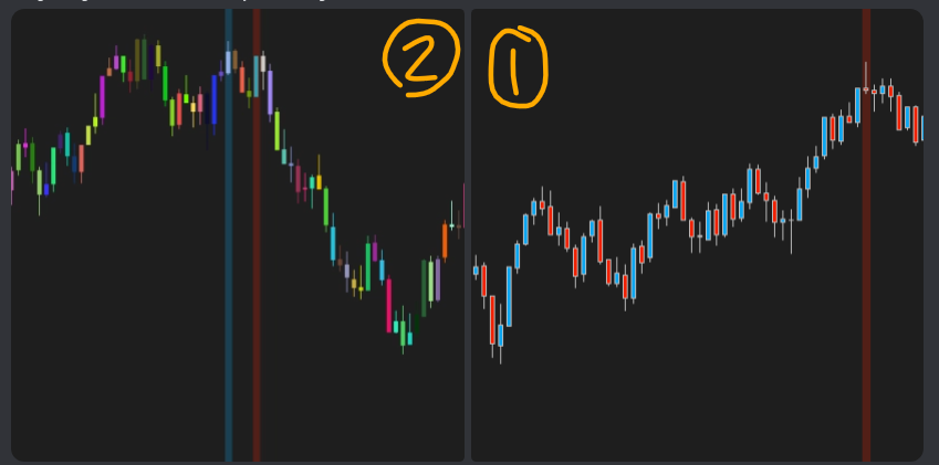

Hi Sierra Chart Engineering,
Just discovered that a study with 2 Subgraphs will not work as expected when one is DRAWSYLE_BACKGROUND and the other is DRAWSTYLE_COLOR_BAR.
With DRAWSYLE_BACKGROUND on one and DRAWSTYLE_COLOR_BAR on the other, the Color Bar coloring is not working.
Setting the DRAWSYLE_BACKGROUND Subgraph to Ignore or DRAWSTYLE_BACKGROUND_TRANSPARENT shows the Color Bar coloring as expected (as well as the background coloring).
See attached image for the two scenarios with a random study I used...(1) busted, (2) working as expected.
Is this a bug in Sierra or some obscure way DRAWSYLE_BACKGROUND works?
imageScreenshot 2024-10-11 145326.png / V - Attached On 2024-10-11 21:53:47 UTC - Size: 50.61 KB - 205 views

User719512 - Posts: 543
Build this study so you can see the issue.
With Subgraph_BuySignal.DrawStyle = DRAWSTYLE_BACKGROUND;, the Subgraph_ColorBar will NOT work.
With Subgraph_BuySignal.DrawStyle = DRAWSTYLE_BACKGROUND_TRANSPARENT;, the Subgraph_ColorBar will work.
You can set these from the UI, so just build the sample once.

[2024-10-14 15:01:25]
User431178 - Posts: 910
Chart Studies: Background (ACSIL: DRAWSTYLE_BACKGROUND)
It's documented behavior.
[2024-10-14 16:09:52]
I was not asking for programming help John, I was providing an example of the issue since my first post was unclear so you could see for yourself. User431178 has provided a helpful link that explains the behavior. I missed looking for that in my original research.
