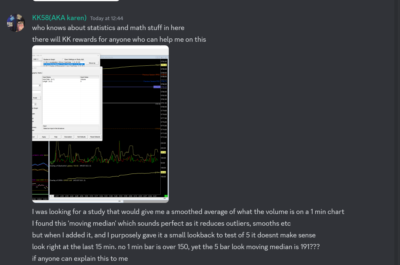

John, I hope you can help explain what I am seeing in the chart attached. I posted this in Jay Strizz discord room and even the quant Poppa couldn't figure it out. In the attached screenshot you will see 1 min ES chart, with volume plotted as a line. You can see I have a very short lookback(so I can see how accurate it was), but the moving median in yellow makes no sense. How can it be higher than the highest volume level in the 5-bar lookback?

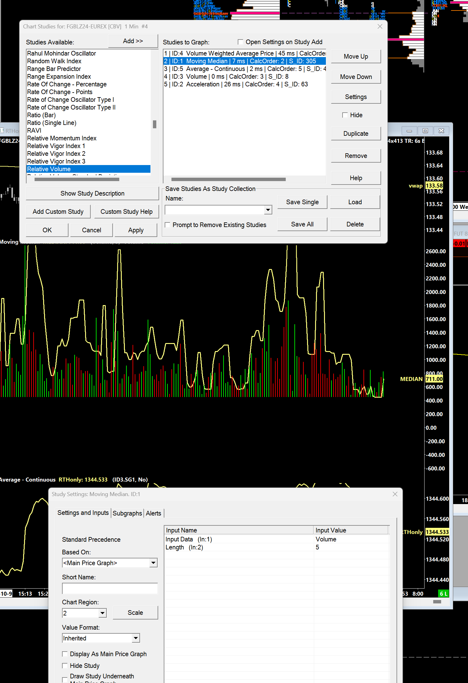

The first thing that comes to mind is what is the Scale for the Moving Median study? Make sure this is set to "Automatic" or "Same as Region". Refer to the following:
Chart Studies: Settings and Inputs Tab >> Scale
Date Time Of Last Edit: 2024-10-09 18:41:42
[2024-10-10 06:59:17]
User849502 - Posts: 485
How much do I love you? What I hadn't done is switch 'based on' in the settings and input tab from main chart graph to volume. You da best. Thanks mate, Karen

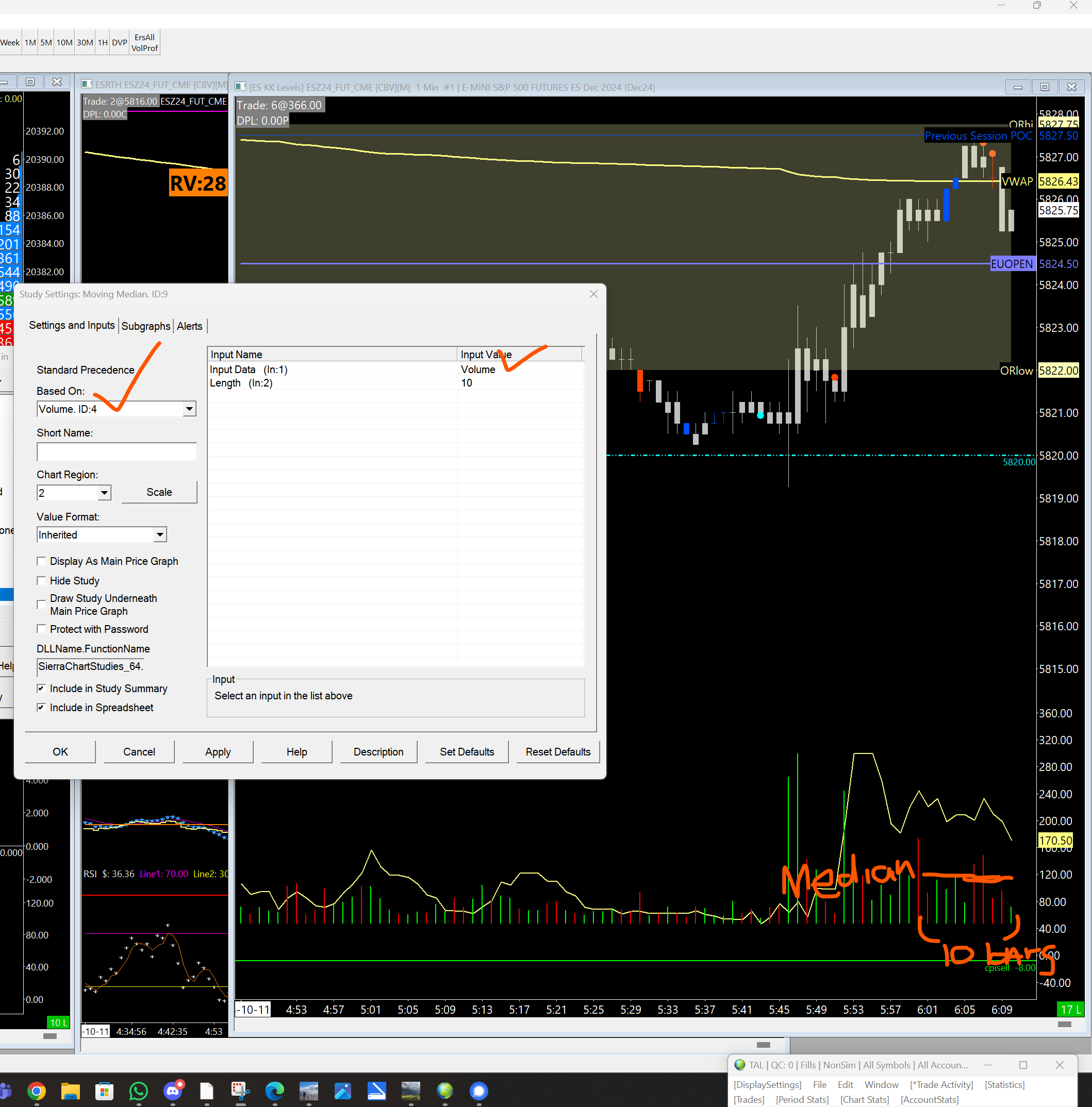

Hi John,
Rats this still seems like it is not working. Look at screenshot please. I have lookback set for 10 bars/mins on this 1 min chart. You see there is no bar in that time anywhere near what moving median is plotting. I have the study set to look at volume. What am doing wrong? Just to confirm, this study should show me the median(the value in the middle of the 10 bars), so how can the study show a value higher than any of the bars...
Sorry to bother you, but I still must have something off on settings. Or I don't understand what a median is haha
Karen
image10bar.png / V - Attached On 2024-10-11 11:22:35 UTC - Size: 317.43 KB - 269 views

[2024-10-11 15:12:08]
I hope I did this right...thank you John and Bon Weekend!
attachmentvolumemovingmedian.Cht - Attached On 2024-10-11 15:11:36 UTC - Size: 4.95 KB - 564 views
[2024-10-11 15:51:59]
This is a scaling issue.
Since the Volume uses a scale of "Automatic Zero Based", the Moving Median is not matching up correctly. We are not sure why exactly. But we can tell you that the solution is to set the "Moving Median" to use the same scale option - "Automatic Zero Based".
