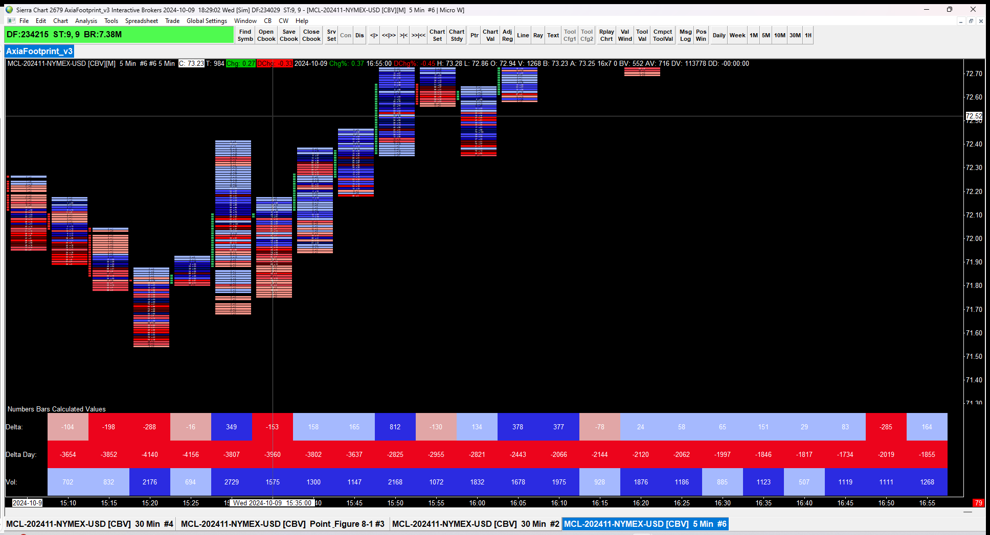

User650826 - Posts: 9
https://www.sierrachart.com/image.php?Image=1728423535884.png
Delta day - Cumulative Sum of Volume ask bid volume difference day. I would like the numbers shading ( 3 colours for red and 3 colours for blue) to spot divergence between cumulative delta and price using the same colours for delta and volume in the picture. Thanks
Thank you for helping john but how you can see from the picture there is not shading at all from 3654 to 1855. On the course video I can see Delta 5450 blue, 5478 intense blue, 5409 blue, 5364 blue, 4817 light blue, 4831 light blue. can I upload the chartbook for you to review please? I simply need help from the support service.
https://www.sierrachart.com/image.php?Image=1728498543946.png

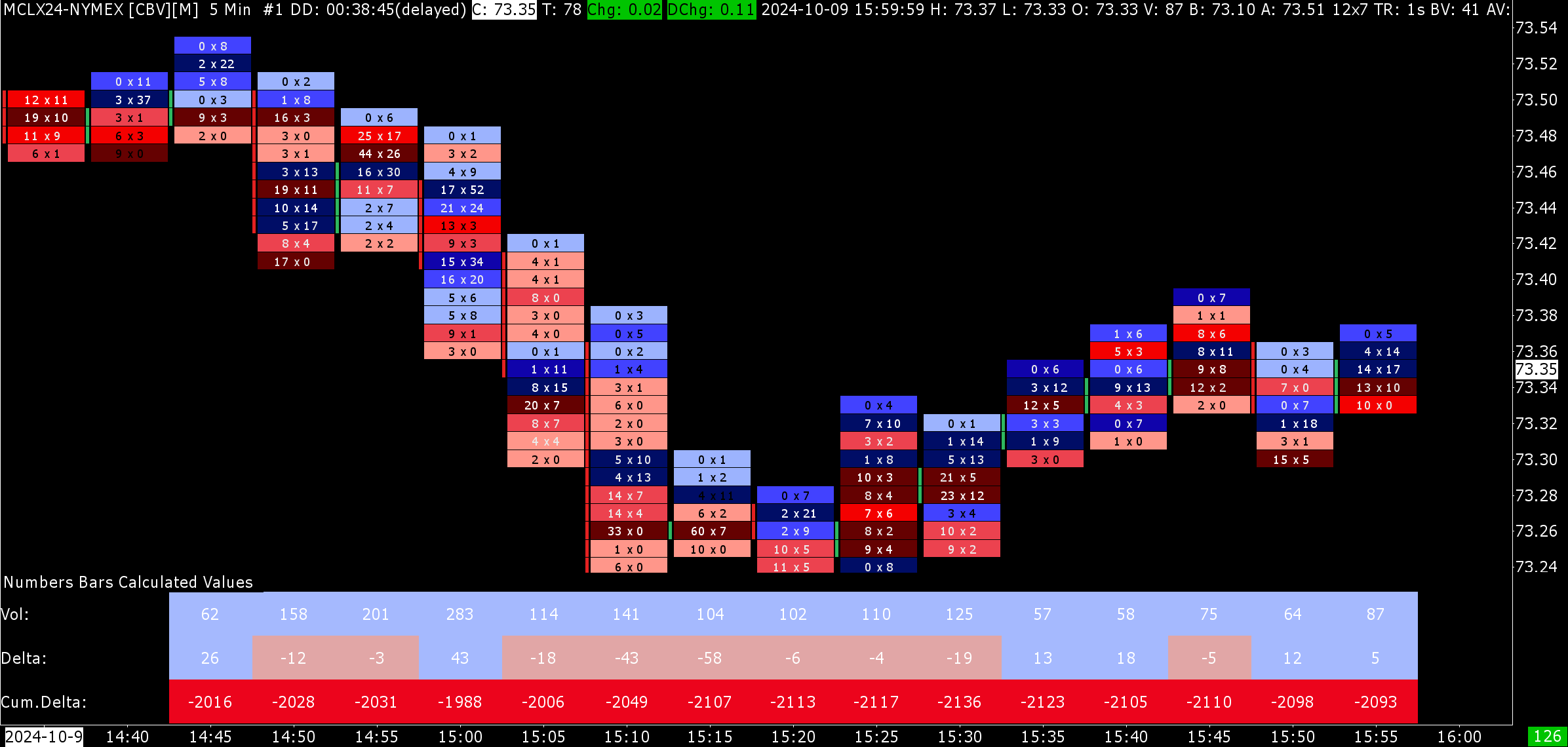

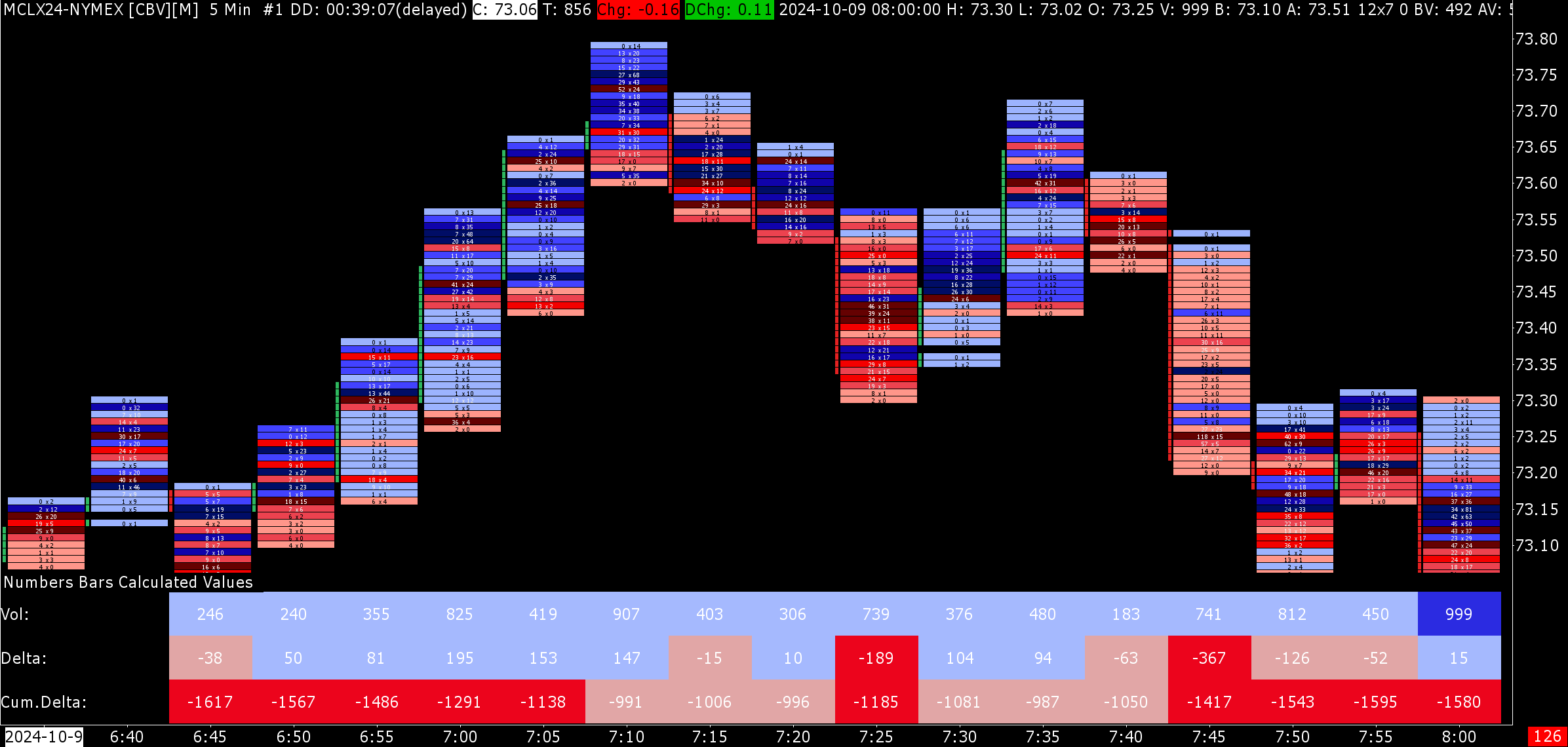

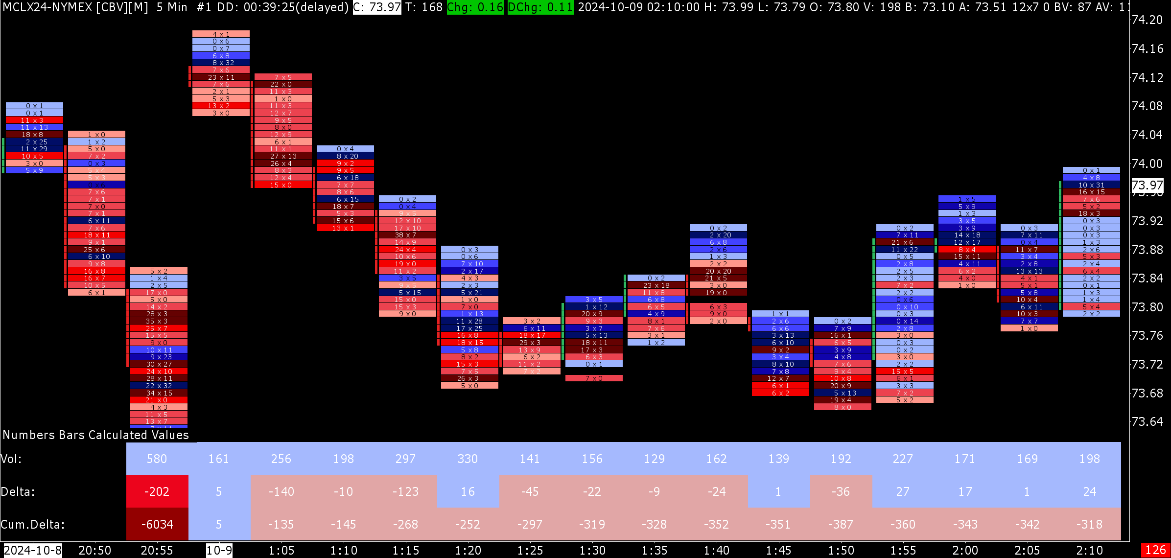

We are not seeing any issue with the chart. We changed it to 5 minute bars and the Cumulative Delta - Day in the Numbers Bars Calculated Values have the color highlighting as we expect. Attached are a few images.
- EndOfDay.png: This shows the data at the end of the current day. The background coloring is all the same red color as the data is all around -2000.
- EarlyDay.png: This shows the different coloring occurring around 07:00 due to the smaller values at that time.
- StartOfTradingDay.png: This shows the coloring at the start of your defined trading day (01:00 according to the Session Times). You will see a blue background where the Cumulative Delta started positive, then changes to pink for the negative values.

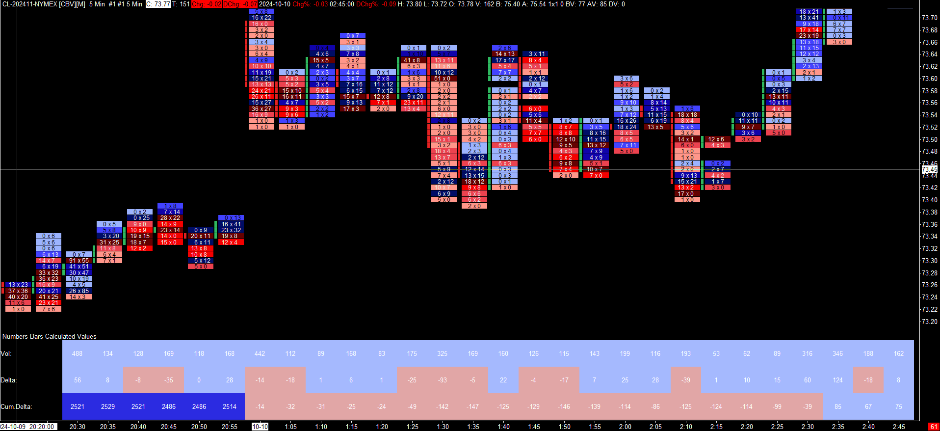

Hi John, just to let you know that i solved the issue switching to the symbol CL from MCL. For whatever reason the cumulative delta wouldn't display correctly on micro contracts. See picture for reference. Thank you

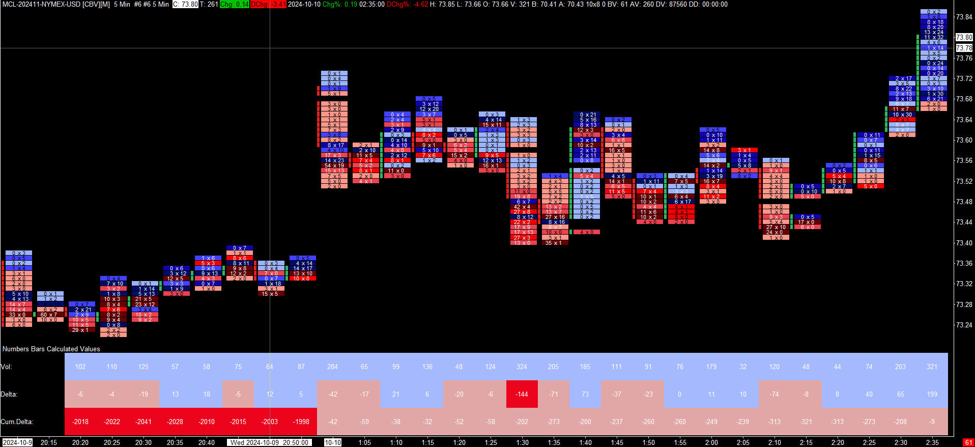

Attached same picture but MCL
https://www.sierrachart.com/image.php?Image=1729014322532.png
[2024-10-15 18:11:08]
MCL is working fine according to that image. You can see the Dark Red where the numbers are much lower (around -2000) and then changes to pink when the new trading day starts and the values are in the tens and low hundreds.
