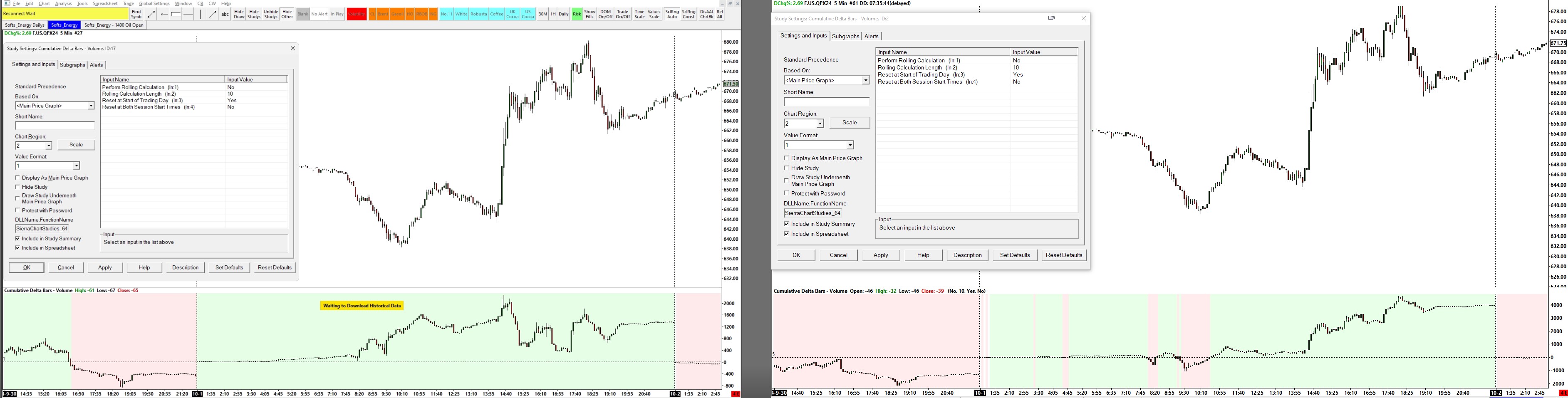

The screenshot below is two ICE Gasoil Nov24 charts from my two separate Sierra Charts.
Why would the Cum Del be different?

You would need to look at the underlying data to see if there is missing information. Since you are getting the data from CQG, we wonder if one system may have had to download historical data, which may not have the bid/ask information and hence give a different Cumulative Delta.
You can use the Numbers Bars to look at the underlying data for the Bid/Ask and see how those match up. Refer to the following:
Numbers Bars

Ok yea so the one on the right had to download the data and the one on the left was populated live, so that one is probably correct?
So if I was back testing Id have to question the accuracy of CQG data?
[2024-10-07 16:07:35]
You definitely need to check to ensure that you have what you need.
