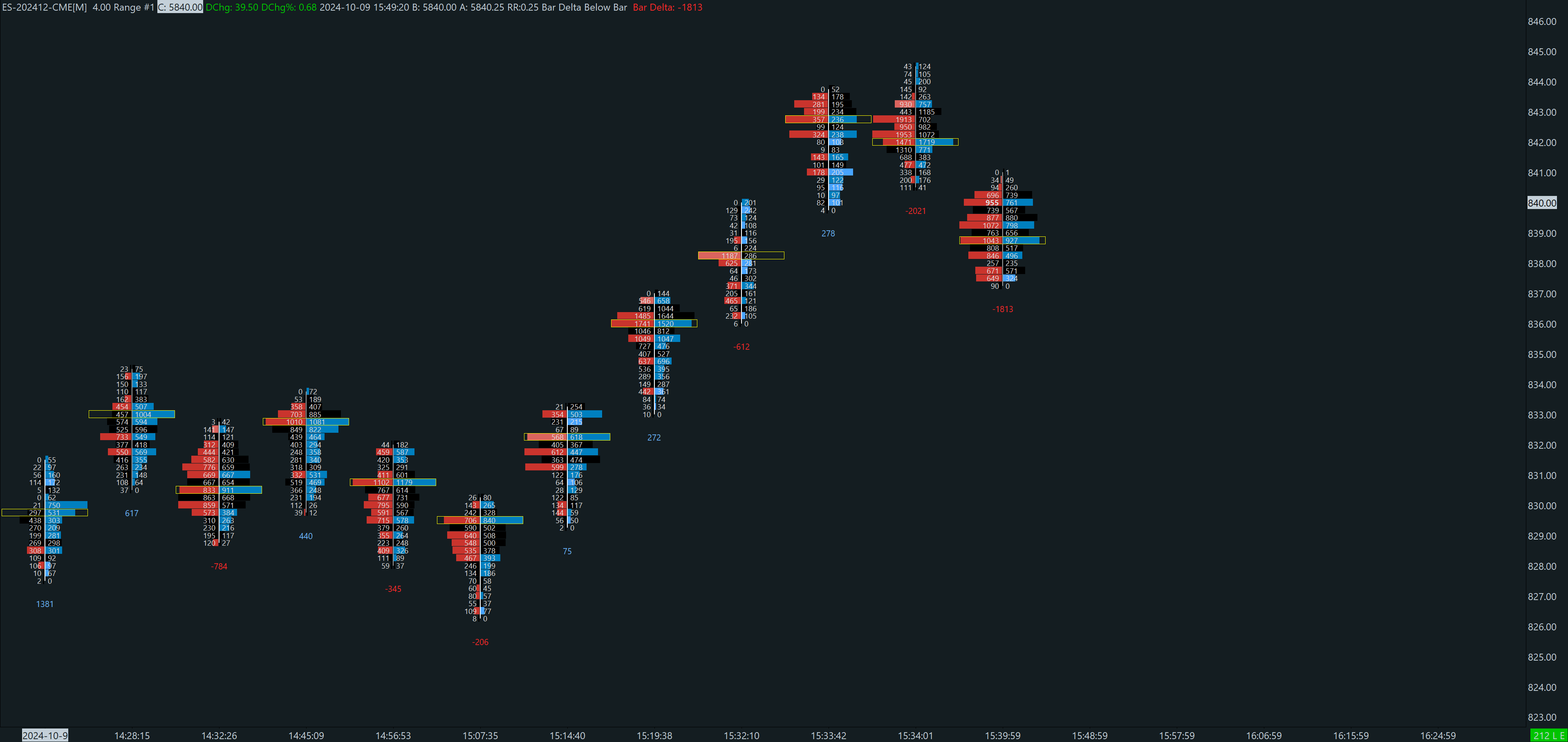

Here is the chartbook. I am questioning every level that is colored black. If you look at the coloring options for column 1 (inputs 20 to 27) you will see that nothing should be colored black, everything is configured to be shades of blue / red. You won't have any problem finding a bar where it happens, it is everywhere : https://www.sierrachart.com/image.php?Image=1728503362676.png |

| John - SC Support - Posts: 48583 |
The levels that are not colored are because there is not a dominant side at that level (i.e. both sides are non-dominant) or because there is a comparison with a zero value. For example, look at the first bar in your image. We see the following within that bar: 114 172 5 132 0 62 The level in the middle with Bid | Ask of 5 | 132 is black - it has no coloring. This is because the Bid is not dominant (5 compared with 172), and the the Ask is not tested since it is compared with a Zero value and the Input for "Enable Bid/Ask Ratios with Zeros as Ones" is set to "No". Refer to the following for this new Input: Numbers Bars: Enable Bid/Ask Ratios with Zeros as Ones Further down in that same bar you have the following: 199 281 269 298 308 301 In this case neither bid or ask is dominant with the middle value (269 | 298). This comes about because you compare the Bid at that level (269) with the Ask at the next higher level (281) - therefore the Bid is not dominant. The Ask Side compares the Ask at that level (298) against the next lower Bid (308) and the Ask is not dominant, hence no coloring is applied. For the most reliable, advanced, and zero cost futures order routing, use the Teton service: Sierra Chart Teton Futures Order Routing |

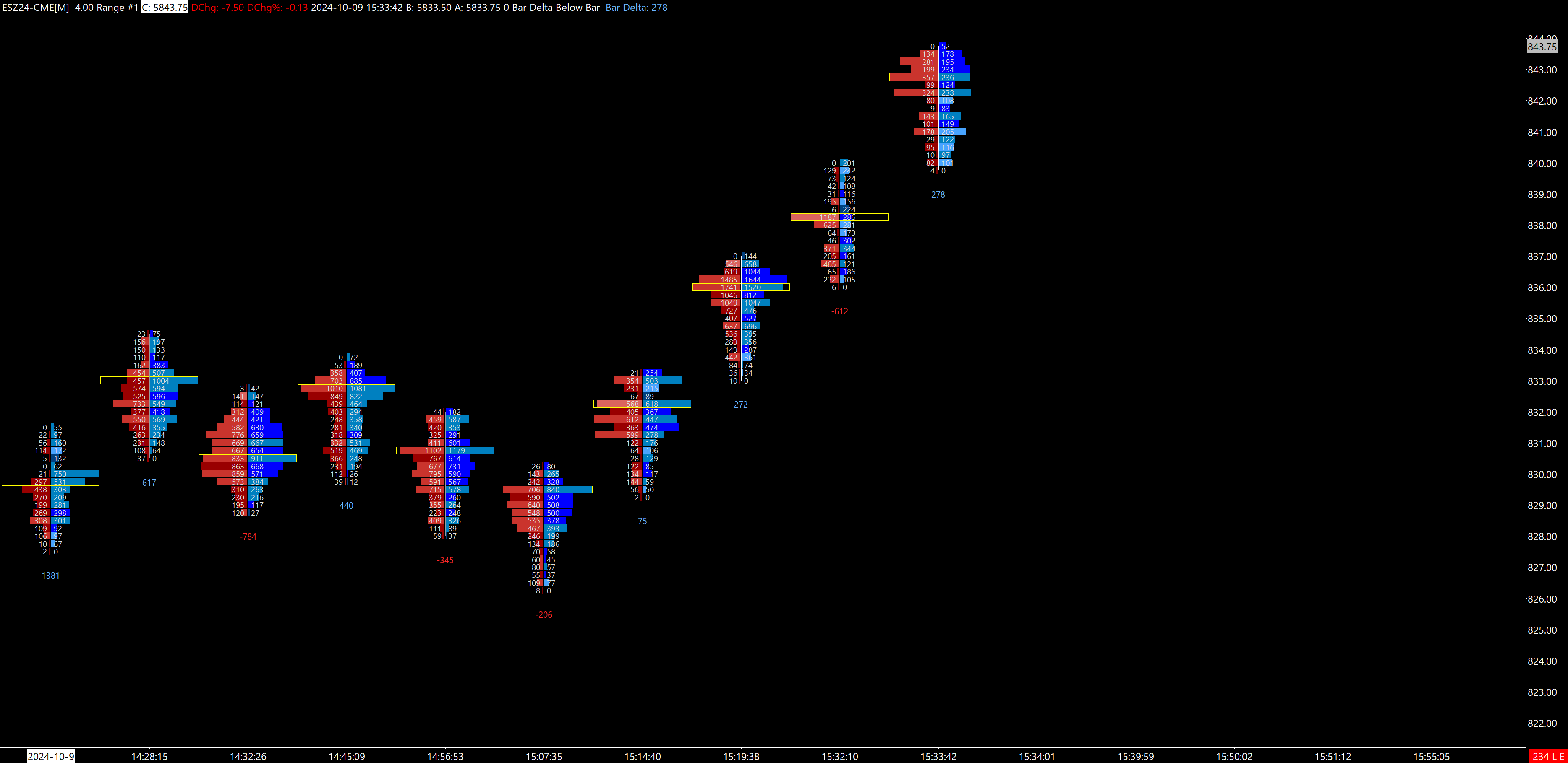

| Chris32 - Posts: 81 |
Thank you, I understand. We could previously color the non dominant side too with this background coloring method and that changed, hence my confusion. Here is the exact same chart with version 2674. https://www.sierrachart.com/image.php?Image=1728506421118.png |
| [2024-10-09 21:44:47] |
We apologize that this is different from what occurred previously, but part of the work we did on the coloring was to align all of these options so they were working consistently per the way they are documented (and supposed to work) and to make the background coloring work in the exact same way as the text coloring (there were some differences in this).
