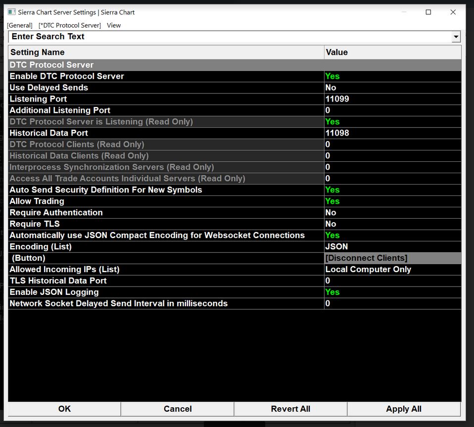

I have created a script for automatic trading using DTC protocol in Sierra Charts.
I have active connection to DTC, but when I call command LOGON_RESPONSE, I can´t get answer from DTC after a few seconds.
Attached screen from Sierra shows my DTC settings, if there is something wrong.
Both methods for Logon, also with Account / without Account I have also used, but there is no answer from DTC.
You can find MessageLogs attached.

[2024-10-04 14:24:32]
Sierra_Chart Engineering - Posts: 25248
So you are connecting to the DTC protocol server in Sierra Chart? If so, you would not use Logon Response. As a client you would use a logon request. And once you send a logon request you get a logon response from the server.
Date Time Of Last Edit: 2024-10-04 14:25:08

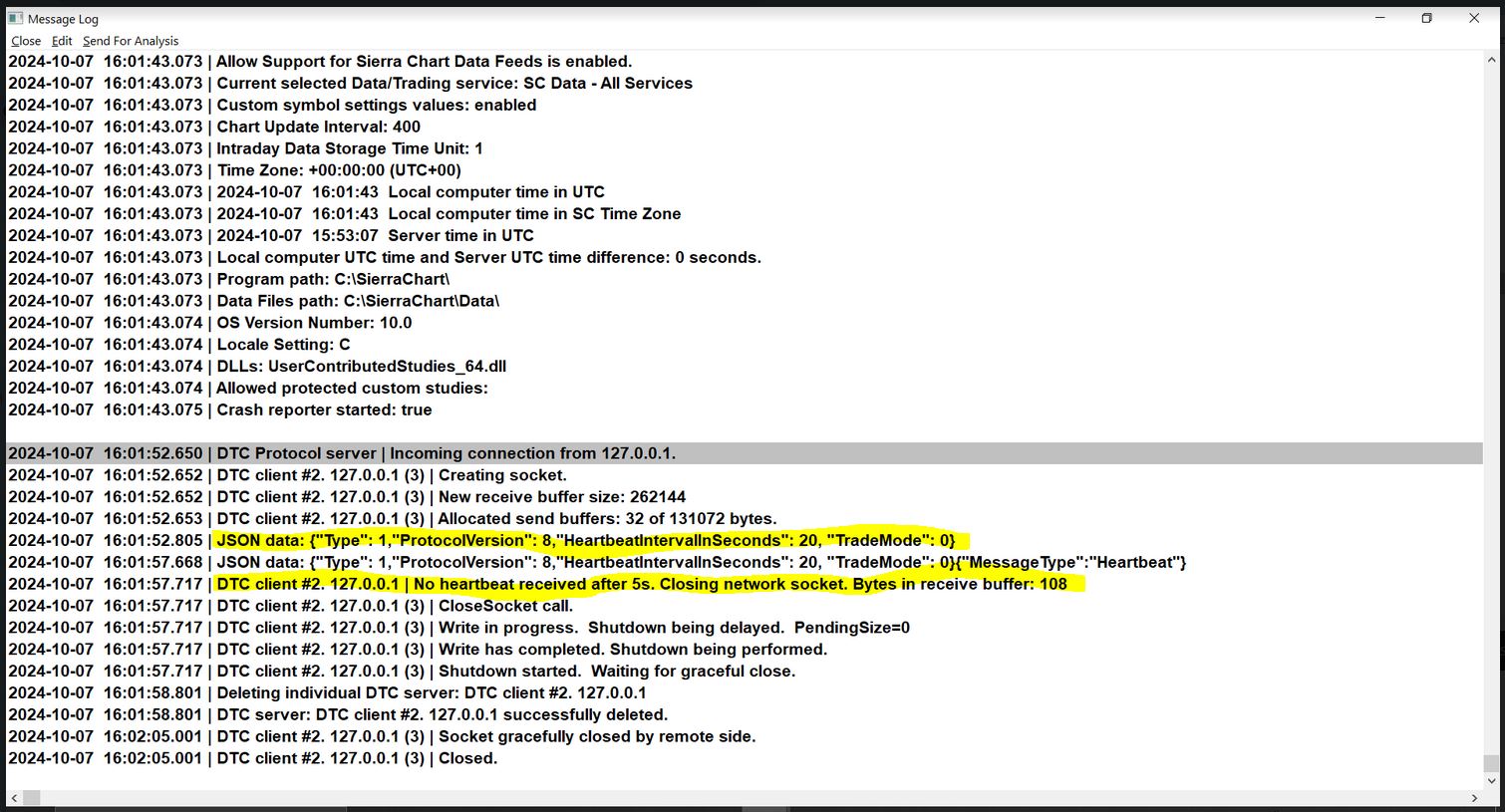

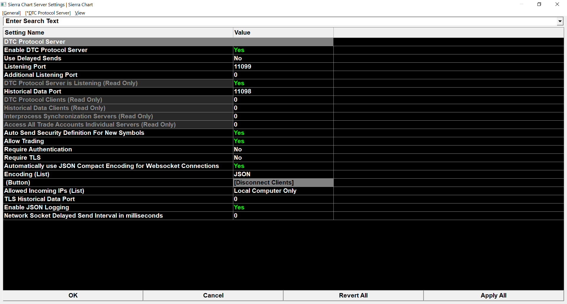

[2024-10-07 17:32:15]
stefkovic.m28 - Posts: 45
many thanks, I have tried your code, but I have not heartbeat again and server has closed my connection.
I have added here my message log and Sierra settings for DTC protocol.
Do you see there please something, what´s wrong on my side?
thanks
image1.JPG / V - Attached On 2024-10-07 17:32:02 UTC - Size: 239.33 KB - 257 views
image2.JPG / V - Attached On 2024-10-07 17:32:06 UTC - Size: 129.88 KB - 274 views
[2024-10-07 18:23:17]
User388741 - Posts: 9
MessageType in heartbeat is an invalid key. All messages need to have a "Type" key with an int. You can look up the mapping here: https://www.sierrachart.com/DTC_Files/DTCProtocol.h
Also, doesn't look like you're sending the \0 byte after each message. You need to do this. DTC will also respond with a \0 delimiter between messages, you need to handle those.
[2024-10-07 18:30:45]
I also don't know what 'TradeMode' is supposed to be in your LOGON_REQUEST message, that doesn't exist anywhere in the spec.
[2024-10-07 20:06:03]
Many thanks, I have found it finally, it was the delimiter.
Now I have to try execution commands, sucessfully connection I already have.
thanks
