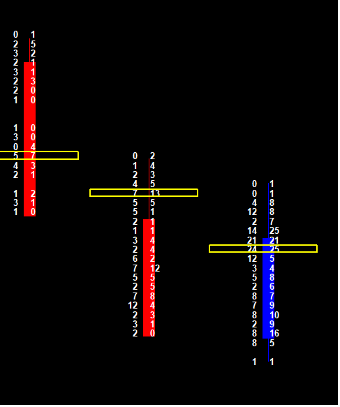

I can't center the candlesticks between the bid and ask levels. How can I modify the position of the candles (I only know how to adjust their size)
i'm using numbers bar for ask/bid and i'm using overlay (bar) for candlesstick
imagecandlestick.png / V - Attached On 2024-09-24 20:51:31 UTC - Size: 11.95 KB - 163 views
[2024-09-24 21:24:13]
Make sure the Input on the Numbers Bars study for "Numbers Separator Character" is set to "3 Spaces". The evenly spaced values will cause the candlestick to be offset by one character. Refer to the following:
Numbers Bars: Bid Volume Ask Volume Text Delimiter
Also, you may want to use the chart specific graphics settings in order to modify the width of the candlestick to be much thinner. Refer to the following:
Graphics Settings: Candlestick Width %
Graphics Settings: Using Different Color and Graphics Settings for Specific Charts

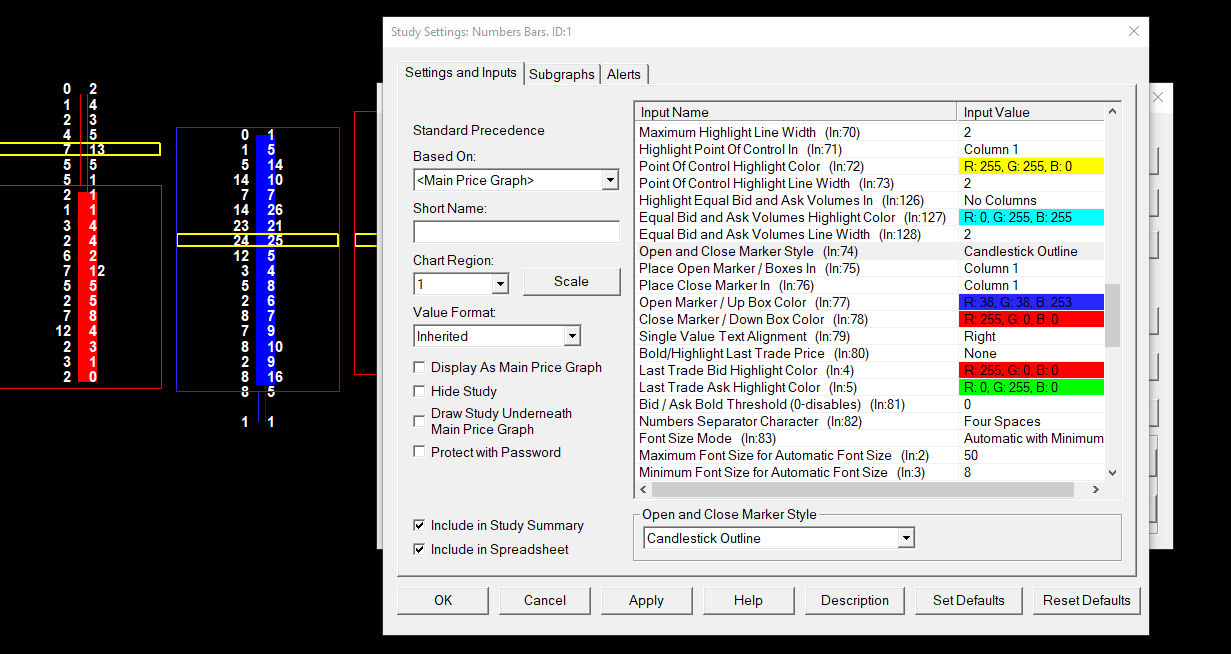

The Numbers separator caracters (In:82) is set on four spaces , also when i make the open and close marker style (In:74) on candlestick outline, the candlesticks outlines aren't alined
imagecandlestick 1.png / V - Attached On 2024-09-24 21:29:18 UTC - Size: 61.81 KB - 153 views
[2024-09-24 21:37:14]
Change the "Numbers Bars Separator Character" to be 3 spaces and see if everything lines up as you want.
[2024-09-24 21:44:54]
7emmadi - Posts: 5
Super, merci beaucoup ca a bien marché
