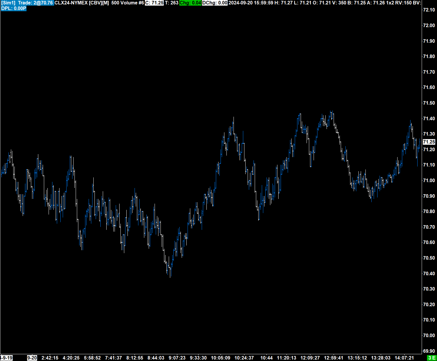

[2024-09-22 19:03:32]
chimichanga - Posts: 5
Yes I am looking the chart named Trigger ETH and I have set the input on the "Large Volume Trade Indicator" for "Use Transparent Draw Style" to "No". So here you have what I see:
https://www.sierrachart.com/image.php?Image=1727031803585.png
[2024-09-23 14:03:53]
Make sure the setting for "Global Settings >> Data/Trade Service Settings >> Common Settings >> Intraday Data Storage Time Unit" is set to "1 Tick". If it is not, then it needs to be 1 tick in order to allow the "Large Volume Trade Indicator" to work correctly. If you do make a change to this setting, then be sure to select "OK" to close that window and then select "File >> Reconnect" and then select "Edit >> Delete All Data and Download".

[2024-09-23 21:26:05]
Now It's Working! Thank you so much!
