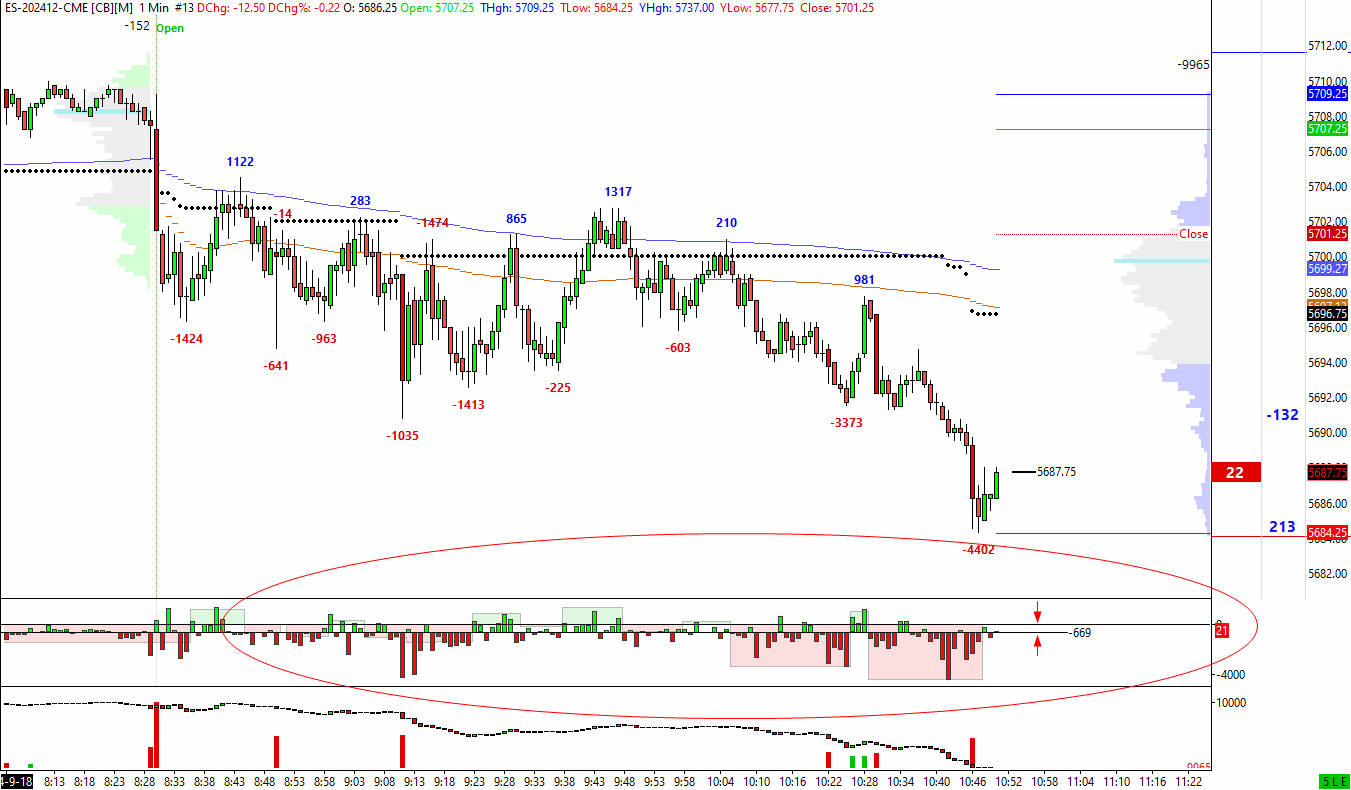

User731023 - Posts: 167
Is there a way to get 2 indicators to line up at the 0 line?
I tried different scaling. Auto/Independent etc.
Also changed order of what one was first.
Tried all I can think of.
PS See snapshot region 2.
image1mmmm.jpg / V - Attached On 2024-09-18 15:57:38 UTC - Size: 163.43 KB - 191 views
[2024-09-18 17:25:13]
From what we see, the studies have different basis lines. One uses 0 and the other uses -669. This is why they are not lining up. The simplest solution is to adjust the data that uses a base of -669 to be at a 0 base. You would need to adjust the data to do this. Refer to the following:
Using the Basic Arithmetic Studies
Another solution would be to set the study that is offset to -669 to use the Left Side scale and then you can adjust that left-side scale so that the study is positioned where you want it. You can then turn off the left-side scale if you no longer need it. Refer to the following:
Chart Settings: Use Left Side Scale (Chart >> Chart Settings >> Scale menu)
