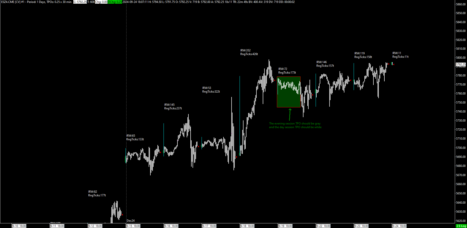

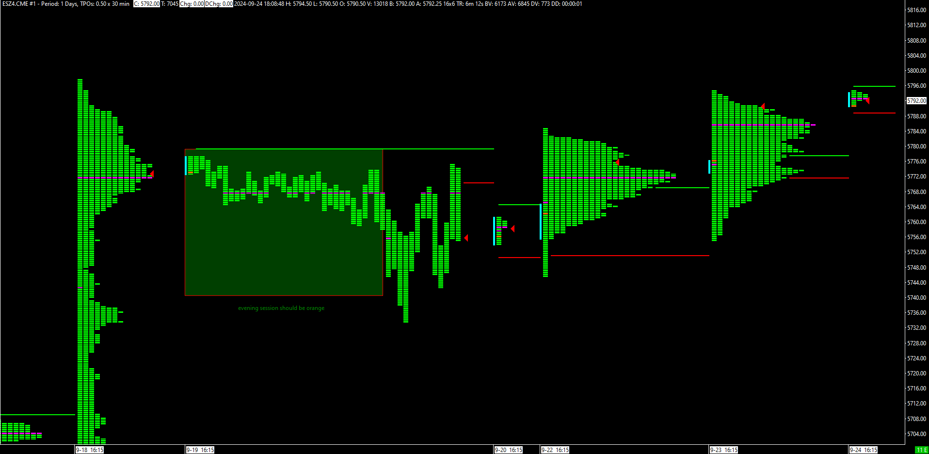

I have attached two chartbooks. the first is the chartbook SC provided showing the TPO as all green for both sessions. and the second is my own chartbook showing the same TPO coloring issue where both sessions are the same color.
My chartbook is setup to show the evening session TPO as grey and the day session TPO as white. but after the update, both sessions are showing as white
sorry if I'm over-explaining, just want to be clear about what the problem is
https://www.sierrachart.com/image.php?Image=1727215635239.png - jberlin full session chart showing both session TPO same color
https://www.sierrachart.com/image.php?Image=1727215735978.png - SC provided chart showing both session TPO are same color

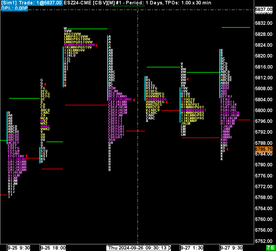

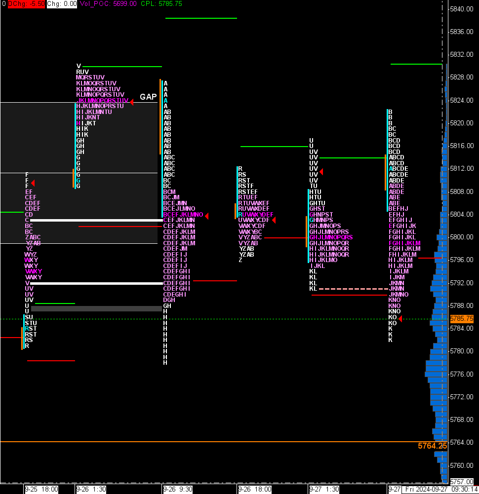

I have a similar Problem - Custom intraday session colouring is now the same as the primary session after updating to 2679:
TPO is OK with just day and evening; it retains different evening session colouring when the number of Custom Intraday Sessions is set to 0.
However, overnight colouring is lost if the number of Custom Intraday sessions is set to 3.
I rolled back to 2654 on one install, and then the colouring worked correctly again:
https://www.sierrachart.com/image.php?Image=1727525416880.png
This shows the problem: the same settings on my main install after the latest update to 2679:
https://www.sierrachart.com/image.php?Image=1727525455402.png
[2024-09-28 14:18:20]
Update to the latest prerelease. This is now resolved. Instructions:
