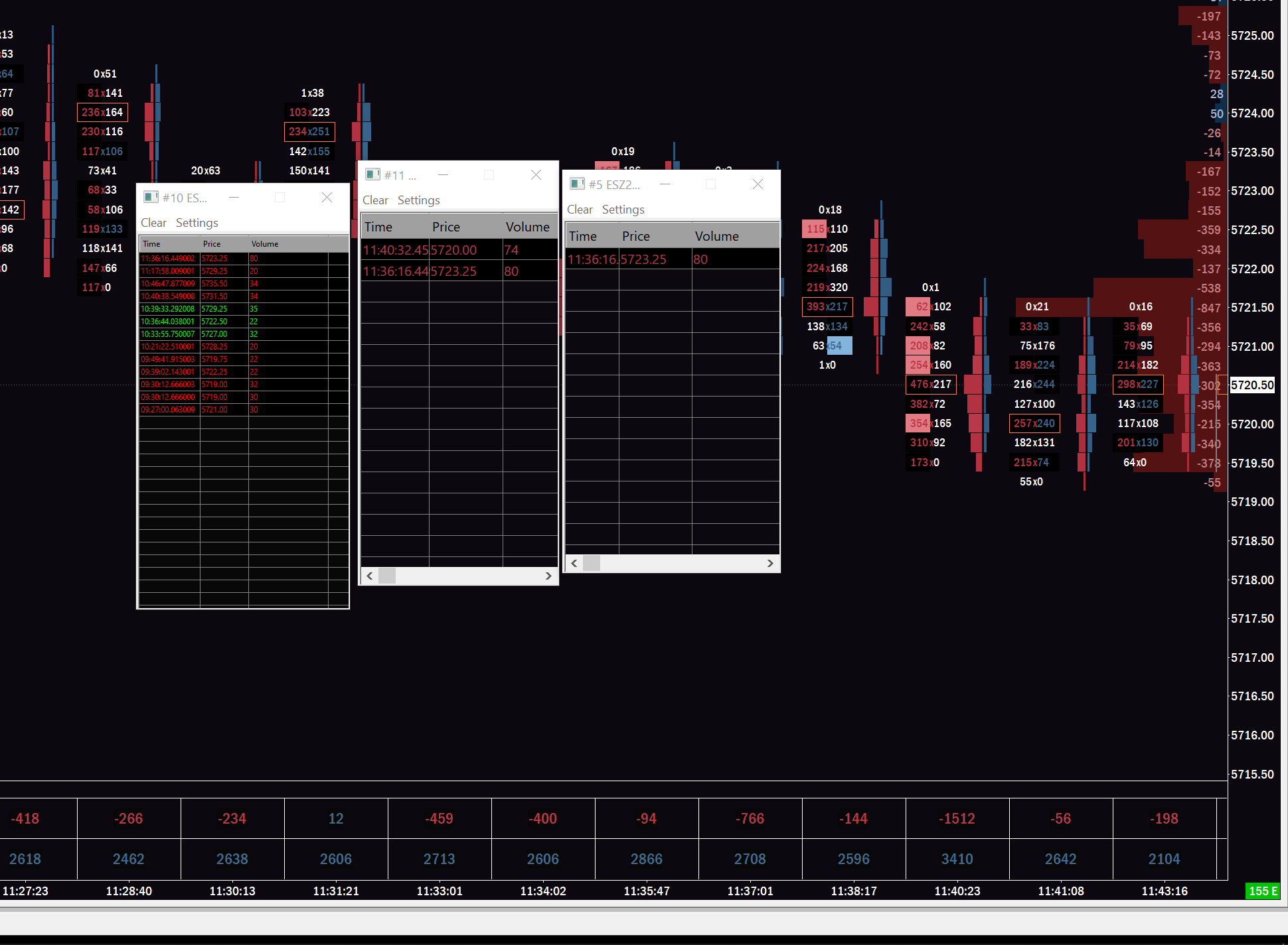

[2024-09-12 20:06:08]
User257481 - Posts: 39
again 3 T&S same settings and not all of them get the same data it's so wired. I can tell that I transferred some charts and dom from different charts books so I don't know if this connect to this problem

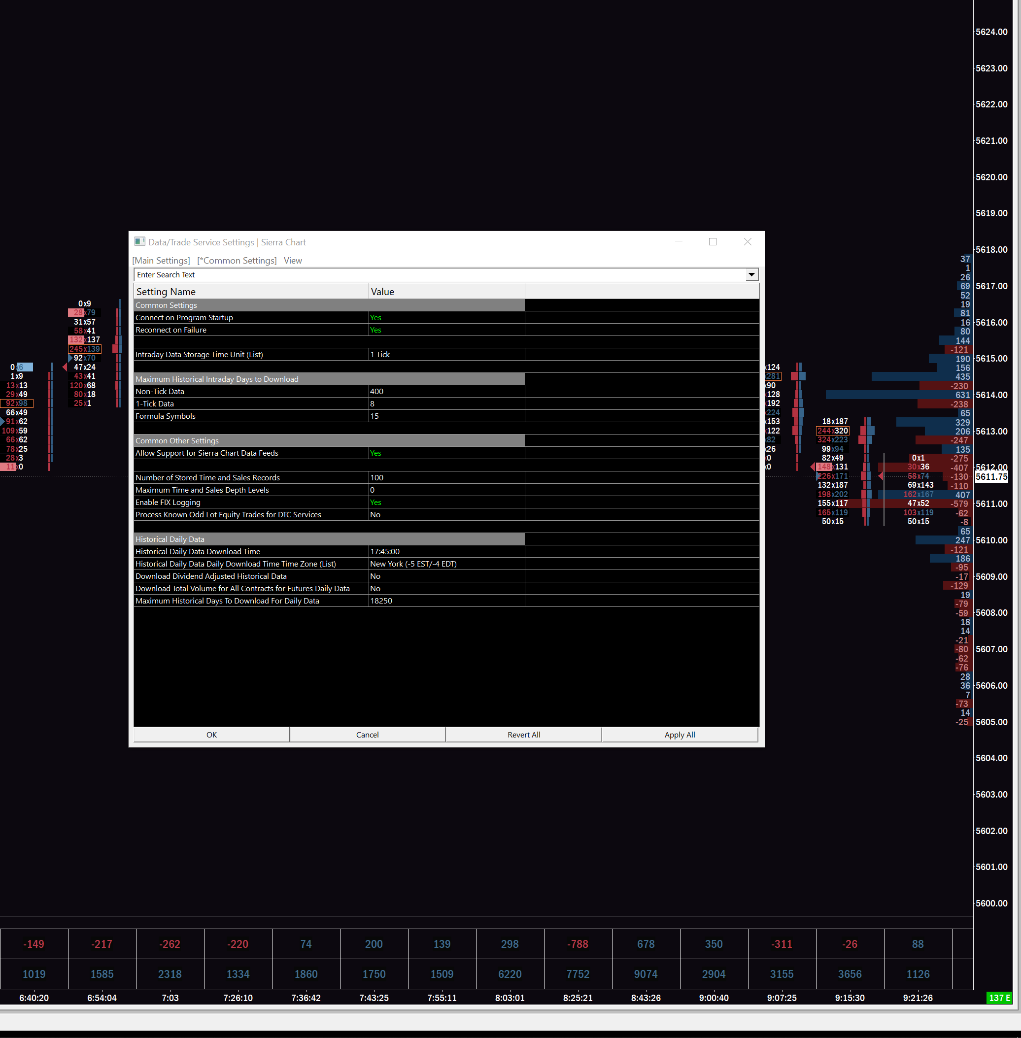

[2024-09-13 13:25:00]
i think i never tuch somting here if there's somting that can fix an I needed to change let me know please
[2024-09-13 13:25:25]
File attached
image2024-09-13-16-23-29 1.png / V - Attached On 2024-09-13 13:25:14 UTC - Size: 212.61 KB - 249 views
[2024-09-13 13:26:05]
i forget to attached for the first time
image2024-09-13-16-23-29 1.png / V - Attached On 2024-09-13 13:26:01 UTC - Size: 212.61 KB - 308 views

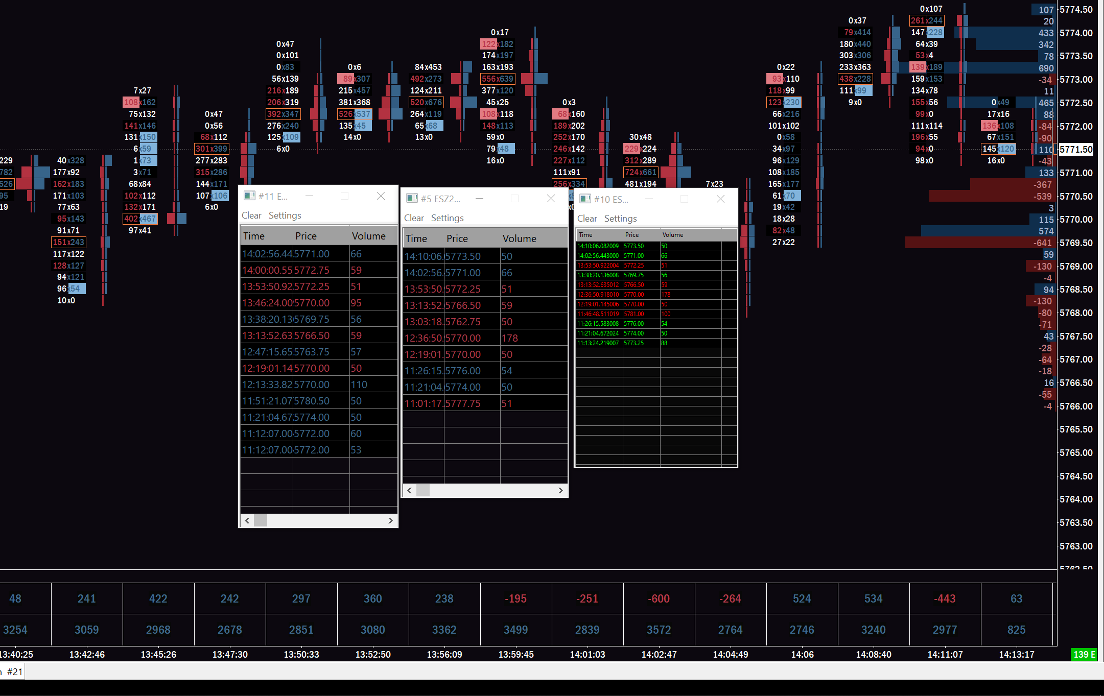

[2024-09-13 18:32:46]
same time and sales same settings and filter 3 different data is comings
image2024-09-13-21-30-47 cc.png / V - Attached On 2024-09-13 18:32:38 UTC - Size: 210.36 KB - 284 views
[2024-09-13 19:20:36]
The good news is that we now see the exact same data when it is printed in each of the three windows. So that means that the Time and Sales is definitely picking up the correct data. For example, the posting at 13:06:42.290019 is in all three windows with a volume of 52.
Given this, the implication is that the filtering value is not the same for all 3 windows. If they were all set to 50, then you would not be getting the values less than 50 in these windows. In particular, it looks like the Time and Sales filtering are set to the following, from left to right in the image:
- Referencing Chart #10: 20
- Referencing Chart #5: 50
- Referencing Chart #11: uncertain
Also make sure the option for "Show Bid and Ask Records" is set the same between all three windows.

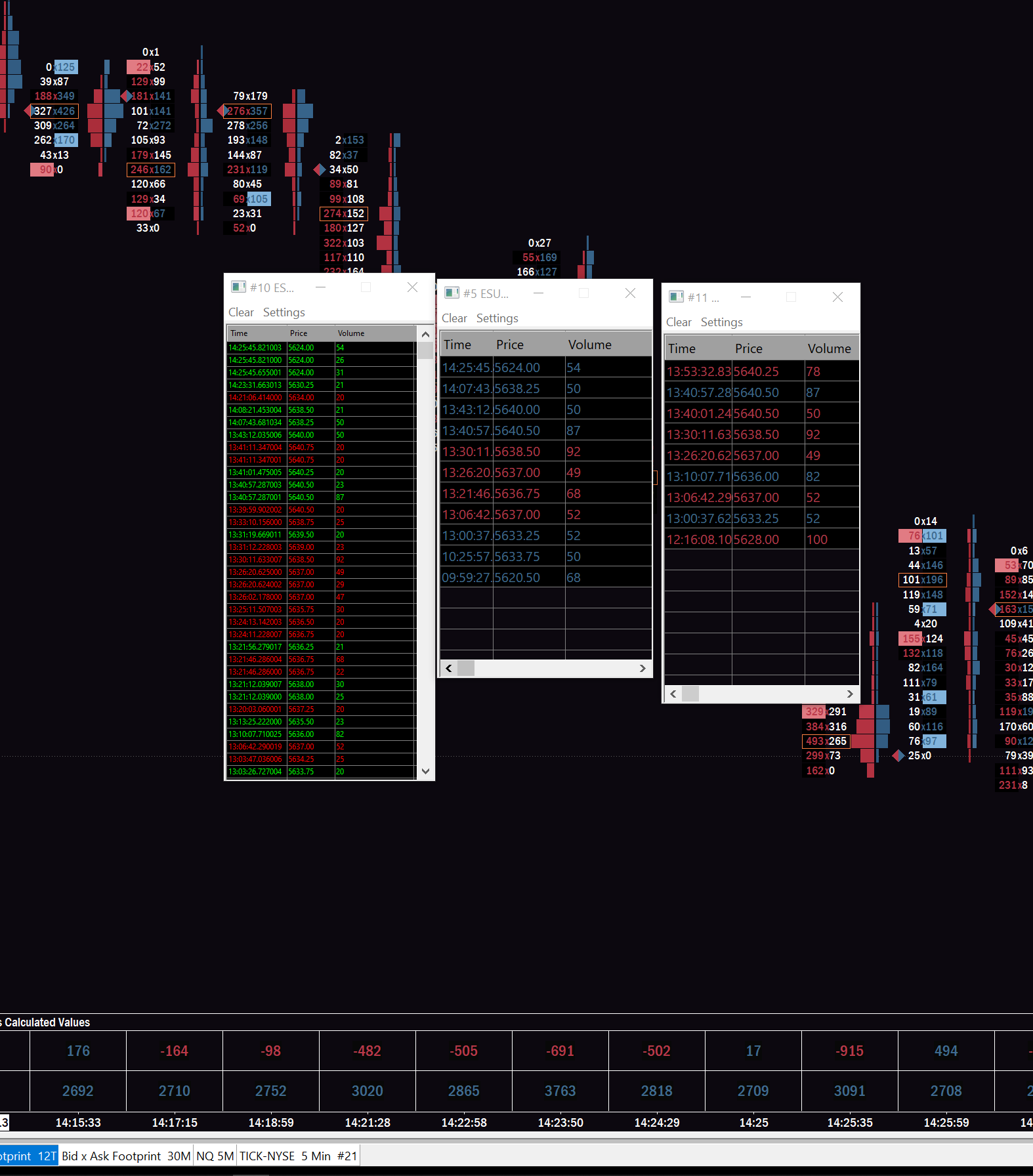

[2024-09-17 15:49:50]
the left 20 the other 2 are 50 I add pics you can see 74 print only in of of them
image2024-09-17-18-44-50 kkk.png / V - Attached On 2024-09-17 15:49:37 UTC - Size: 169.3 KB - 325 views
[2024-09-17 17:26:27]
There has to be something else different in the settings for those Time and Sales windows. In particular, the one associated with Chart #5. Please look at the settings for that Time and Sales and see what is different - note the Combining option at the top in particular.
