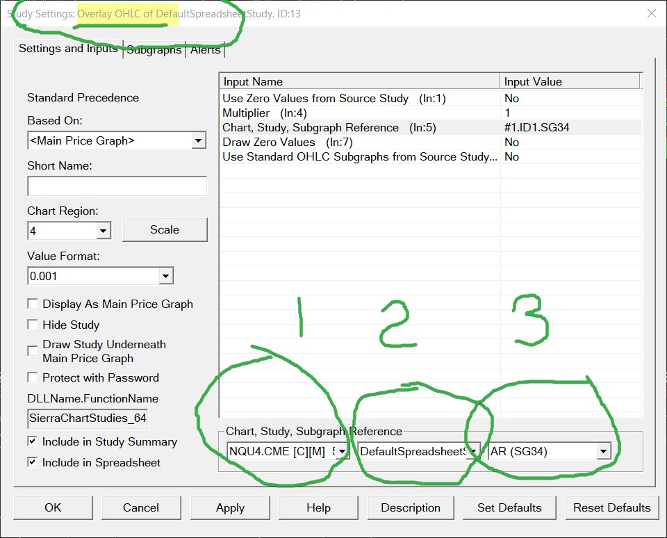

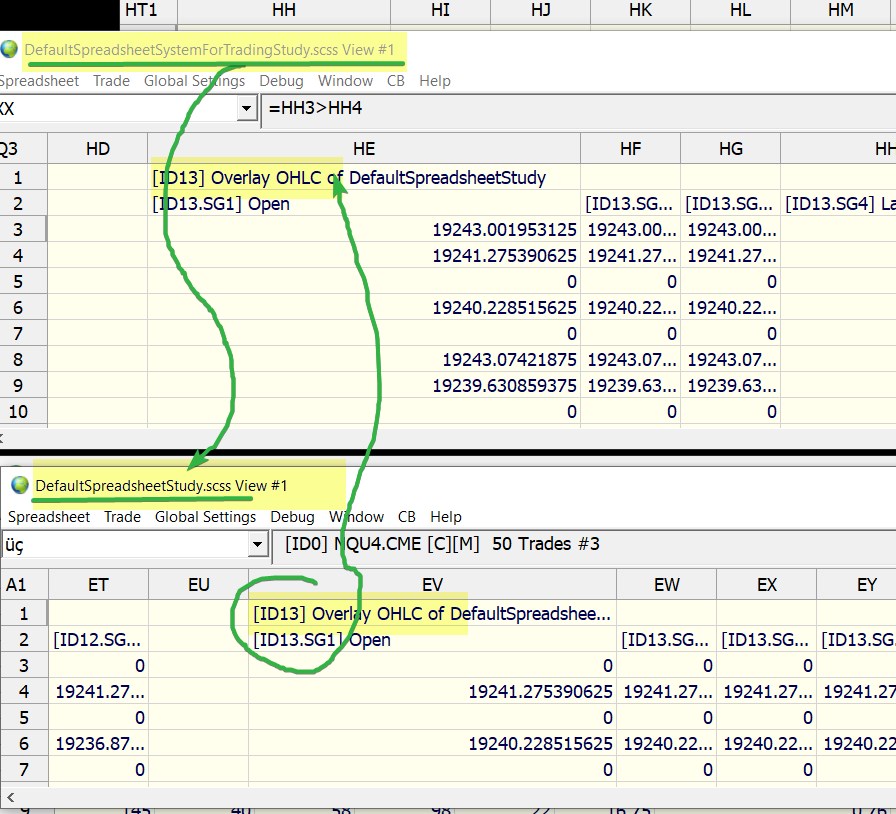

[2024-09-11 22:53:21]
User335019 - Posts: 9
Thank you for all answers.
Usage of "Overlay OHLC" study also helped for my case as well.
This study has 3 level inputs to reference
3 any cell
2 from any spreadsheet/spr.for.trade
1 of any chart
So calculation/information of a spreadsheet cell can be referenced by any other spreadsheet or by any spreadsheetfortrade. Transfer between charts of a single sierra instance.
Thank you
Date Time Of Last Edit: 2024-09-11 22:54:30
imageSierraChart_64_KyPyvXuWr8.jpg / V - Attached On 2024-09-11 22:40:46 UTC - Size: 183.45 KB - 237 views
