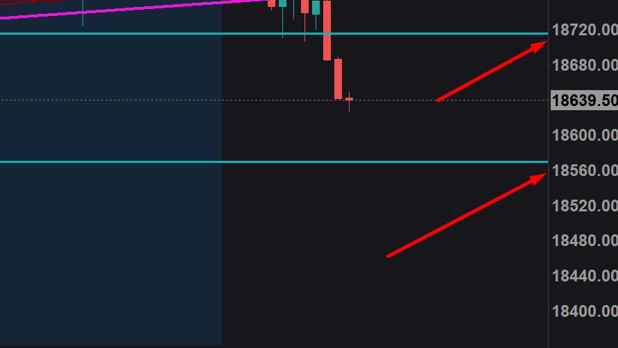

When I set a horizontal line on the chart I want to see what price its at on the price axis. How do i enable this?
imageScreenshot_1.jpg / V - Attached On 2024-09-06 14:37:57 UTC - Size: 40.94 KB - 296 views

For the Horizontal Line drawing, right-click on the drawing and select "Chart Drawing Properties". Within that window on the "Settings" page set "Show End Point Price" to "Yes".
You can adjust where it is shown using the options at the top of that page for horizontal and vertical alignment.

when i followed these instructions
"right-click on the drawing and select "Chart Drawing Properties". Within that window on the "Settings" page set "Show End Point Price" to "Yes"."
It worked but when I created a new horizontal line it was back to not showing. Is there a way to make that setting stick by default?

You need to set the configuration the way you want and use the particular configuration you setup. That is what the second link we pointed you to is about. Here is the link again:
Chart Drawing Tools: Drawing Tool Configuration
