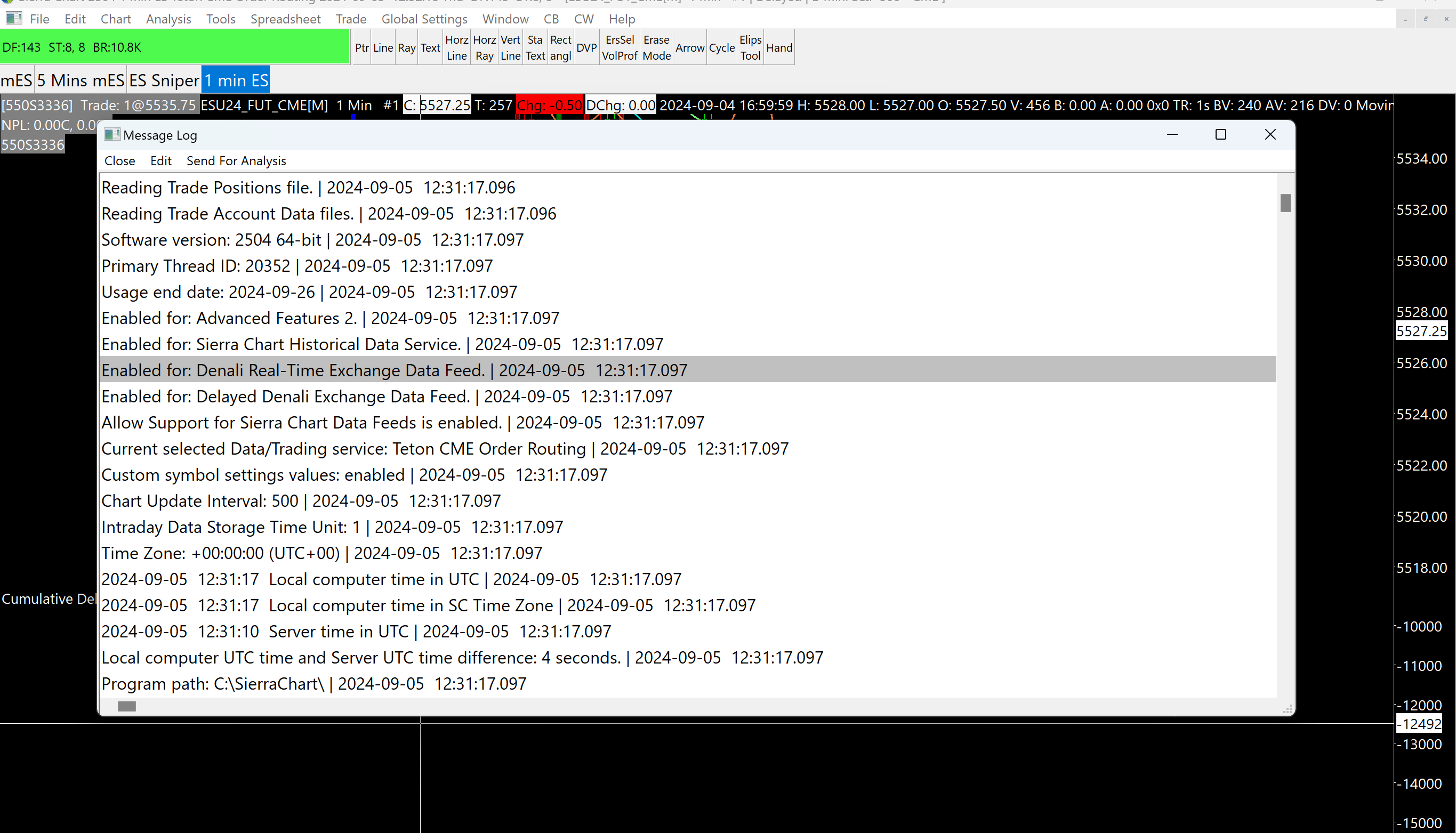

[2024-09-05 12:55:11]
User802880 - Posts: 7
Good morning,
I still have a 10 min delay. I don't see what I am missing. I did the re-activations and reset.
My Message log says, "Real-time data is enabled", but still have delay.
Thanks.
imageScreenshot 2024-09-05 075232.png / V - Attached On 2024-09-05 12:54:13 UTC - Size: 238.43 KB - 143 views
[2024-09-05 15:15:51]
The statement in your log for "Enabled For: Denali Real-Time Exchange Data Feed" means that you are on one of the Integrated packages. It does not mean that you have any exchanges active. If you did, you would see the specific exchanges that you have active in the log.
The reason you are not getting real-time data, is that you do not have any exchanges active. It looks like the exchange you had active did not renew on September 1, 2024. You can activate the exchange at the following link:
https://www.sierrachart.com/UserControlPanel.php?page=DenaliDataFeed#Exchanges
