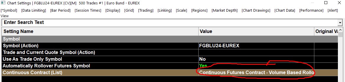

[2024-08-16 18:29:10]
Does not make sense. There must be some reason for this that we are not aware of. Possibly it is related to back adjustments to the continuous futures contracts. Disable the Continuous Futures Contract option on the chart.:
Chart Settings: Continuous Contract (Chart >> Chart Settings >> Symbol >> Symbol menu)

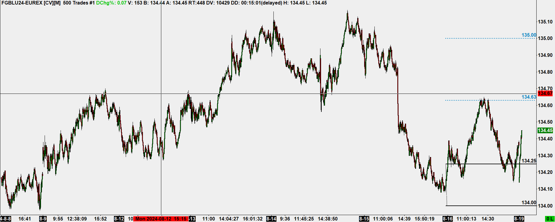

[2024-08-19 06:32:43]
User634406 - Posts: 48
As said, I'm not using back adjustment. Please see the screenshots.
https://www.sierrachart.com/image.php?Image=1724048676585.png
In the chart screenshot, you can see what I'm talking about.
When I plotted the Fib tool, the upper line was at 134.16, lower at 134.05. That was on Friday. This morning, when I checked this chart, it re-plotted itself.
Any idea what is causing this?
