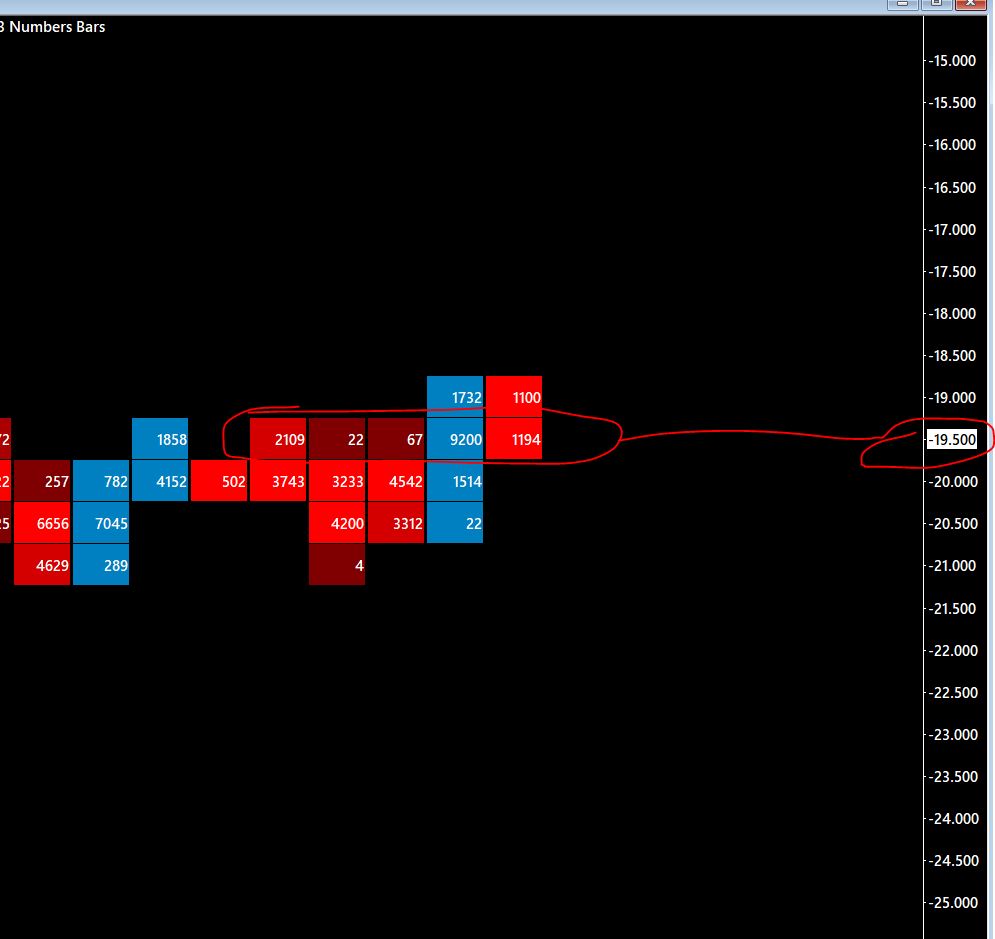

Please refer to the attached pic, how can one sum up the volume at price for Number Bars for x number of periods? So for example, at the price of -19.50, how can one get look back to 5 volume bars with volume of 1194, 9200, 67, 22, and 2109 summed up all for the price at -19.50?
imageSC_sumExample.JPG / V - Attached On 2024-08-07 10:29:32 UTC - Size: 56.8 KB - 273 views

You need to use the "Spreadsheet Formula" study along with the VAP() function for Alerts. Despite its name, the Spreadsheet Formula uses the Alert syntax. Refer to the following:
Spreadsheet Formula
Study/Chart Alerts And Scanning: Special Functions
Therefore, to sum the last 2 total volumes for the price of -19.50, your formula would be the following:
=VAP(-19.50, 0) + VAP(-19.50, -1)
We'll let you work out the full formula for 5 bars.
