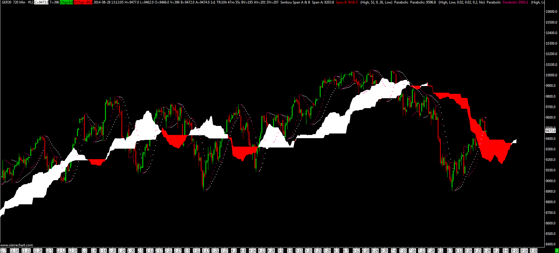

Span A and B....how can I make the candle be seen as it passes through the filled span?

how can I make the candle be seen as it passes through the filled span? http://www.sierrachart.com/image.php?l=1409245947226.png

F6>>Settings>>Subgraphs>>Draw Style and change Span A to Fill Rect Top and Span B to Fill Rect Bottom.

You can also tick the box 'Draw Study Underneath Main Price Graph' on the Settings and Inputs tab for each study that needs it.

You need to set the study to be drawn underneath the main price graph. Here is the documentation for that:
https://www.sierrachart.com/index.php?page=doc/doc_ChartStudies.html#DisplayStudyUnderMPG
