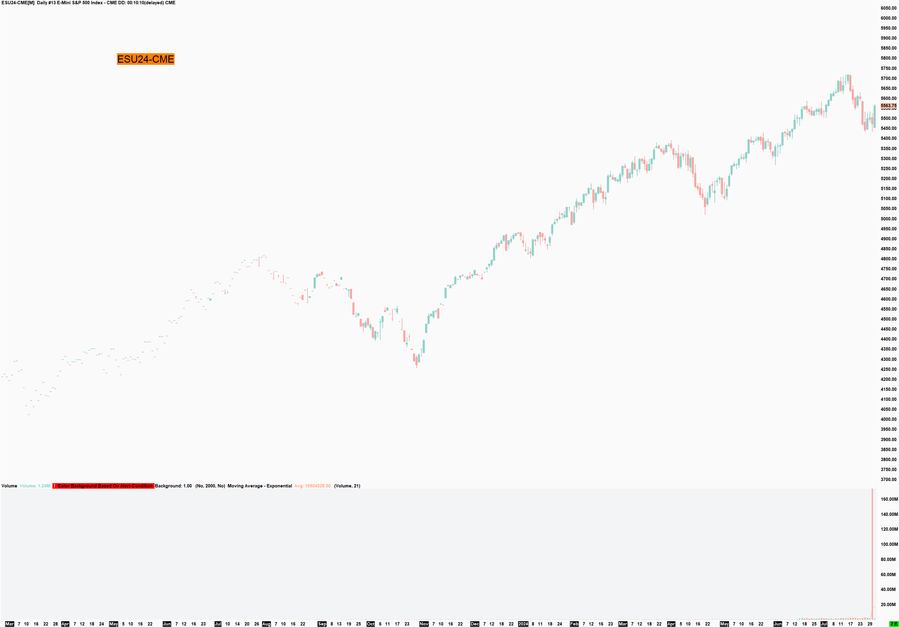

I have the same issue for yesterdays volume, even though I only have one Sierra install. However, the same issue seems to be with ES, YM, NQ and RTY futures (haven't tried any other ones). I checked both continuous futures contracts chart and the latest ones (e.g. ESU24) - they all look like the screenshot attached below. The "Delete all data and download" nor "Reload and Recalculate" made no difference. Thank you in advance for advice Screenshot: https://www.sierrachart.com/image.php?Image=1722449814589.png |

Our data provider says they have corrected this problem for ES futures. Re-download the data: Data Errors or Spikes in Charts, Flat or Flat Line Graph, Compressed Graph, Errors with Date/Time Values: 2.2.2: Correcting Data Errors by Downloading the Data Again Sierra Chart Support - Engineering Level Your definitive source for support. Other responses are from users. Try to keep your questions brief and to the point. Be aware of support policy: https://www.sierrachart.com/index.php?l=PostingInformation.php#GeneralInformation For the most reliable, advanced, and zero cost futures order routing, use the Teton service: Sierra Chart Teton Futures Order Routing Date Time Of Last Edit: 2024-07-31 19:39:11
