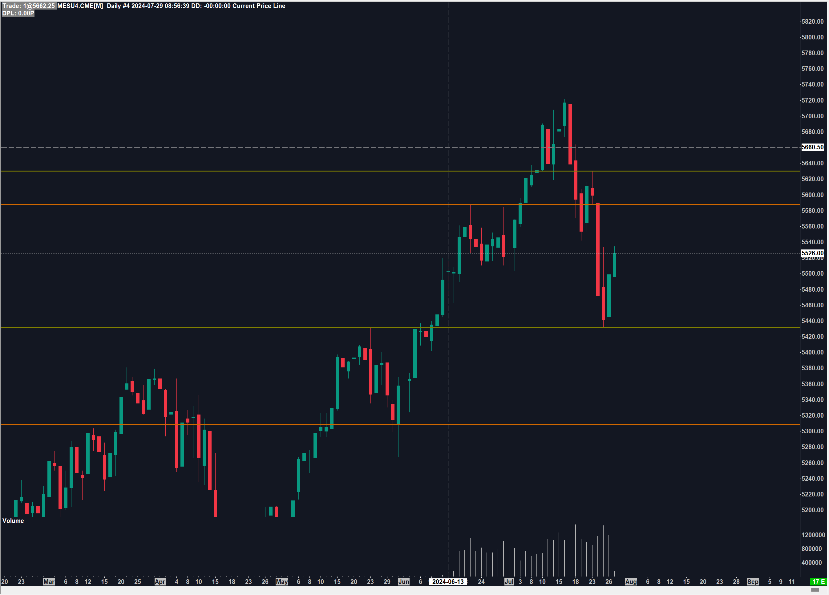

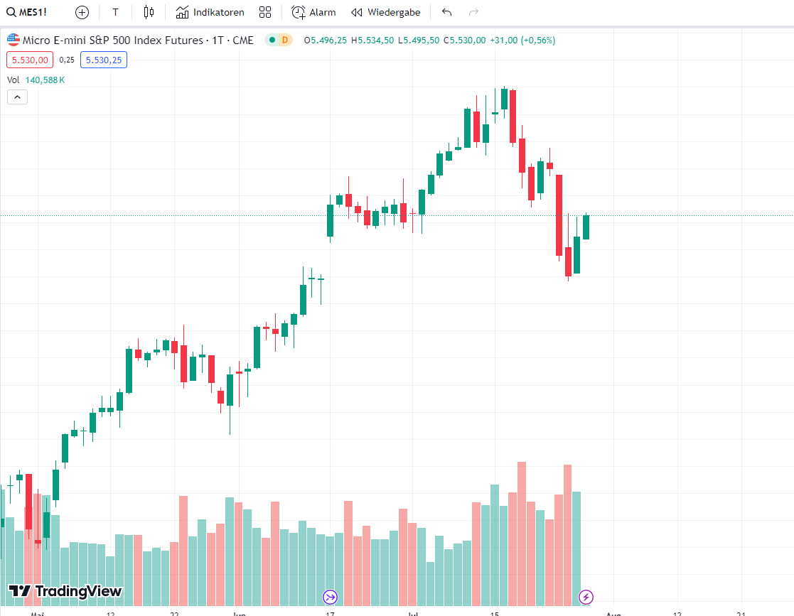

Hello, I have the problem that my data on the chart is “adjusted” but I don't want that. I have already found the point Edit->Adjust but apparently I can't change much there either
For example when I look at my daily chart I don't see any gaps because the data is adjusted immediately which is very bad bc i trade a other chart if its like this.
When I click on “Adjust Data” on Tradingview, the chart looks the same. It must be because of that. How can I make the “Unajusted” so that they are the same as on Tradingview?
imageScreenshot 2024-07-29 145643.png / V - Attached On 2024-07-29 13:09:48 UTC - Size: 87.23 KB - 193 views

The data is not "adjusted" or modified in any way.
We think what you are looking for is the "Continuous Futures Contract" option, in which you would select one of the options without "Back Adjustment". The chart you are showing in Sierra Chart is not a continuous futures contract, so it is only the data from the U 2024 contract for MES. Refer to the following:
Continuous Futures Contract Charts
Also, make sure you remove any adjustments you may have made to the data.
