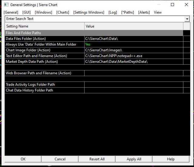

[2024-12-12 16:16:33]
Elcondorspasa1445 - Posts: 3
I did and No the .TWConfig I do not have that folder there. See attached. See screenshot. Should re-install?
image1.JPG / V - Attached On 2024-12-12 16:16:00 UTC - Size: 62.18 KB - 215 views
[2024-12-12 17:39:57]
Do not reinstall anything. That is not necessary.
So you do not have a folder at the location of "C:\SierraChart\Data"?
