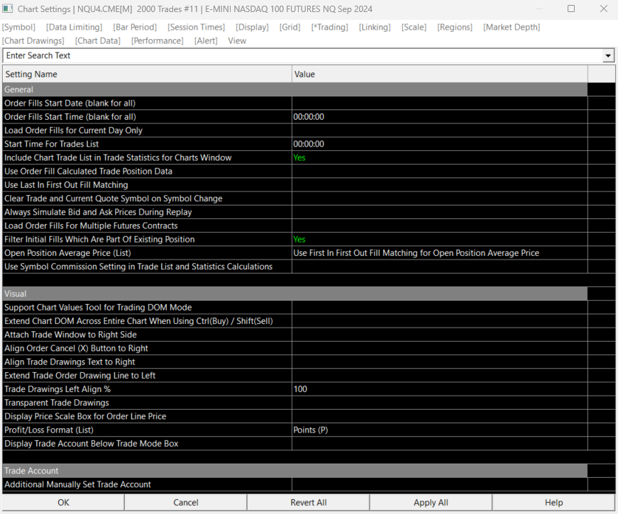

Dear SC,
Last week I had several days with trade execution errors and then DPL started displaying incorrectly. I updated to the current version on Friday and so far no execution issues, but the DPL is still incorrect except on one account. However, all my settings are the same on all my charts. I never touched these settings. Here are a few screenshots. At the time of this screenshot, I believe I was up $20 or something, but it shows 57 pts on NQ. I went through your documentation already and nothing makes sense for why this would happen, except for one account. I appreciate the help.
imageSC INCORRECT PROFIT DISPLAYING.png / V - Attached On 2024-07-08 14:16:13 UTC - Size: 29.87 KB - 282 views
imageSC INCORRECT PROFIT DISPLAYING2.png / V - Attached On 2024-07-08 14:16:18 UTC - Size: 201.56 KB - 281 views

I already wrote I read all your documentation. Don't you guys read our threads? I saw another thread like this where all you guys did was give the guy the same "Refer to the following"...This is flat out abnormal. I never touched anything and all of a sudden the DPL is not accurate except on one account. Your documentation does not address this.
