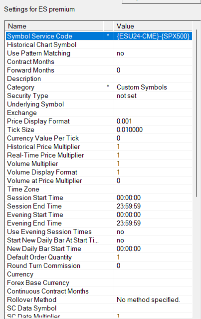

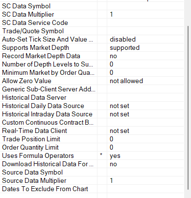

Could you please tell me what is wrong with my settings to see the premium of ES over Cash?
imageScreenshot 2024-07-01 140224.png / V - Attached On 2024-07-01 18:09:42 UTC - Size: 28.01 KB - 186 views
imageScreenshot 2024-07-01 140322.png / V - Attached On 2024-07-01 18:10:24 UTC - Size: 18.29 KB - 246 views
[2024-07-01 22:01:52]
You have the Symbol setup with "Premium ES" as the symbol. You can not do this. The Symbol must be the actual formula you want, so the symbol itself will be the following:
{ESU24-CME} - {SPX500}
Leave the "Symbol Service Code" blank.
