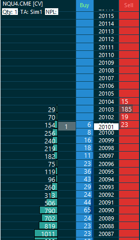

Hello, starting a couple days ago my NQ dom randomly started not displaying the resting ask orders correctly. all my other 7 doms look OK so my guess is that it's something to do with my settings but I can't find anything I might have accidentally changed.
This is what I've tried so far:
1. uncheck use custom symbol settings values in global symbol settings, then use update from server button
2. edit-> delete all data and download
3. manually reset all NQ symbol settings under chart settings and also under global symbol settings
4. update to latest version of SC
This is what I modified in symbol settings (both in chart settings and global symbol settings). note if I switch everything back to default it displays incorrectly in a different way
-price display format to "1"
-tick size to "1.0"
-market depth combine increment in ticks to "1"
This is only affecting my Topstep account, for which I use denali data but route through rithmic per this forum post: Understanding Sierra Chart with Topstep
If I connect to my data feed through Amp and keep all the symbol settings the same the NQ dom works as it should. so my best guess is it's just some hiccup with rithmic but I'm not sure if there is anything that can be done to fix it. the curious thing is sometimes when I disconnect and reconnect to the rithmic data feed, it will display completely fine but after 10 seconds then will go back to being screwed up
NQ DOM compressed
https://www.sierrachart.com/image.php?Image=1719582248506.png
NQ DOM uncompressed
https://www.sierrachart.com/image.php?Image=1719582301238.png
attachmentJigsaw DOM.Cht - Attached On 2024-06-28 15:23:26 UTC - Size: 33.34 KB - 467 views

Hi John, thanks for the reply. Sorry if this wasn't clear, but the "NQ dom uncompressed" image from the original post is what my dom looks like when those 3 chart settings are set as you requested
NQ DOM uncompressed

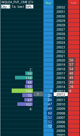

That's correct, it's only messed up when I'm connected to Rithmic. The message log below is for instance 4, but I have the same problem across all instances.
Symbol with error in message log is NQU4.CME
Here is a picture of my NQ compressed DOM when connected to my AMP/Teton data feed. looks as it should
https://www.sierrachart.com/image.php?Image=1719599536484.png

[2024-06-29 08:57:58]
You cannot do this for the Global Symbol Settings
-tick size to "1.0"
Change the Global Symbol Settings for that symbol back to the default. You are creating the issue by changing the settings. You can simply cannot do this at all . Otherwise, you are creating a problem that you are. We cannot provide any further help.
Date Time Of Last Edit: 2024-06-29 15:22:32
