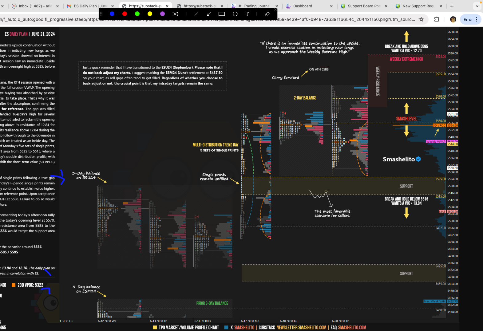

I would like to have a simaler visual like this below (How he Has ESU up & the prior contract) Any way I can go about this?
imageScreenshot 2024-06-24 at 3.26.01 PM.png / V - Attached On 2024-06-24 19:26:16 UTC - Size: 604.38 KB - 303 views

Thanks, though I mean how hes able to have both the ESU24 and the ESm24 up simultaneously
(notice how ESM2024 is in a more transparent draw style) but he still has both up.

User175101 - Posts: 8
He is using the September contracts, but still has ESM24 up on the same chartbook

Our guess is the magic of "Cut/Paste". In other words, there is not a way to have a chart exactly as they have it shown.
If you want to continue to see the ESM24 data from before the rollover in an ESU24 chart, then this would be done by using a Continuous Futures Contract Chart option. Refer to the following:
Continuous Futures Contract Charts
