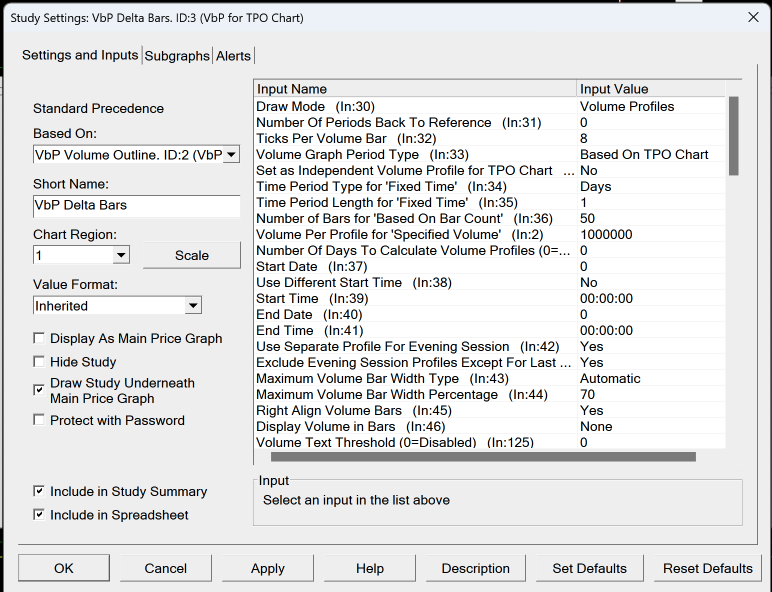

cmack1011 - Posts: 201
Here is a screen shot of my VbP settings though I am not wedded to any of them necessarily.
