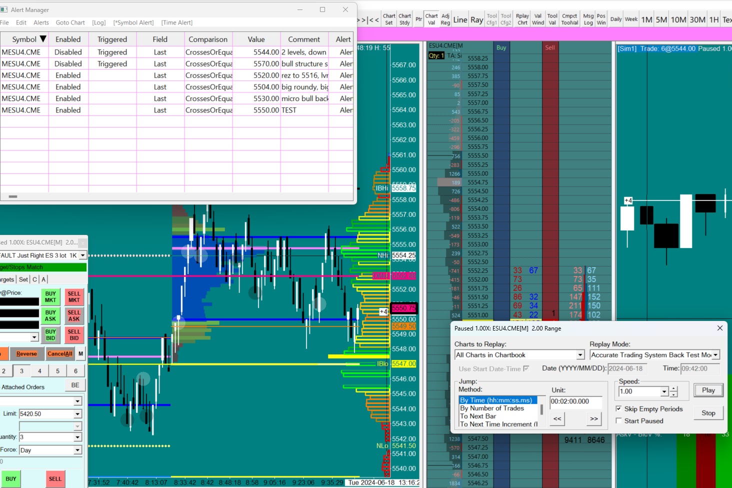

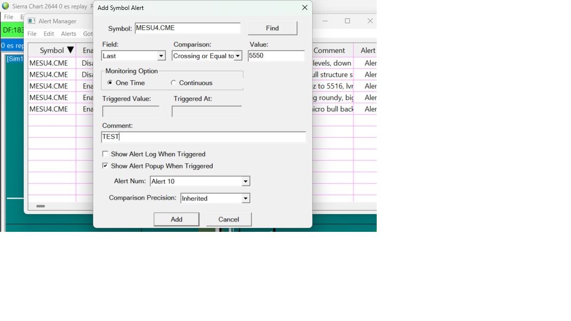

[2024-06-20 18:19:38]
WhammyTrading - Posts: 14
g'day, thanks for the response. Yesterday I did a replay of ES for june 18th a.m., setting various price level alerts to confirm it still isn't signaling, yet ensuring alerts are on, price gets hit and no audio alert is witnessed. Next time I get an orphan I'll try to trap and report it, but I always use attached orders and OCO groups entering thru the trade window... I attempted to upload the 3 images related, software would only accept 2... basically price 5550 gets passed and alert doesn't trigger...
image062024 sierra chart pre replay.jpg / V - Attached On 2024-06-20 18:18:16 UTC - Size: 536.59 KB - 237 views
image062024 sierra chart pre replay 2.jpg / V - Attached On 2024-06-20 18:18:23 UTC - Size: 104.05 KB - 176 views

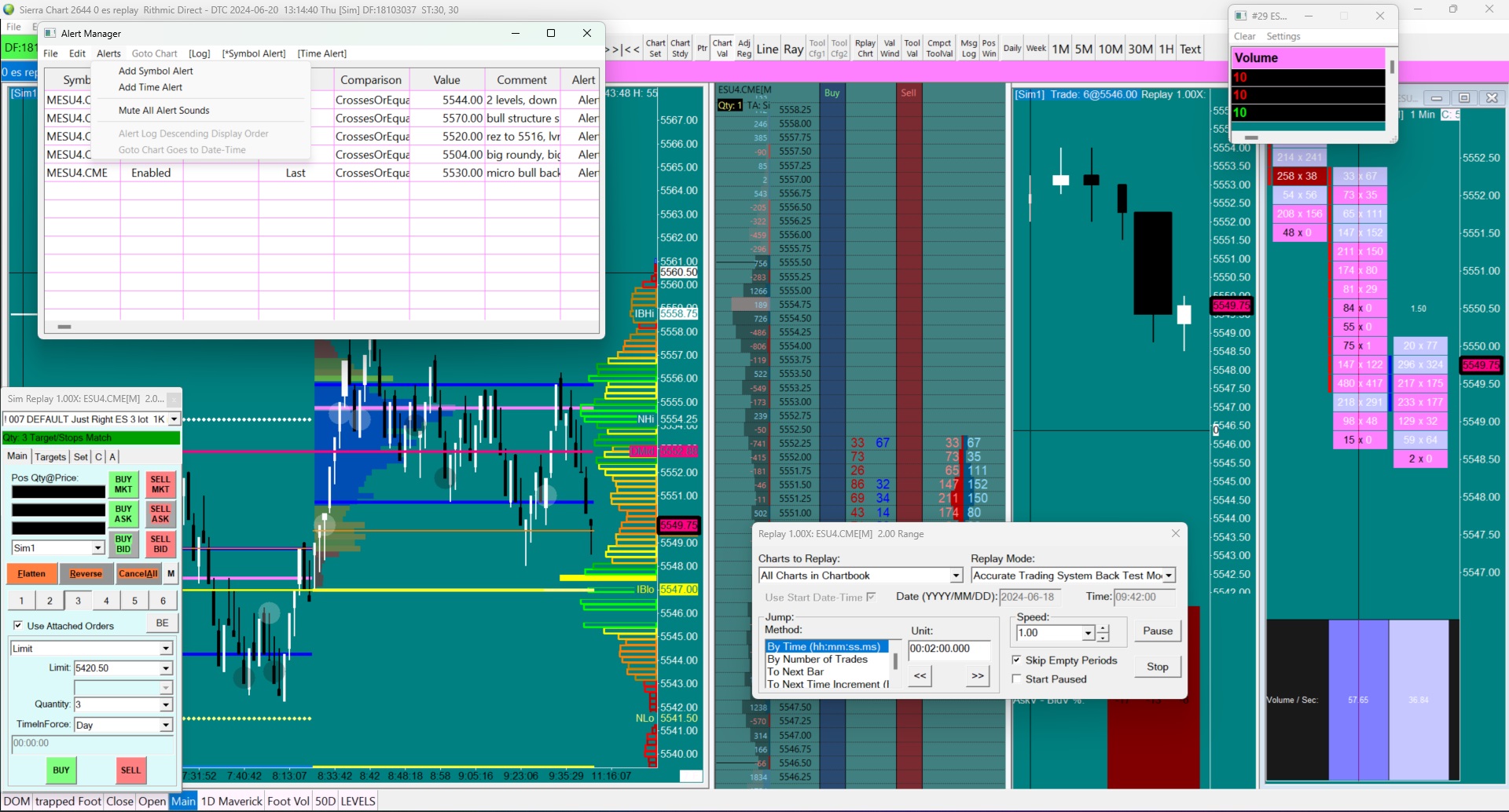

[2024-06-20 18:20:42]
File attached
image062024 sierra chart pre replay 3.jpg / V - Attached On 2024-06-20 18:20:21 UTC - Size: 413.34 KB - 236 views
[2024-06-20 19:33:47]
Sorry, we were not thinking of the "Symbol Alerts" when we stated that Alerts work in replay. The Symbol alerts do not, as these use the Current Quote Data from the data feed. Refer to the following:
Alerts Manager: Symbol Alerts
The standard "simple alerts" and drawing alerts do work during a replay.
