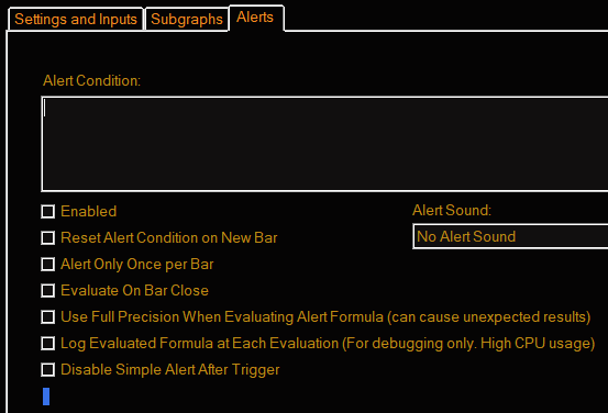

[2024-06-25 11:37:36]
Phidias Trésor - Posts: 2
Thank you very much for your response, I will monitor this closely. I have another question (I don't know if this is the right place to ask it)
- In the 'Condition Alerts' options, is it possible to add the 'disable for the day after trigger' option?
I also noticed that you added the 'flatten' option in the 'trading system based on altert condition' option, it's excellent, thank you very much!
imagee.PNG / V - Attached On 2024-06-25 11:35:21 UTC - Size: 12.88 KB - 241 views
[2024-06-25 15:44:03]
There is not a way to disable trading through an alert condition.
It sounds like the "Global Profit/Loss Management" feature will have what you are looking for. Refer to the following:
