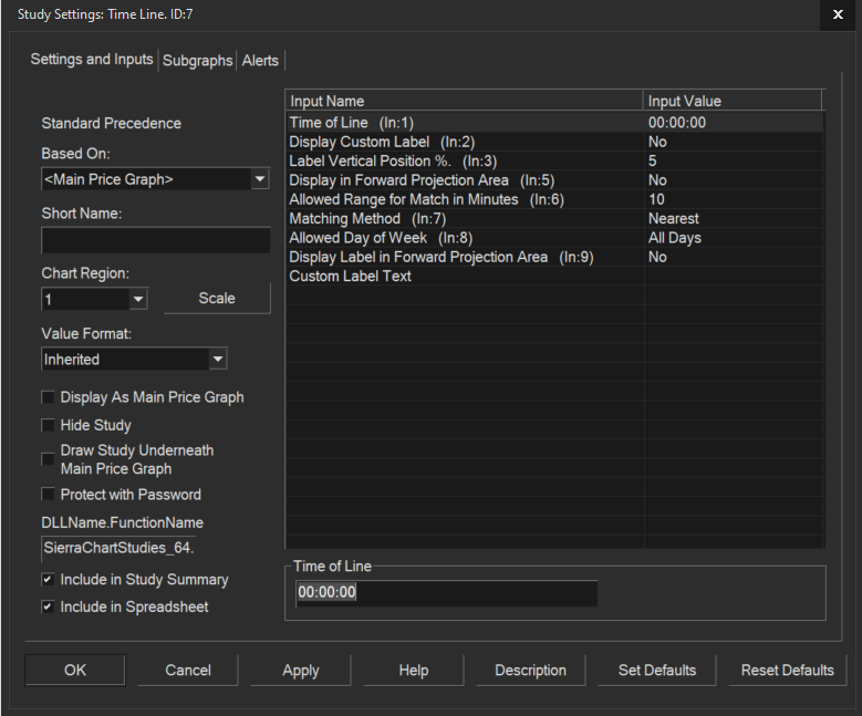

I want the line to draw at 00:00:00 so the start of each day, but it is not showing.
I have attached the settings for the indicator.
imageCapture.PNG / V - Attached On 2024-06-18 13:41:58 UTC - Size: 105.11 KB - 200 views

We need to see an image of the chart showing the time where the line should be (i.e. 00:00:00). Follow these instructions to get us the image:

I found out the issue.. Session starts at 04:00:00 for most tickers. Therefore there would be no line otherwise. I just simply entered 00:00:00 as a point for the start of the day. Maybe an option to "snap" to start of day for the indicator? Different exchange times/trading hours would affect this, I believe.

I checked that and I have the start time set to 00:00:00
An issue with this is if no trades occur on a ticker the time 00:00:00 will not be generated on the chart and therefore sometimes the Time Line will not be drawn at all.

Yes, so there are days on the chart where there are no vertical lines with this indicator. The problem using the default chart grid option is the horizontal and vertical lines are stuck to one color. This isn't the effect I was aiming for :)

The Input for "Allowed Range for Match in Minutes" is a way to give a wider range for the system to place the line at a bar other than the exact time entered. You may need to increase this value if there is a period of no trading at the entered time. Refer to the following:

I went as far as 100000 for the Allowed Range for Match in Minutes it still wont draw the line on certain days where the first trade occured @ 6:55

We are not seeing any issues with this.
Please get a chart that shows the issue and tell us the date for one of the locations where this is not working for you. Refer to the following for how to get us the chart:
