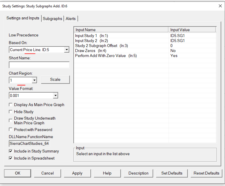

User560704 - Posts: 17
Thanks, however, there is not a 'amount to add' section on the subgraph, can you advise where to find this?
I attempted to upload a screenshot, however that seems to be quite a process. thanks
imagesubgraph1.PNG / V - Attached On 2024-06-13 10:55:28 UTC - Size: 30.77 KB - 228 views

John - SC Support - Posts: 48584
You are using the "Study Subgraphs Add" and not the "Study Subgraph Add". The 's' in Subgraph(s) makes all the difference.
