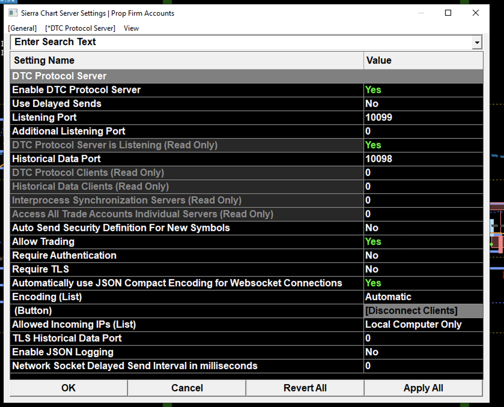

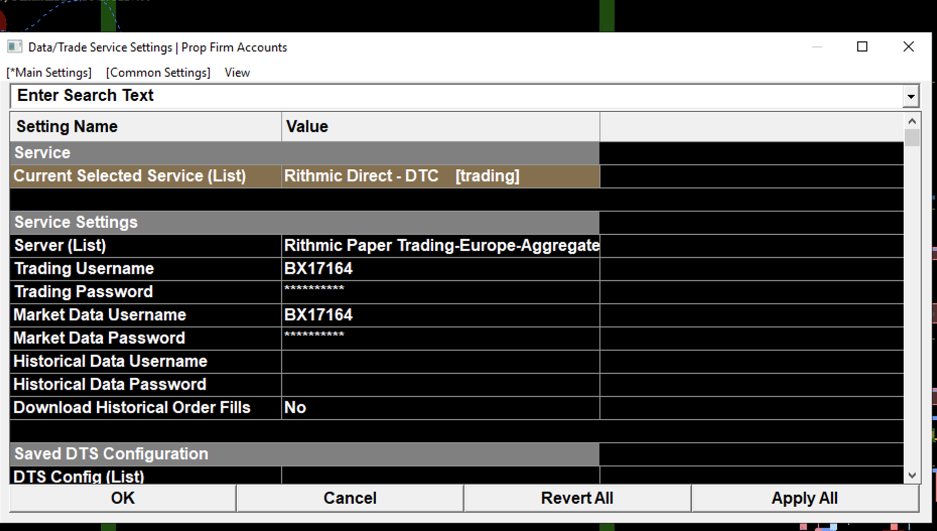

[2024-06-13 08:15:34]
User129860 - Posts: 33
thanks Support.
So I tried to setup following the instruction. The main installtion where it using data feed from Denali exchange works as expected.
However the one from Bulenox trading firm seem can not get realtime data.
Here is my screenshot of setting
Here is logs from MessageS:

[2024-06-13 12:37:01]
Hi Support,
new update. I think this is something with the chart template Im using, I tried another chart and all seem works fine. some other chart not able to get realtime data.

2024-06-13 12:43:02.358 | Current selected Data/Trading service: Rithmic Direct - DTC
2024-06-13 12:43:02.358 | Custom symbol settings values: enabled
2024-06-13 12:43:02.358 | Chart Update Interval: 400
2024-06-13 12:43:02.358 | Intraday Data Storage Time Unit: 0
2024-06-13 12:43:02.358 | Time Zone: +00:00:00 (UTC+00)
2024-06-13 12:43:02.358 | 2024-06-13 12:43:02 Local computer time in UTC
2024-06-13 12:43:02.358 | 2024-06-13 12:43:02 Local computer time in SC Time Zone
2024-06-13 12:43:02.358 | 2024-06-13 09:11:05 Server time in UTC
2024-06-13 12:43:02.358 | Local computer UTC time and Server UTC time difference: 1 seconds.
2024-06-13 12:43:02.358 | Program path: D:\SierraChart-FutuProp\
2024-06-13 12:43:02.358 | Data Files path: D:\SierraChart-FutuProp\Data\
2024-06-13 12:43:02.359 | OS Version Number: 10.0
2024-06-13 12:43:02.359 | Locale Setting: C
2024-06-13 12:43:02.359 | DLLs: BackTest_64.dll, DeltaAI_64.dll, DetalSignal_64.dll, FVG_64.dll, FVG_and_News_64.dll, Olympus_64.dll, Signal2MT5_64.dll, SKBAIDeepLearning_64.dll, SKBRobot_64.dll, SKBSignalSender_64.dll, SKBSystemRef_64.dll, SKBSytemStudy_64.dll, TDVSystemIDs_64.dll, TimeRange_64.dll, TORobots_64.dll, TraderOracleOLD_64.dll, TraderOracle_64.dll, UserContributedStudies_64.dll, VT_SCTelegramDrawingAlert_64.dll, Zyp Free by Zyp_64.dll
2024-06-13 12:43:02.359 | Allowed protected custom studies: SignalAlert, SignalBackTest, SKBRobotAI, SKBSignalSender, SKBSystemRef, SKBSystemStudy, SKBTradingSystem, TDVSystemIDs
2024-06-13 12:43:02.359 | Crash reporter started: true
2024-06-13 12:43:03.585 | Rithmic Direct - DTC | Using server connection: Rithmic Paper Trading-Europe-Non-Aggregated
2024-06-13 12:43:03.585 | Rithmic Direct - DTC (Data) | Connecting to the server rsc-ie.rithmic.com. Port 40801
2024-06-13 12:43:03.585 | DTC Client socket (3) | Creating socket. Using TLS 1.2.
2024-06-13 12:43:03.586 | DTC Client socket (3) | New receive buffer size: 0
2024-06-13 12:43:03.586 | DTC Client socket (3) | Connecting to IP: 34.251.179.156.
2024-06-13 12:43:03.603 | Rithmic Direct - DTC (Data) | Network connection to server complete.
2024-06-13 12:43:03.603 | Rithmic Direct - DTC (Data) | Starting socket receive thread.
2024-06-13 12:43:03.603 | Rithmic Direct - DTC (Data) | Setting DTC encoding to Binary
2024-06-13 12:43:03.603 | Rithmic Direct - DTC (Data) | Sending logon request message.
2024-06-13 12:43:03.757 | Rithmic Direct - DTC (Data) | Received logon response.
2024-06-13 12:43:03.757 | Rithmic Direct - DTC (Data) | Server Name: .
2024-06-13 12:43:03.757 | Rithmic Direct - DTC (Data) | Server protocol version: 8. Client protocol version: 8
2024-06-13 12:43:03.757 | Rithmic Direct - DTC (Data) | Successfully connected.
2024-06-13 12:43:03.757 | Rithmic Direct - DTC (Data) | Trading is not supported.
2024-06-13 12:43:03.757 | Rithmic Direct - DTC (Data) | Symbol and Exchange Delimiter: .
2024-06-13 12:43:03.757 | Rithmic Direct - DTC (Data) | MarketDepthIsSupported: 1
2024-06-13 12:43:03.757 | Rithmic Direct - DTC | Using primary service for historical data for GCQ24-COMEX
2024-06-13 12:43:03.757 | Historical data service client indicated that downloads are not enabled. Symbol: GCQ24-COMEX. Data Type: Intraday data.
2024-06-13 12:43:03.757 | Historical data download ID 3990 not found when removing ID from outstanding request set.
2024-06-13 12:43:03.757 | Real-time Intraday chart data file updates started for GCQ24-COMEX
2024-06-13 12:43:03.757 | Intraday chart data file opened for GCQ24-COMEX
2024-06-13 12:43:03.757 | Rithmic Direct - DTC (Data) | Restarting real-time data updates for symbol: GCQ24-COMEX
2024-06-13 12:43:03.775 | DTC Client socket (3) | Socket gracefully closed by remote side.
2024-06-13 12:43:03.775 | DTC Client socket (3) | CloseSocket call.
2024-06-13 12:43:03.775 | DTC Client socket (3) | Graceful close received or receive error. Shutdown complete. Closing socket now.
2024-06-13 12:43:03.775 | DTC Client socket (3) | Closed.
2024-06-13 12:43:03.775 | Rithmic Direct - DTC (Data) | Waiting for socket receive thread to end
2024-06-13 12:43:03.776 | DTC Client socket (0) | CloseSocket call.
2024-06-13 12:43:03.776 | Rithmic Direct - DTC (Data) | Disconnected from the server.
2024-06-13 12:43:03.776 | Rithmic Direct - DTC (Data) | Data feed disconnected. Will reconnect in 2 seconds.
2024-06-13 12:43:05.773 | Rithmic Direct - DTC | Using server connection: Rithmic Paper Trading-Europe-Non-Aggregated
2024-06-13 12:43:05.773 | Rithmic Direct - DTC (Data) | Connecting to the server rsc-ie.rithmic.com. Port 40801
2024-06-13 12:43:05.773 | DTC Client socket (3) | Creating socket. Using TLS 1.2.
2024-06-13 12:43:05.773 | DTC Client socket (3) | New receive buffer size: 0
2024-06-13 12:43:05.773 | DTC Client socket (3) | Connecting to IP: 34.251.179.156.
2024-06-13 12:43:05.788 | Rithmic Direct - DTC (Data) | Network connection to server complete.
2024-06-13 12:43:05.788 | Rithmic Direct - DTC (Data) | Starting socket receive thread.
2024-06-13 12:43:05.789 | Rithmic Direct - DTC (Data) | Setting DTC encoding to Binary
2024-06-13 12:43:05.789 | Rithmic Direct - DTC (Data) | Sending logon request message.
2024-06-13 12:43:05.935 | Rithmic Direct - DTC (Data) | Received logon response.
2024-06-13 12:43:05.935 | Rithmic Direct - DTC (Data) | Server Name: .
2024-06-13 12:43:05.935 | Rithmic Direct - DTC (Data) | Server protocol version: 8. Client protocol version: 8
2024-06-13 12:43:05.935 | Rithmic Direct - DTC (Data) | Successfully connected.
2024-06-13 12:43:05.935 | Rithmic Direct - DTC (Data) | Trading is not supported.
2024-06-13 12:43:05.935 | Rithmic Direct - DTC (Data) | Symbol and Exchange Delimiter: .
2024-06-13 12:43:05.935 | Rithmic Direct - DTC (Data) | MarketDepthIsSupported: 1
2024-06-13 12:43:05.935 | Rithmic Direct - DTC | Using primary service for historical data for GCQ24-COMEX
2024-06-13 12:43:05.935 | Historical data service client indicated that downloads are not enabled. Symbol: GCQ24-COMEX. Data Type: Intraday data.
2024-06-13 12:43:05.935 | Historical data download ID 3991 not found when removing ID from outstanding request set.
2024-06-13 12:43:05.935 | Real-time Intraday chart data file updates started for GCQ24-COMEX
2024-06-13 12:43:05.935 | Intraday chart data file opened for GCQ24-COMEX
2024-06-13 12:43:05.935 | Rithmic Direct - DTC (Data) | Restarting real-time data updates for symbol: GCQ24-COMEX
2024-06-13 12:43:05.951 | DTC Client socket (3) | Socket gracefully closed by remote side.
2024-06-13 12:43:05.953 | DTC Client socket (3) | CloseSocket call.
2024-06-13 12:43:05.953 | Rithmic Direct - DTC (Data) | Waiting for socket receive thread to end
2024-06-13 12:43:05.953 | DTC Client socket (3) | Graceful close received or receive error. Shutdown complete. Closing socket now.
2024-06-13 12:43:05.953 | DTC Client socket (3) | Closed.
2024-06-13 12:43:05.954 | DTC Client socket (0) | CloseSocket call.
2024-06-13 12:43:05.954 | Rithmic Direct - DTC (Data) | Disconnected from the server.
2024-06-13 12:43:05.954 | Rithmic Direct - DTC (Data) | Data feed disconnected. Will reconnect in 2 seconds.
[2024-06-13 15:24:54]
John - SC Support - Posts: 48584
You are using the wrong symbols for Rithmic. Open the chartbooks and select "Edit >> Translate Symbols to Current Service".
