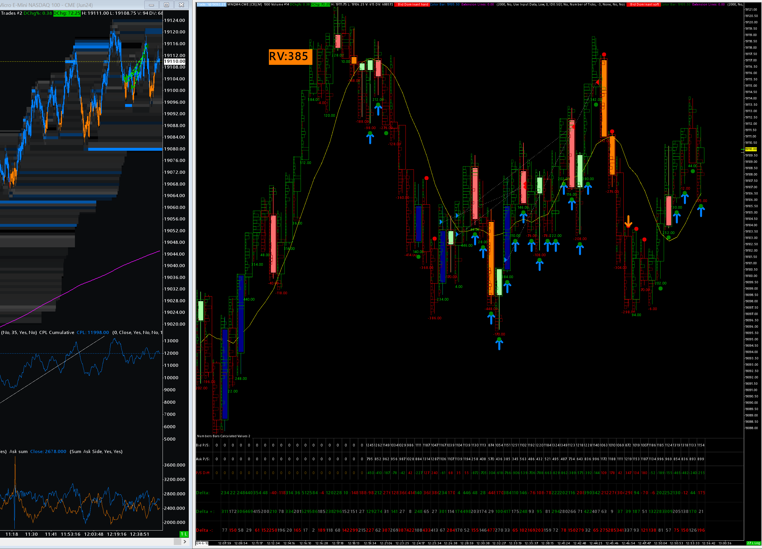

I attached a picture of two charts. Left one is a normal 500 tick chart and the right one is a numbers bar chart. When I change the settings for entry and exit markers in global graphics settings it only applies to the non numbers bar charts. It looks like numbers bars charts have a separate setting for entry and exit markers/line thickness/coloring. Could someone please let me know how I can adjust settings for the numbers bar chart entries and exits? Thank you!
Edit: the entries and exits are harder to see on the numbers bar chart because I have a whole bunch of other things on there. Numbers bars entries and blue and red triangles with dotted grey lines. Normal charts are Green/dark green with dashed line.

There are Global Graphics Settings and Chart Specific Graphics Settings. When a chart is set to use the Chart Graphics Settings, then changes to the Global Grpahics will not change it, and vice versa.
Therefore, from what you are stating, you are either changing the Global Graphics, but the Numbers Bars chart is set to use Chart graphics, or the standard chart is set to use Chart Graphics and you are changing the Chart Graphics for it and therefore it is not applying to the Numbers Bars chart. Refer to the following:
