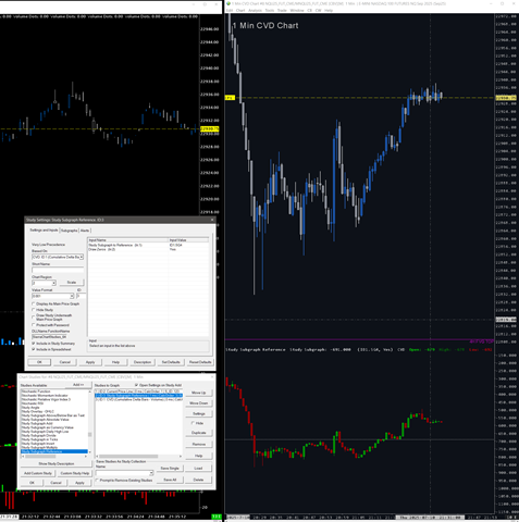

I am also trying to make this work... I want draw a line on Chart Region 2, where I have the Cumulative Delta - Volume study. I am using the "Study Subgraph Reference" study, and it IS drawing a line. But its NOT in the correct spot ( Close )...
Is there something that must be done with the scale to make this work?
see my settings in attached screen shot...notice white dotted line is not in the correct spot.
Anthony

Make sure the scale for that study is set to either "Automatic" or "Same as Region". Refer to the following:
Chart Scale and Scale Adjusting: Opening the Scale Settings Window For a Study
Chart Scale and Scale Adjusting: Scale Range (Scale Settings)

I found the issue...by accident. The "Study Subgraph Reference" must be BELOW the Cumulative Volume study in the studys list for this to work correctly. I thought that was odd. But, it is working.
Anthony
[2025-07-11 18:55:47]
That is also true, as the general order in which the studies are calculated is determined by the order in that list. Refer to the following:
Chart Studies: Study Calculation Precedence And Related Issues
