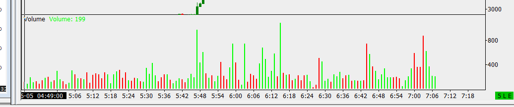

hi, How do I have the outlined on the volume bars attached black as it's difficult to differentiate thanks
imageScreenshot 2024-06-05 120759.png / V - Attached On 2024-06-05 16:14:07 UTC - Size: 7.91 KB - 270 views

The only way to do this would be to add another Volume study and set the colors both to be "Black" and then make the width of those bars 1 or 2 sizes larger than the width of the other Volume bars.
You would then need to make sure that the Black volume study is set to the same region and that it is higher in the list of studies to graph, as that defines the order in which they are drawn, and you want that one to be behind the standard red/green volumes.

where do you set colours both to black? and can you not just set to green and red, with black outline for each volume bar?
[2024-06-05 19:29:48]
Refer to the following regarding the colors:
Chart Studies: Subgraphs Tab >> Color
We do not have a coloring option that gives a black outline. The instructions we gave above are the only way to get what you want.
