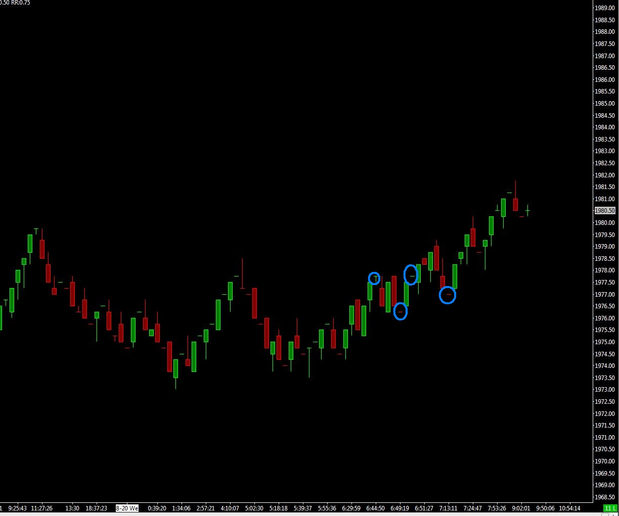

Please see attached screenshot. This is a "Range Per Bar - Standard (in ticks)" chart set to 5. These incomplete bars are only forming on ES charts, no other symbols. I tried deleting and downloading data but that didn't help. Is this likely a data issue? I use Rithmic.
imageES Range.jpg / V - Attached On 2014-08-20 16:12:21 UTC - Size: 186.17 KB - 583 views

Did this but no luck. My range chart on ninjatrader looks ok.

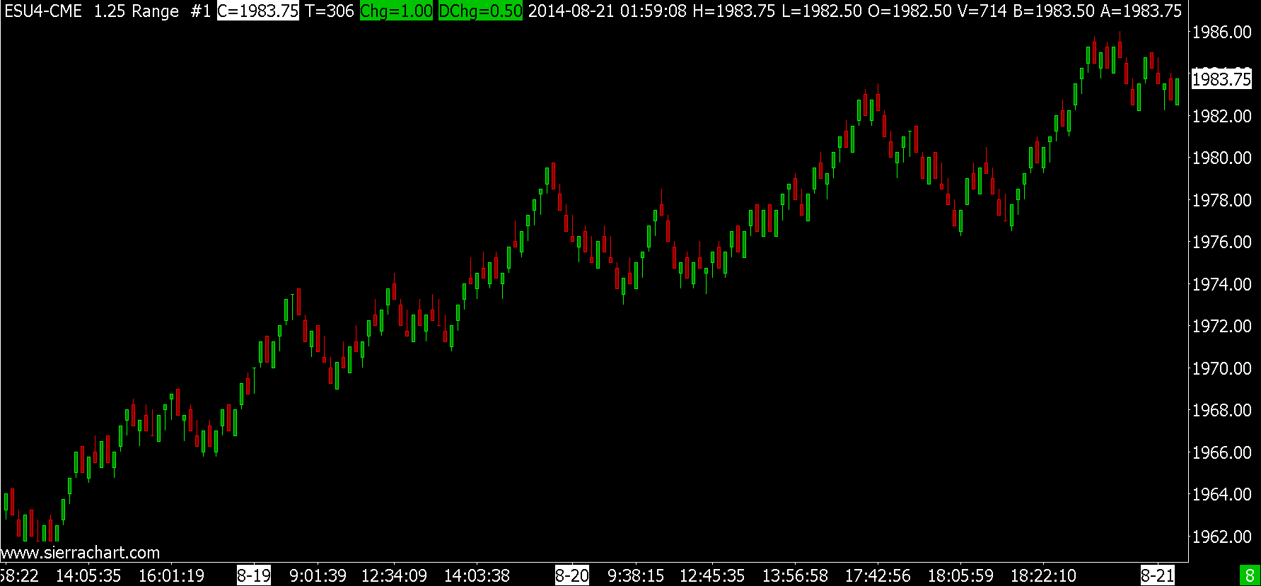

Storage time unit is set to 1 tick. Also, a quick unrelated question, what's the number in green at the far bottom right corner of each chart?
http://www.sierrachart.com/image.php?l=1408575787150.png
