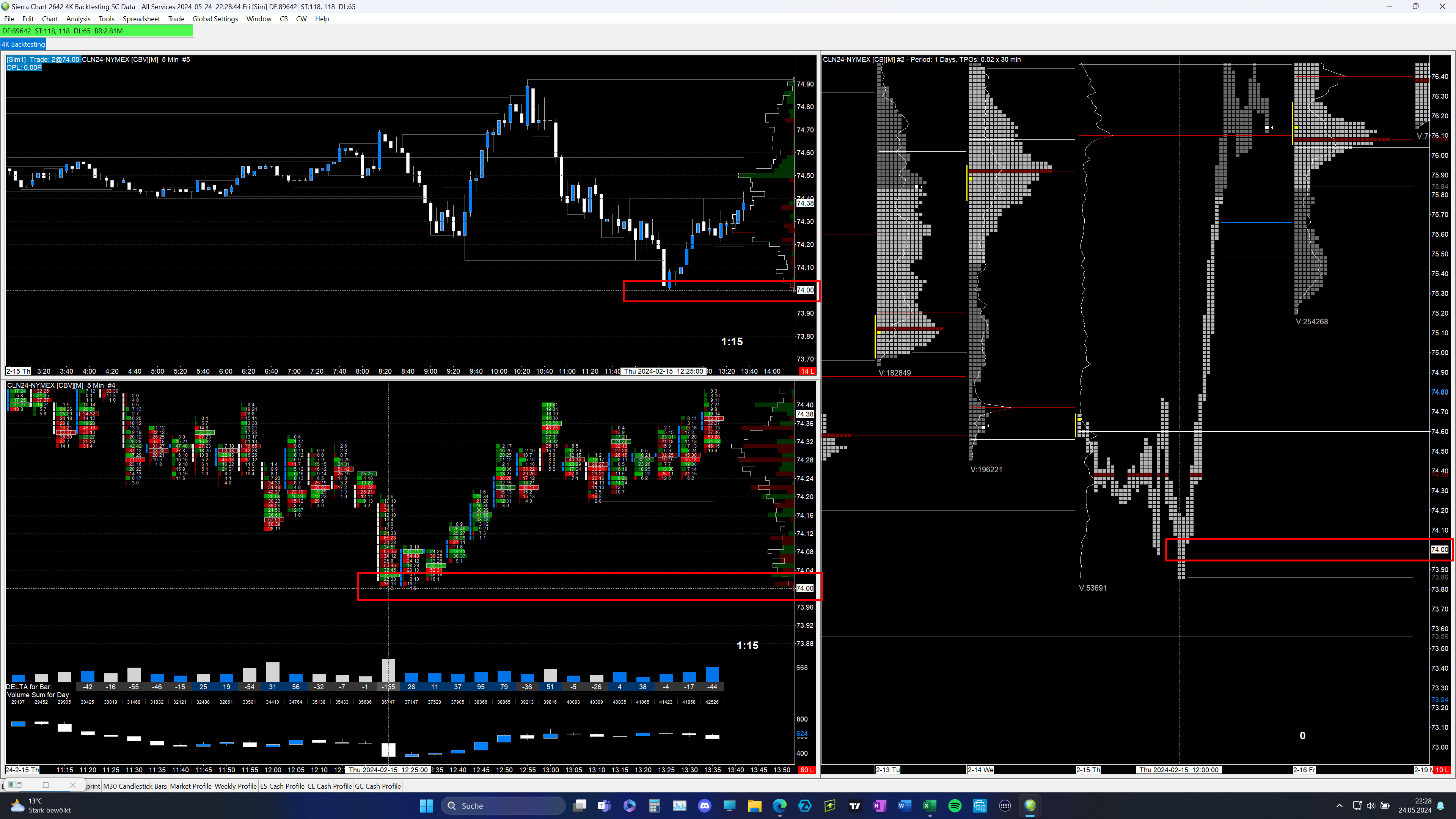

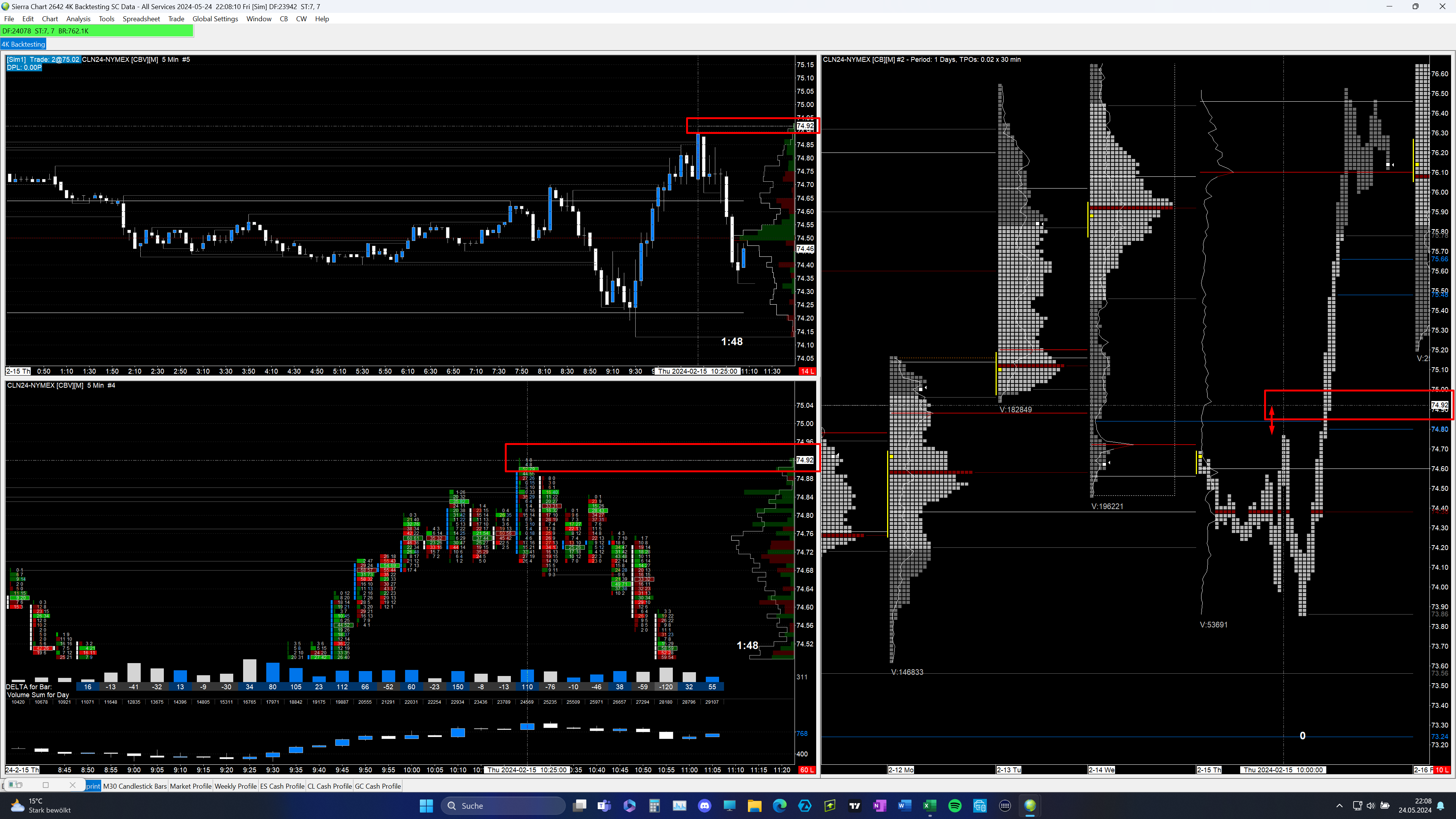

Hello, I still have the problem that my Market Profile is moved. All other charts are correct and agree if you go back in time. Only in the market profile do larger and larger deviations occur. Here are a couple of screenshots attached. Here you can see that the deviation is over 13 ticks. Unfortunately I can't work with something like that. Can you solve the problem? If necessary, you can also log into my PC and troubleshoot the problem. It seems to me that the further back you go, the less precise it becomes. But if I go back with a normal M30 chart, then it also matches all the other charts. I've tried everything imaginable. Please help me.
imageTPO Chart Fehler 2.png / V - Attached On 2024-05-24 21:09:23 UTC - Size: 644.9 KB - 174 views
imageTPO Chart Fehler.png / V - Attached On 2024-05-24 21:09:28 UTC - Size: 635.81 KB - 157 views

Please get us a chartbook with the charts that show this in it. Follow these instructions, except that we need at least 2 charts:

It seems like what you are referring to are back adjustments. Therefore, change the Continuous Contract option and do not use one of the back adjusted options:
Continuous Futures Contract Charts: Continuous Futures Contract Rollover Options
Do not use back adjustments!
