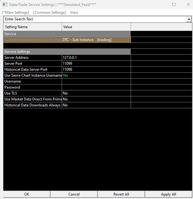

[2024-05-24 08:40:54]
User61576 - Posts: 458
this is my sub instance trader service setup
i think it is directed to the regular SC main instance I have on the same computer

[2024-05-24 14:40:34]
We have no idea what you mean by "Simulated Feed" or how you have this setup.
You are correct that the sub-instance orders (when not in "Simulation Mode" in that sub-instance) are sent to the main instance. So whatever service the main instance is in (including "Simulation Mode"), the sub-instance orders will route there.
[2024-05-24 16:33:06]
I have 2 SC instances on same computer
The 2nd is connected to the simulated feed and working accordingly.
When i try to add to that simulate feed a new sub instance i have in the sub instance the live account while on the on the main instance of the simulated feed i don't (as expected) and i wonder how the sim. Feed sub instance will route if i have the live account there and dont have the account i added in the trade accounts management window
[2024-05-24 19:57:28]
We really do not know what you mean by "Simulated Feed".
But the issue you are having is that sub-instances need to know which main instance to connect to. If you did not change this specifically for having multiple main instances, then sub-instance will connect to whichever instance was started first.
Refer to the following:
Using DTC Server for Data and Trading in Another Sierra Chart Instance: Resolving DTC Protocol Server Port Number Conflicts
