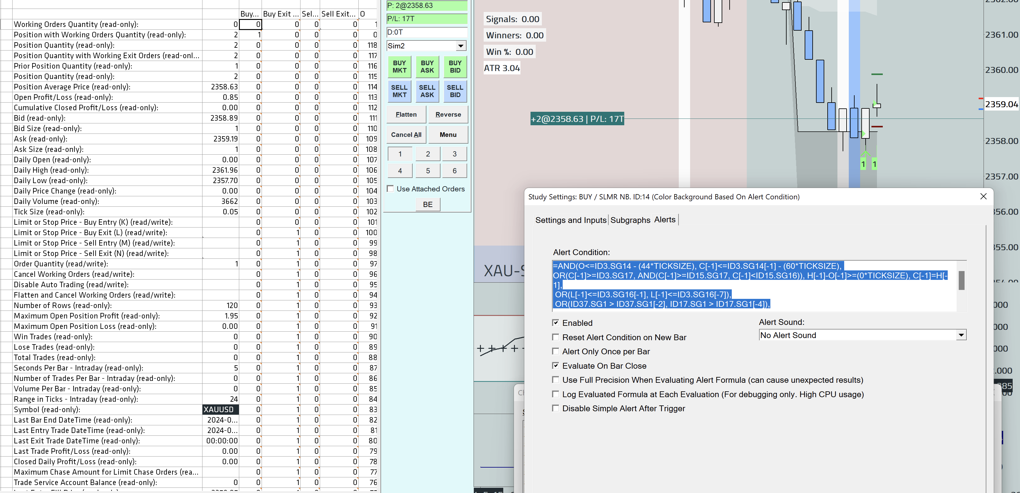

What's the deal with the Spreadsheet System for trading. There are parameters to "Signal on bar close" in about 12 different places. I've spent 3 days trying to get a simple Color Background on Alert Condition to fire only ONCE on bar close, and I can't get it to fire ONCE to matter what I do.
I've poured over the documentation ad nauseam about Signalling options. Look, I literally just want a market order once the bar closes. Not at the beginning of the bar, and not the next bar. Just the bar that closes.
Signal Only Once Per Bar is set to Yes (uses row 4, I know) and Strict Signal Only On Bar Close Evaluation is also set to Yes, Evaluate On Bar Close is checked (set to Yes).
Firing twice should be a strict impossibility. What's going on?
If I use (reference) row 4 and turn off Strict Signal Only On Bar Close Evaluation then I get the two entries as shown in the screenshot.

Thanks for your time and support in responding. The movement of drawings issue SC has known about for years. I literally Locked drawings on a chart today and they bounced a large distance from where they were set after successive bars were printed. Not sure how old the platform is but it would appear to me that that specific & simple issue is not solvable within the current architecture.
I went through all possibilities of the following signalling options that I thought would affect entry behavior using Range bars & Allow Multiple Positions in Spreadsheet System for Trading (SSFT).
Source Alert. Evaluate on Bar Close, CHECKED/UNCHECKED
Trading System Setting. Signal Only Once Per Bar, YES/NO
Trading System Setting. Strict Signal only on bar Close Eval, YES/NO
Row Reference on SSFT. Row 3/Row 4
All (16) combinations were parsed on Replay using the Calculate as Realtime option and all Charts in Chartbook included in Replay. I got to 25 combinations before stopping because I believe I've covered all possibilities with the most logical parameters that would affect behavior (aforementioned). I can also provide an exhaustive list of how they all behave.
The original screenshot shows the signal fires twice. Again, having tried the aforementioned I have no idea why I cannot get it to function as it should.
Also noteworthy is that I am not referencing whether other present Alert signals are = 1 as a constituent of the signal I'm attempting to execute with (which I wouldn't think would matter but wanted to mention); this is a standalone signal that references multiple subgraphs & checks for certain conditions in order to fire in a very typical manner.
I'm simply looking for what parameter settings are needed in order to have it function as it should or else be told definitively that the functionality I am looking for does not currently exist & that logically I would be in the camp of hiring an ACSIL programmer for project work.
I hope this has provided clarification to the topics considered above. Thanks!
