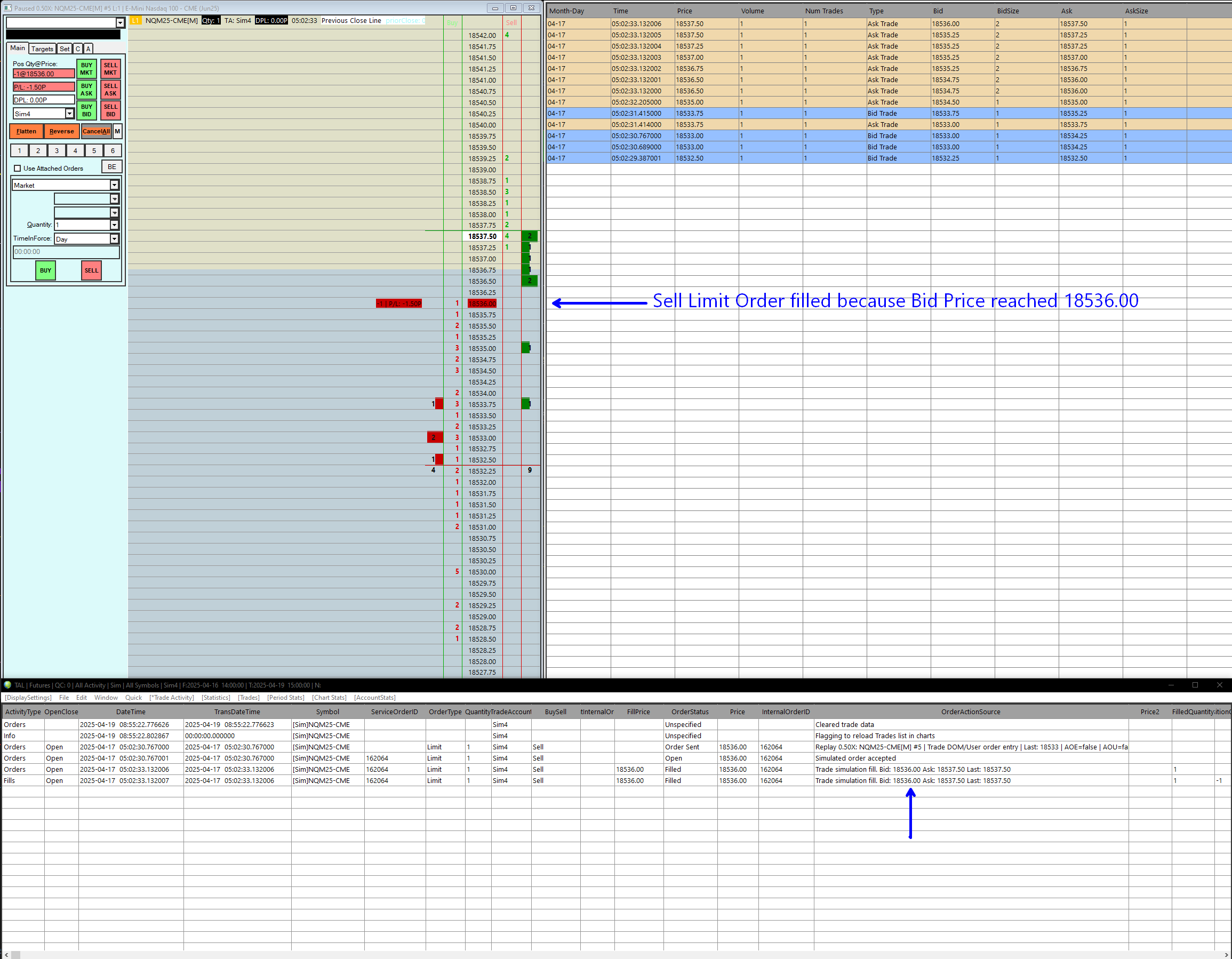

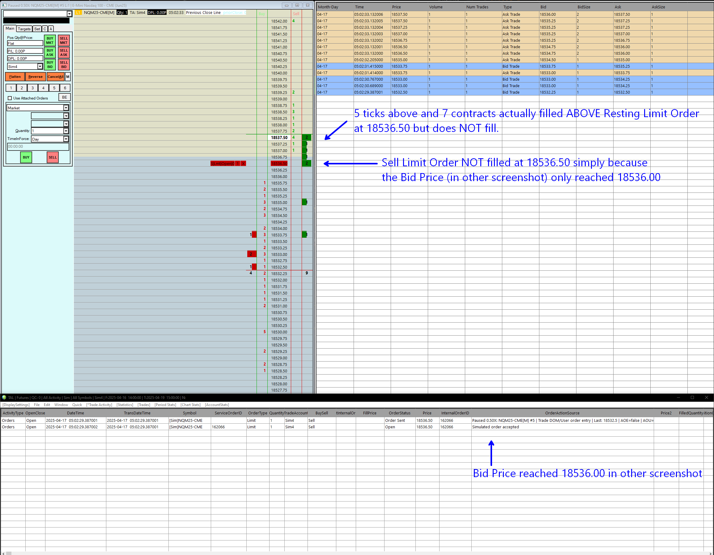

See attached this morning I had a limit order of 2 contracts. 8 contracts traded at limit price (denali/sim) then price moved PAST my limit order by 1 tick and the sim order still didn't fill. Unrelated (Rithmic/CQG does fill those orders at that price this is why I need a solution)
I'm only talking about Denali feed running sim to keep it simple. As you mentioned I would like the ENTIRE full sim quantity filled as soon as a single lot trades at that limit price.
What I need is ability to Fill Entire Order on Last Trade Price. If 1 lot trades execute entire Limit Order regardless of size traded at that price.
See attached images this should clarify.

[2024-05-13 19:14:55]
What you are describing in post #5, is not about partial fills. It is something completely different.
Unless we know what the bid and ask prices are, we cannot answer this. But basically the bid price never moved up to the sell limit price. It is as simple as that. It does not matter what that setting is. It is not relevant in this case because the condition to use the last trade price was never met. Refer to:
Trade Simulation: How Orders are Filled
There is no issue here at all. But you can enable, the estimated position in queue functionality.
Date Time Of Last Edit: 2024-05-13 19:16:10
[2025-04-19 16:51:26]
user_xyz - Posts: 529
This has been causing me issues on a weekly basis, for awhile now and it is greatly exacerbated in times of lower liquidity.
How Orders Are Filled
A Sell Limit order will only be filled when the Bid price is equal to or greater than the limit price. And it will be filled at the Bid price when this condition is met.
Order Types
A buy limit order can only be executed at the limit price or lower, and a sell limit order can only be executed at the limit price or higher.
In this example, price sweeps up PAST the Limit Order and doesn't execute at the Limit price or higher. It's not executed at all because of the Bid Price.
The examples shown here is 'only' 5 ticks beyond price but I've seen 30 tick moves where Orders are not filled.
In live environments this Limit order fills.
Can't we get an option where Limit Orders are filled along with above criteria OR if Last Price is Equal to or Greater than the limit price.
I don't understand why this setting is based in this case off the Bid Price when the Limit Order is filled on the Ask and often greatly past it.
Maybe I am missing something? Thanks.
Date Time Of Last Edit: 2025-04-19 17:20:03
image20250419_085745.png / V - Attached On 2025-04-19 16:31:55 UTC - Size: 199.52 KB - 287 views
image20250419_093040.png / V - Attached On 2025-04-19 16:32:20 UTC - Size: 208.96 KB - 383 views

[2025-04-19 23:33:08]
I have had this option Simulated Orders: Use Last Trade Price for Fill when Bid Ask Beyond Last Trade Price:Yes set probably since Post #5 which was around 1 year ago.
Today I really needed to figure out a solution to this so I changed that option for the first time back to Default No and ran all those tests as shown in screenshots from Post #7.
I noticed a few things.
1 - When :No I walked through tick by tick in those screenshots to see exactly what was happening. Ok based on documentation and How Orders Are Filled this is expected but still doesn't make real-world live trading sense.
2 - When Set back to :Yes. Limit Order at 18536.50 got filled/executed/moved to 18537.25. I have placed thousands of limit trades and have NEVER seen it execute at higher like it did today after turning Yes to No back to Yes again. FWIW.
In the case of simulated trading, when Trade >> Trade Simulation Mode On is enabled, when this option is set to Yes, when the Bid and Ask price are both above the Last trade price or both below the Last trade price, then the last trade price is used to fill orders according to the How Orders are Filled rules.
Normally this option should be set to No, but you may want to set it to Yes in the case where Bid/Ask prices could be beyond the Last trade price and clearly not at price levels which would make sense.
More importantly, from the documentation above, when option is set to Yes, the Bid Price is Never above 18536.00 so why does this even fill?
When Option was set back to Yes, Limit Order at 18536.50 this is OrderActionSource field.
Trade simulation fill. Bid: 18537.25 Ask: 18537.50 Last: 18537.50. Bid ask corrected
